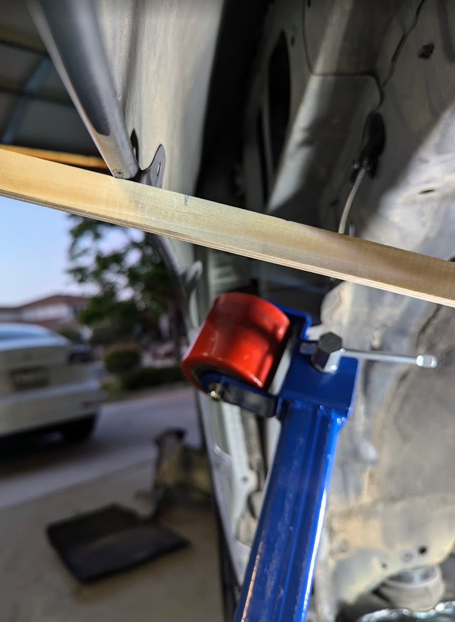

I like this game. Just keep chopping back until tires clear. How to do it cleanly is a bit trickier and I'll have to accept that things won't fit as cleanly as 35s did.
Here's chopping the rear bumper cover. Bonding back the cut part with Sikaflex 221 to the skin, to keep some structure for the mud flap to mount to.
Still thinking through the front tupperwear. Might need a viper cut but I wasn't ready to go that aggressive yet. Or just cut the whole arch 1" back. Hrmmm...

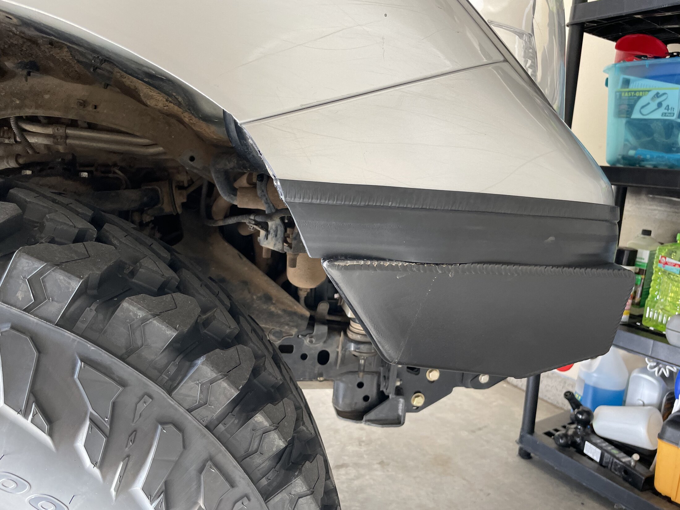

Yes, we did. The front was much easier than the rear because of the bracketry and bracing for the rear.
This was after cutting the front, before doing more trimming at the top to to make it fit perfectly.
And we have since done the additional return behind the edge of the plastic bumper with an epoxied piece of the same material cutoff from elsewhere. This trim left without that return and bolt through the back allowed it to pop out while on the Highway. Now it is secure 👌🏼
This was after cutting the front, before doing more trimming at the top to to make it fit perfectly.View attachment 3706451

This is what we used.
It’s not the perfect height. We had to cut it down and I cut it down even further from what you see there.
