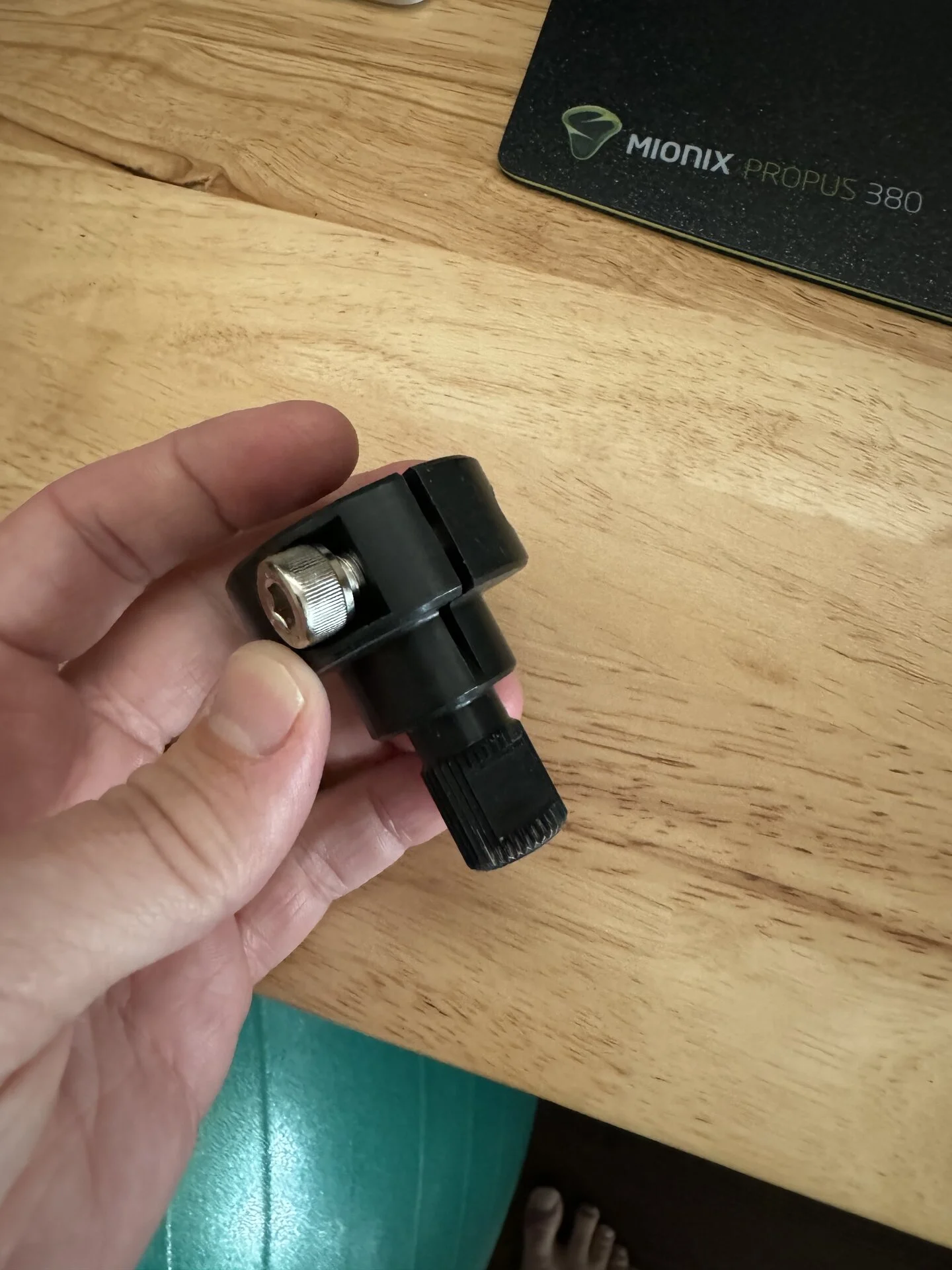

This one has the machined flat for the factory bolt and then another bolt to tighten it up. I think it would be safe?

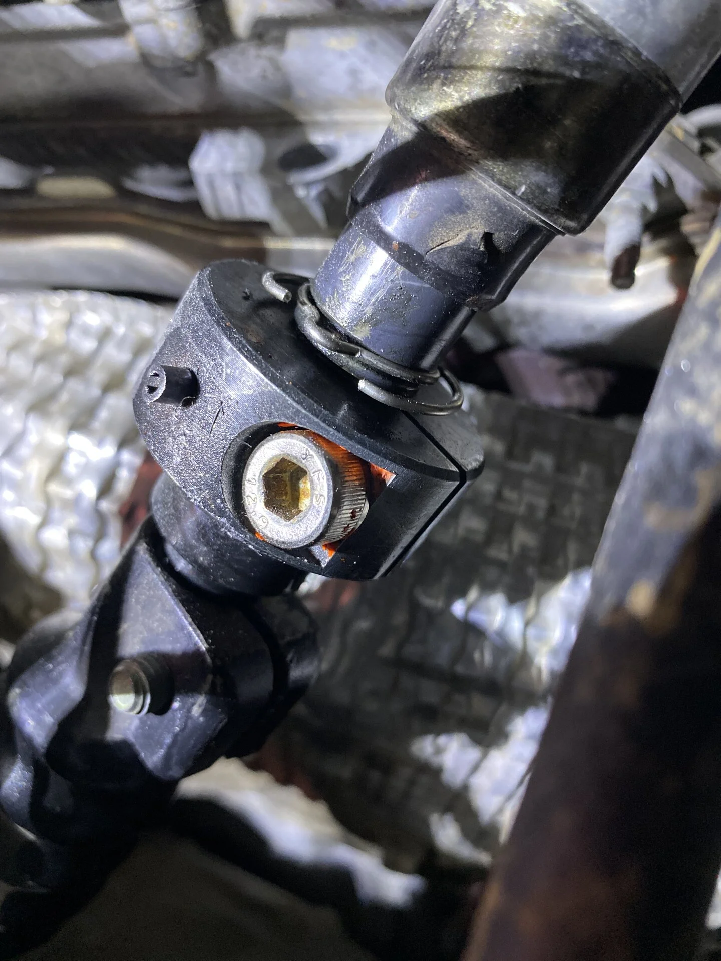

Hopefully @Rusty Hinge chimes in, but I will share his comment that “the shaft extension itself will not close and does not interface with the steering shaft the same as OEM.” He almost had the shaft slip out of the extension, as I understand it.
This was his solution…
Nice work on the mention Tiny.
I found that piece to have a less than confidence inspiring fit to the OEM upper steering shaft. I did end up tossing the part in the drill press and using a roll pin to secure it fully.
I am a firm believer that there should as close to a 0% chance of failure with safety items. Steer, stop and start.
After a bit of partying on the Arizona backroads with the LX, I surely did notice that the yoke slipped out of the coupler and *nearly* made a great time turn into a rather unruly sideways situation.
After limping it back to Texas and noticing it’s movement even on the less than smooth I-10 freeway pit stops, my solution was a roll pin that went nearly all the way through.
Please practice your attention to detail on items like this. I may only have a dog at risk with my adventures but if you have family, do it for them. Take the time to do this with patience and use my unfavorable experience as an avoidable lesson.
I have since tested this, no degradation, full movement, better steering feel, and it has been as close to OEM as possible with my limited brain capacity. 🦧
