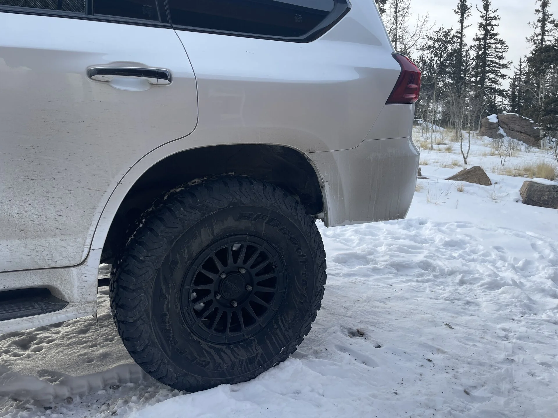

My current 37" KO2's fit with 2.5* caster, a sensor lift, 4 upgraded bump stops, rear mud flaps intact, and occasional kisses to the sway bar at full lock. I know they are closer to a real 36" tire.
I've thought about trying out 39" KO2's and it's obviously an even more slippery slope. One of my cam bolts in my LCA in seized so while I can get 3.9* caster on one side, I can't on the other without spending about $1k for new LCA and all. Things to consider and address before anyone takes the plunge and ends up having to spend way more money or time to get it to work.
Also I know quite a few are re-geared, but be ready for a much slower top end. When I went from my 315/70 65.5lbs to the 37x12.50 64.8lbs I didn't notice at all on the bottom end with my 8 speed, but man did it suck the power on the top end. Here is a couple pics of over a year ago when someone hit me and I had a free shot to cut the other QP and bumper to see what it looked like with the free high clearance look.

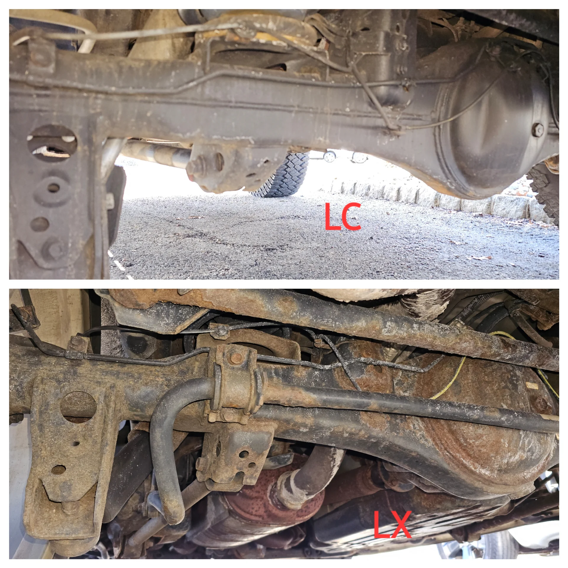

not sure how that would work since the links are inbound of the axle as opposed to the lx570 swaybar link mounts
kdss would have to be fully deleted and some sway bar mounted in the front.. I guess tundra but Dunno...
anyway I'm sure there is a solution with enough $ - there is for everything.
Dobinsons makes non KDSS sway bars. Mounts same way as the LX. Both axles have the provisions to mount the sway bar.
of course it'll fit non kdss land cruisers....they share the same axle housing as US lx570
I'm not sure what you're talking about. the rear sway bars mount at totally different points.
Yea my mistake. I had it backwards. LX can run non KDSS swaybars because LX and non KDSS have same axle housing.

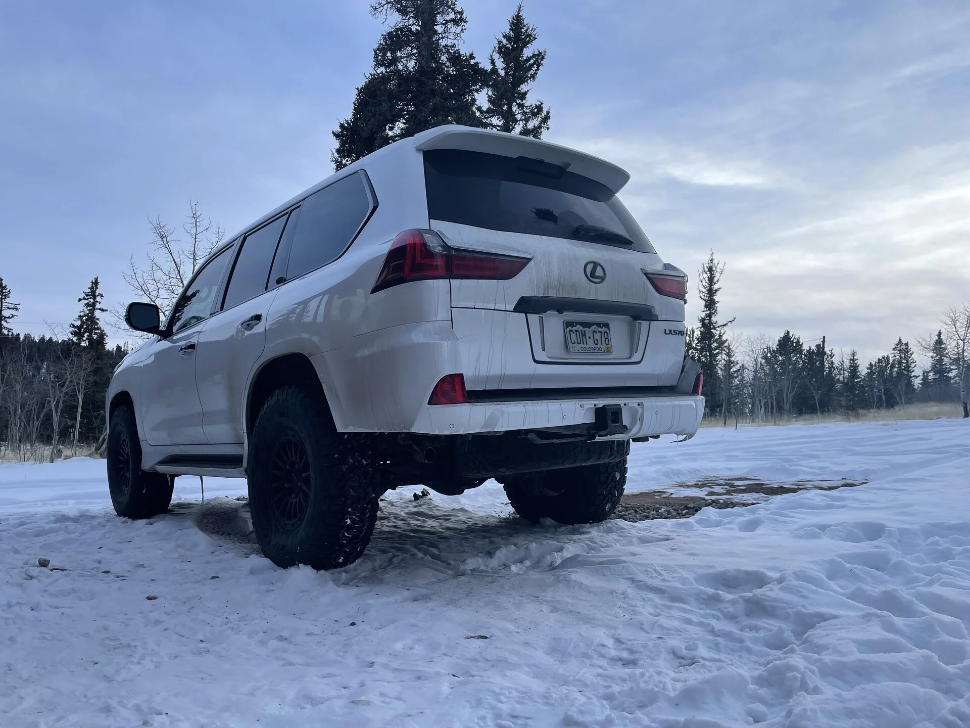

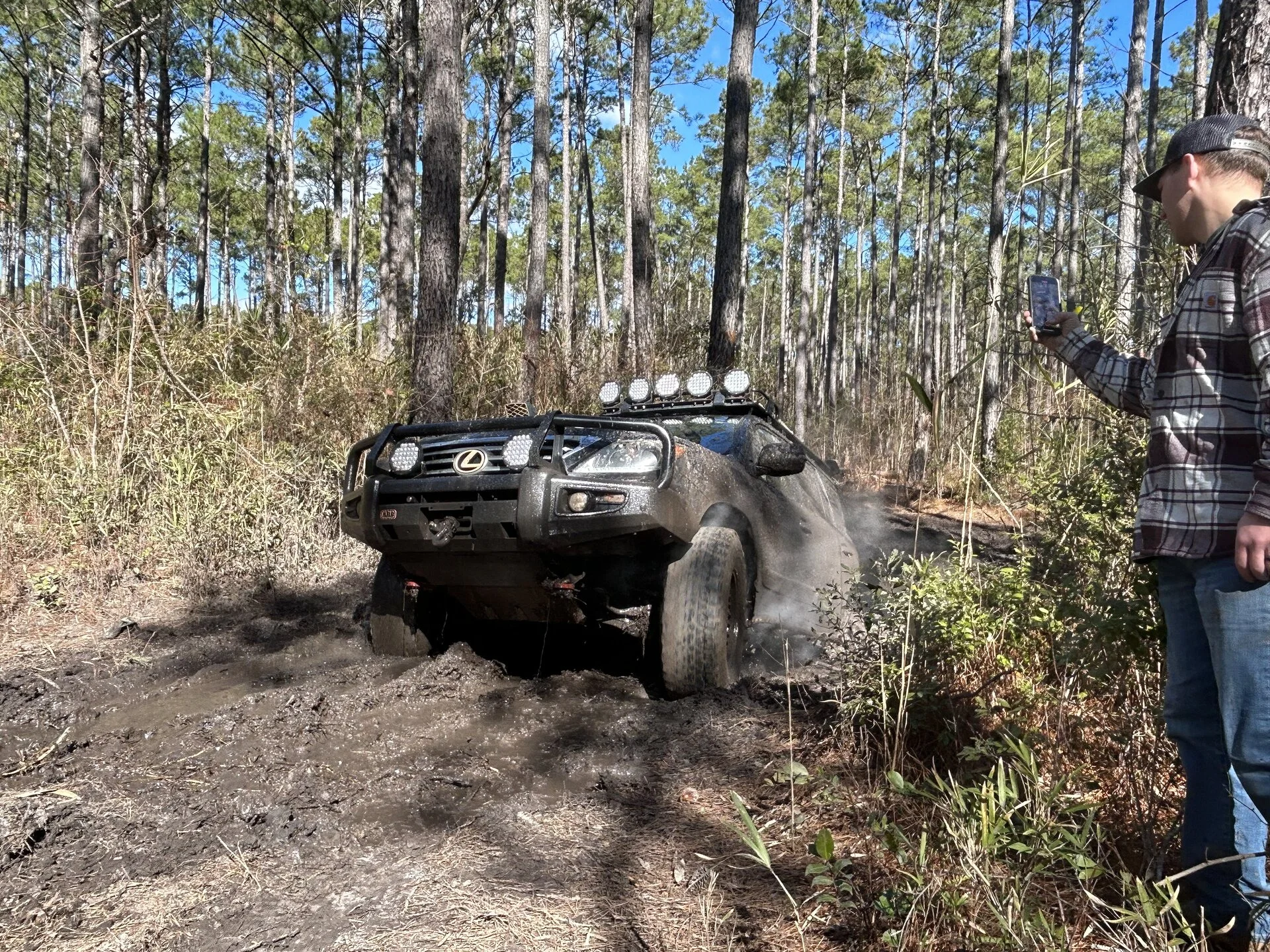

I run 37s on mine. Have for 2 years. Have wheel spacers, 2.5 OME lift, had to trim the front body mounts. They work great though. At full lock and fully compressed the outer lugs of the tires will still slightly rub the front body mounts, but not enough to matter.
There is one spot about an inch square where the rears will run fully compressed

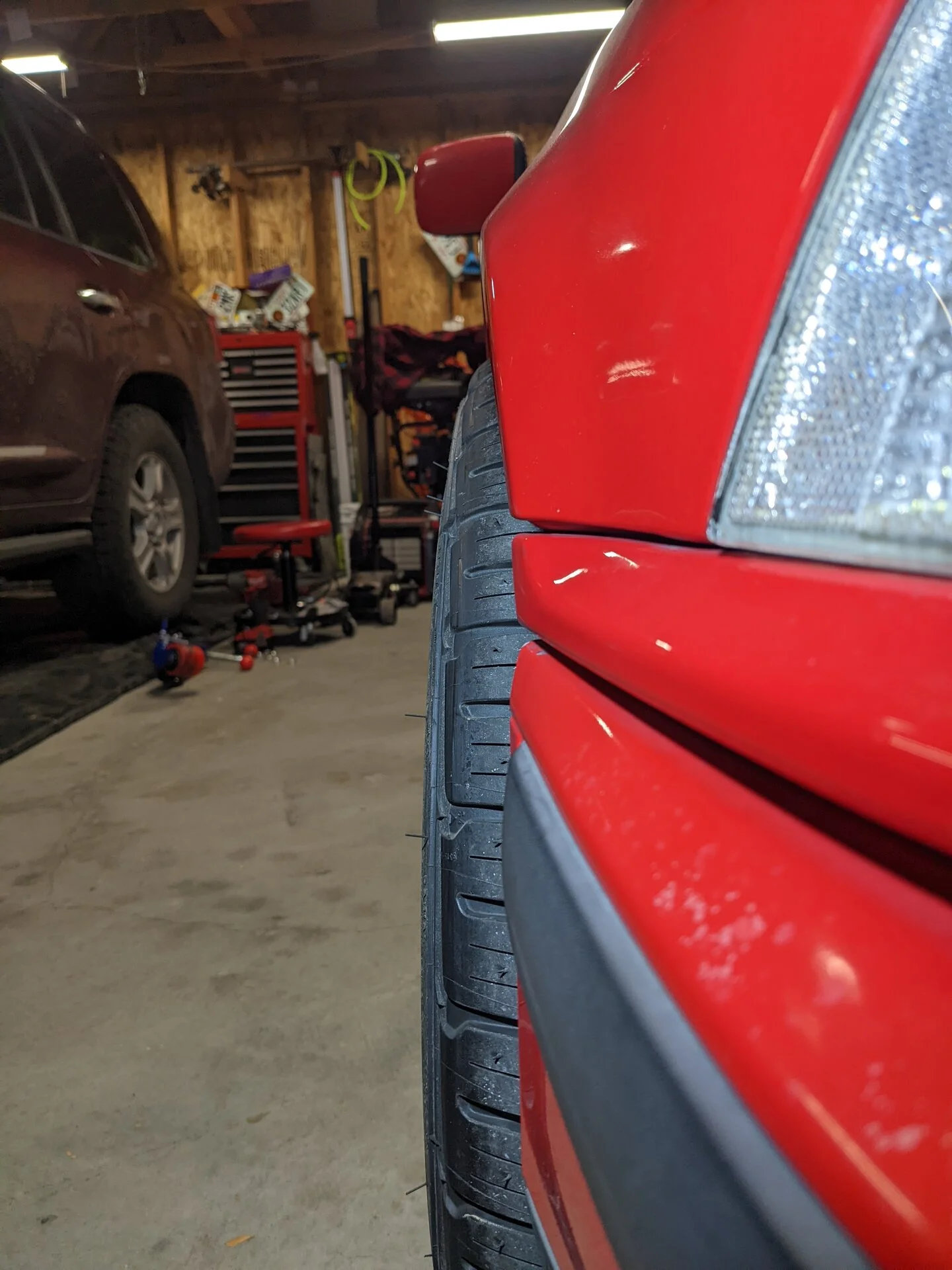

Rolling fenders is really pretty easy, the real hurdle here is probably gonna be getting a fender rolling tool to actually reach from the hub to the fender. I have a couple ideas on how to make it work, but my LX is gone until about Tuesday.

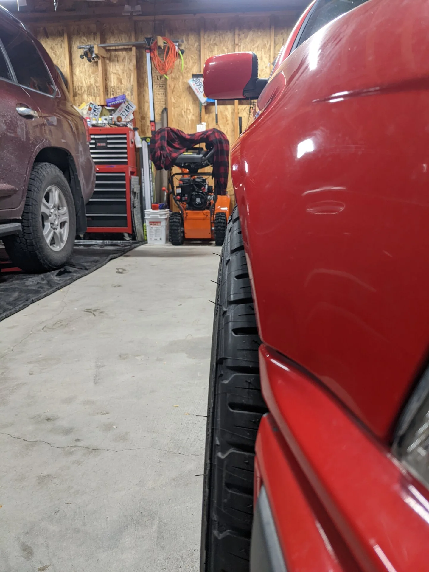

Bit of before and after of a roll and pull I did on my E36:

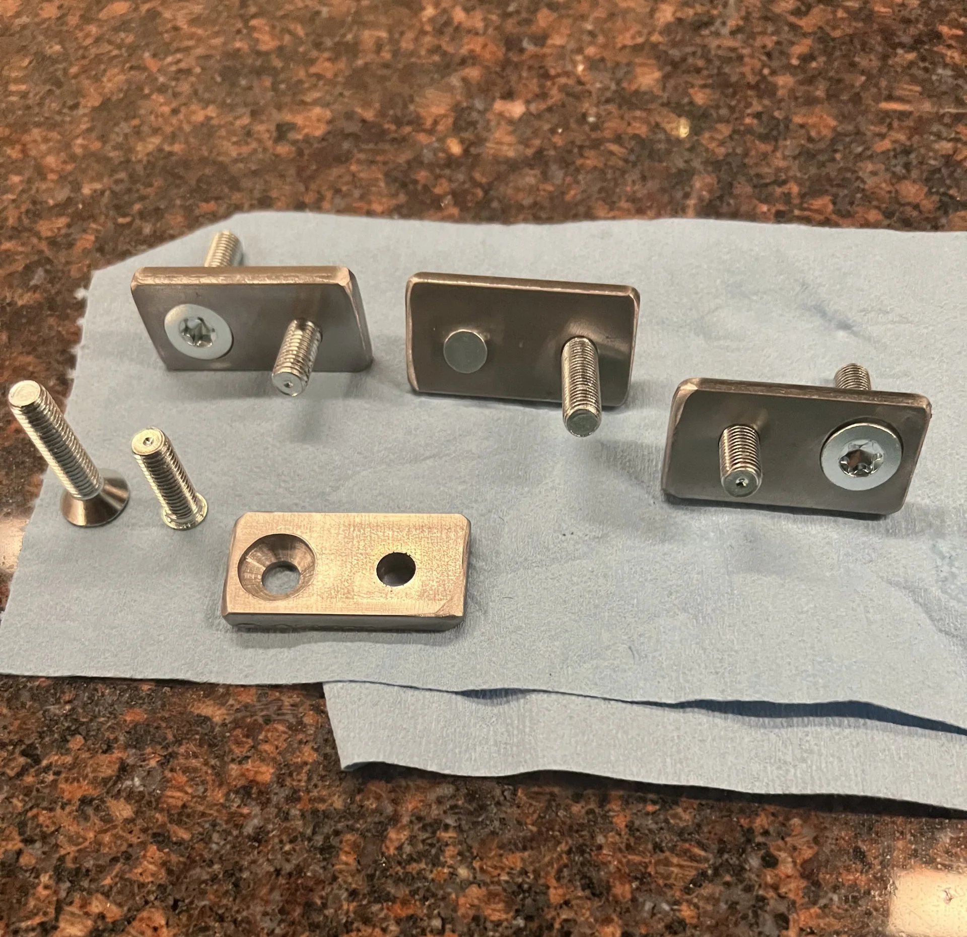

I’d like to get some ideas on the radiator drop bracket. I have something pictured in my mind, machined in one piece from aluminum, and using additional nuts and bolts to the body, but there’s a lot smarter people on here than me.
Here is @nwfl4runner ‘s simple solution…
Is there any reason to do this any differently? I was picturing an aluminum block machined down to have the post threads already on it, then the nut and bolt still being used, but I often overcomplicate things.
I have some bulk UHMW round stock getting machined down this week to start some testing with just 3/4” blocks. Then we’ll cut some 1” next week.
Just trying to keep things simple and help get some more people a little more clearance to have fun with a tire size they might not have previously. Admittedly, us LX guys will have it easier w/o KDSS. I don’t plan to have any solution to alleviate that possible interference (edit: maybe there is a simple swaybar solution we could also provide. Feel free to give input on that)
Yes it's very possible to roll the fenders for more clearance on low offset wheel. Doesn't provide much more upward clearance if the tire sidewalls fit.
Couple challenges.
The front is very possible to roll. The rears are thick double stacked sheet metal so take a lot more force to roll. Possibly need to cut if rolling beyond the pinch weld.
The rolling tools also don't generally have the extension necessary for how much travel we have. AHC helps to lower to axle to the body. Or just lift that corner. Or custom mod the rolling tool.
