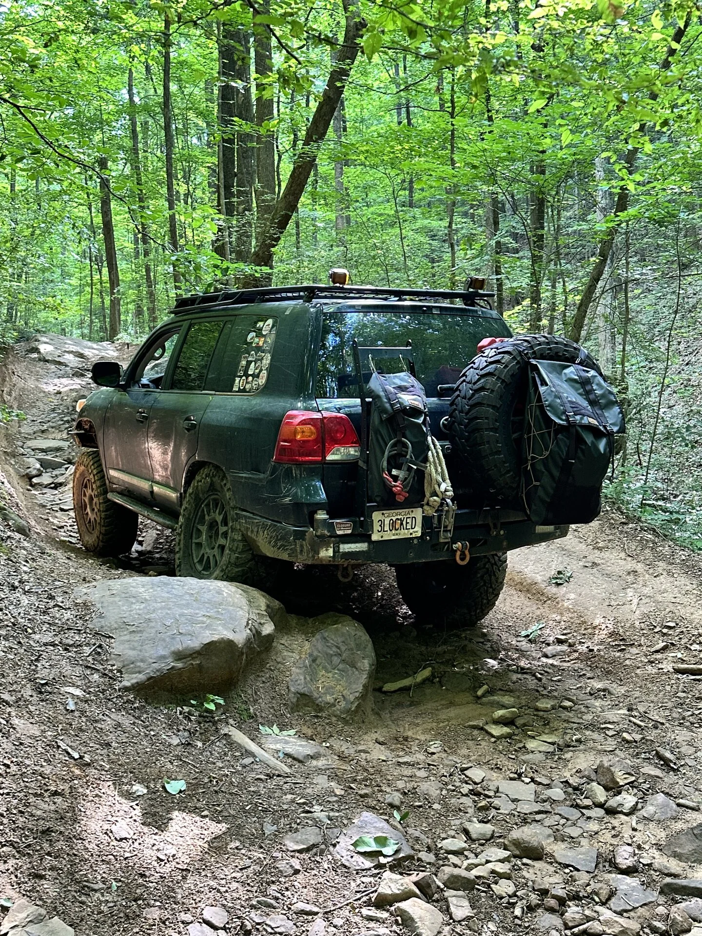

Late to the party but thought I would list my setup to run 37x13.50 on 2013 TLC
Front
  • Front fenders cut
  • Fairly extreme BMC
  • Tundra arms
  • Tundra King 2.5 front
  • Camburg 1.5 uni tundra arms
  • +45 evos (had to add 3/4” spacer to the front to clear uniball cups)
  • 5/8” bump spacers up front
  • ^^^OEM coil over spacers to get some of that back
  • KDSS delete
  • Fender liner removal
  • RCV axles
  • Extended brake lines
  • Superpro Poly LCA bushings
Rear
  • 2” extended rod ends on Kings
  • Cut and rewelded lower shock mounts by 2”
  • ~2” bump extension
  • 1 1/4” wheel spacer to get close to front track
  • Cutting on the ole Slee rear bumper
  • Liberal use of BFH in wheel well
  • KDSS delete
Notes
  • The suspension is fully functional with no rub fully stuffed lock to lock.
  • I have the front spaced just right to where driver tire has about enough clearance for a sheet of paper on the washer reservoir ( added one fender washer under the bump extension on driver side to achieve this.
  • Because of the extreme droop from the tundra arms/shocks and oem spacer I was breaking OEM CV on every run. Finally moved to RCV and that solved the issue
  • I have no issues without KDSS or anti sway bars. I’m glad it’s gone to be honest. Makes working on the truck much easier.

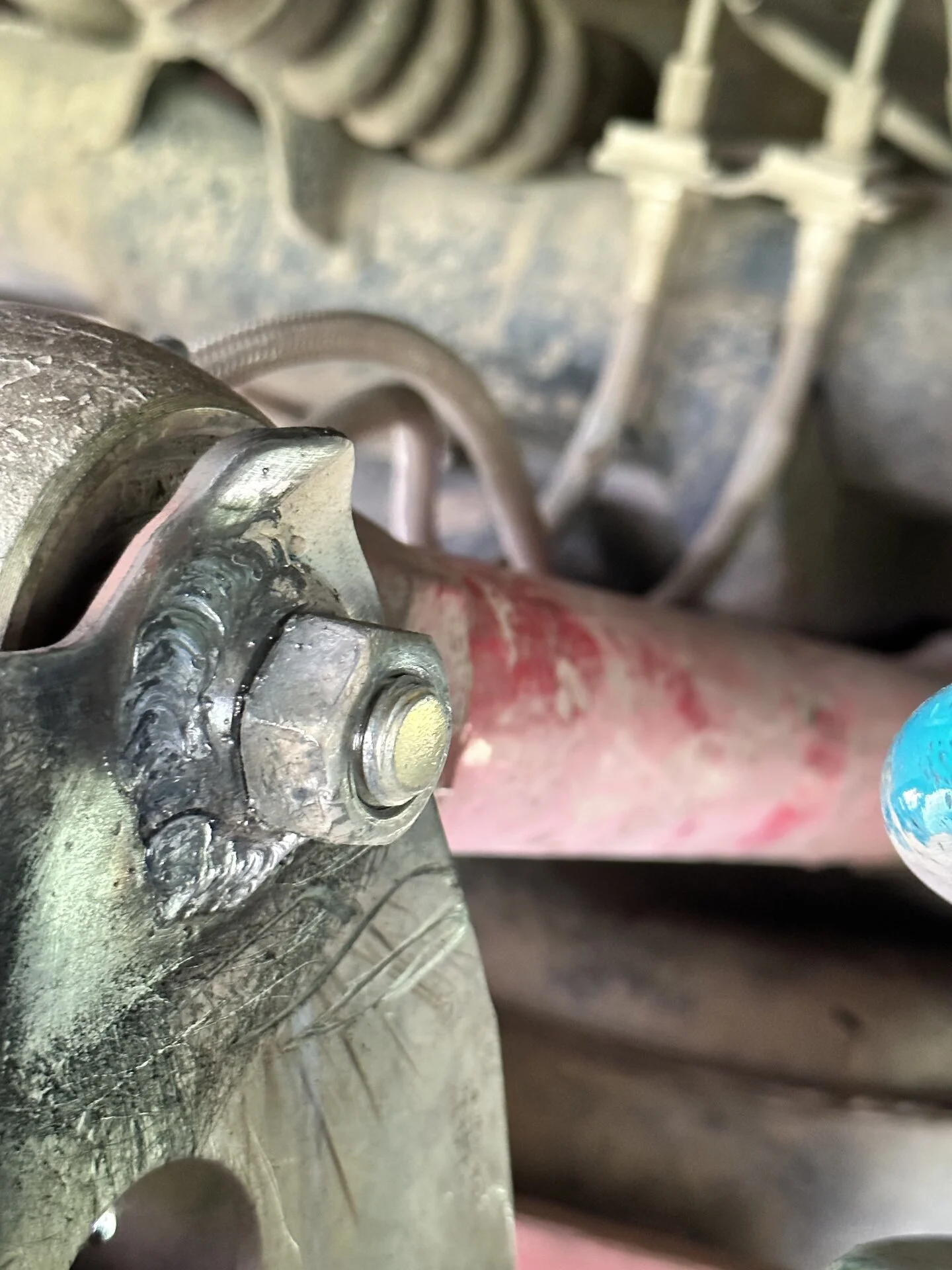

  • Early on I was getting rub up front in certain scenarios. Finally figured out is was bushing deflection. Replaced LCA bushings with Superpro Poly and problem solved. (AAMOF I don’t have a single rubber bushing on the truck now, everything is either heim, JJ, or Poly. Including the track bar(heim). Truck is tight as a tick now.

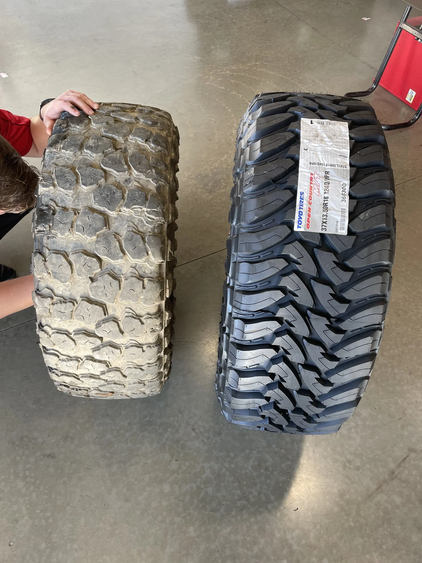

  • 37x13.50 Toyo MTs are HUGE. (Compare to 35x12.50 Yokohoma XMT in photo):steer:

It is. It will eat and eat. Just know that if you wheel 37s hard like I do you better bring all your tools. Including a welder 😬

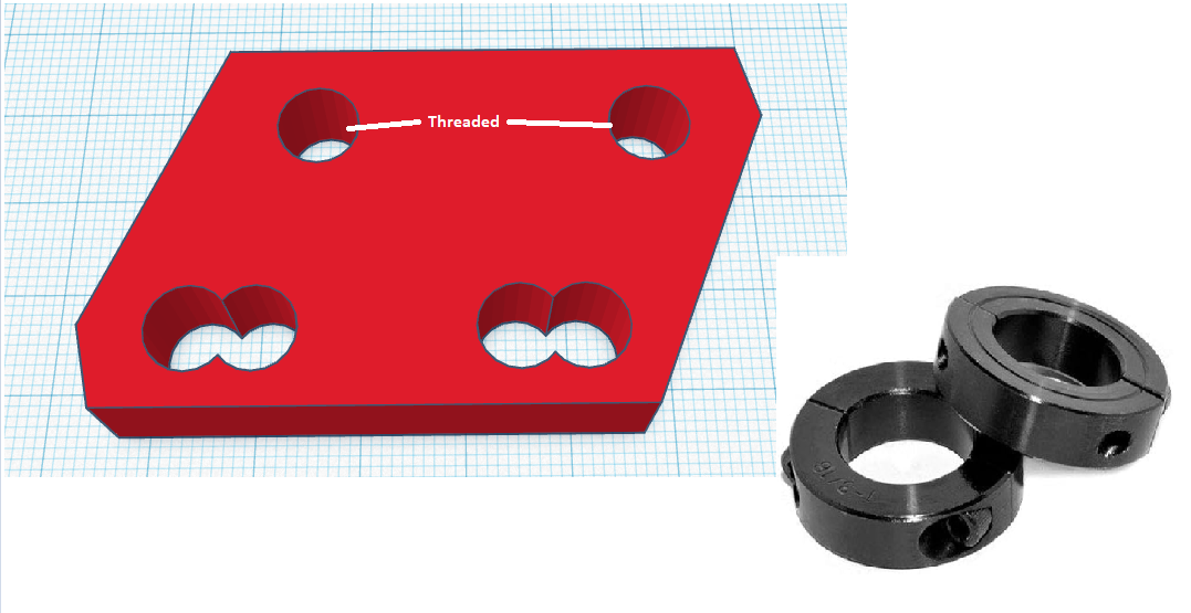

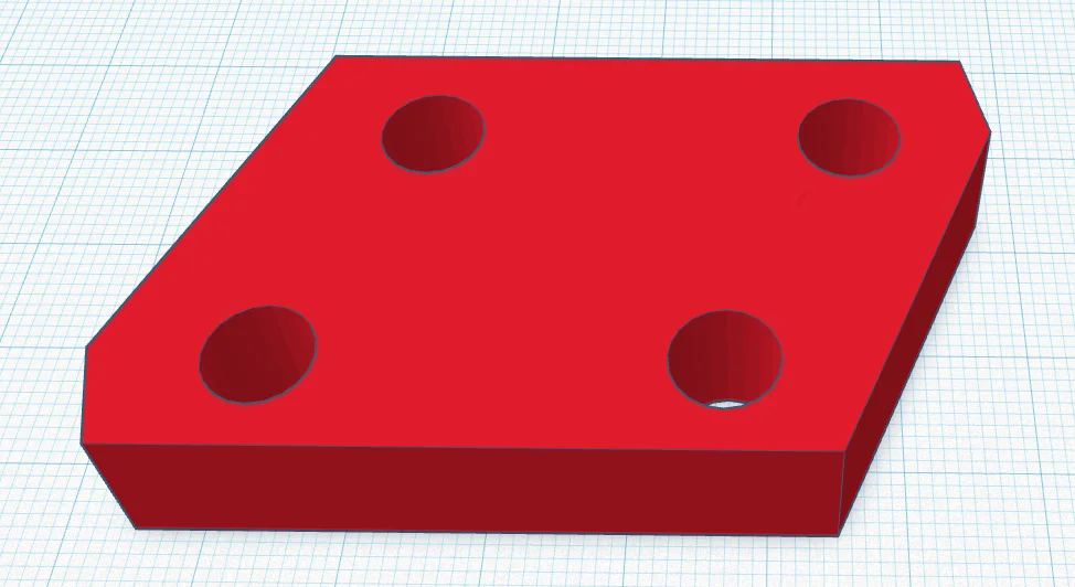

Might as well share here. I've been tossing around the idea of offset sway bar relocation bracket. I imagine this could work for KDSS or AHC as the frame mount interfaces are the same? This is notional without dimensions.
Goal is multifold
- Relocate sway bar forward to gain tire clearance (I'm also secretly thinking to push lower control arm forward for BMC clearance and caster)
- Space sway bar down for better droop travel
- Reduce sway bar spring rate for better articulation without removing sway bars completely for highway handling and safety

Could we create one part that combines both @TeCKis300 inboard move and @linuxgod ’s ideas or other shared features? If we could collaborate on one design for both LX & LC, it would certainly simplify things.
Does anyone see an issue moving mounting points inward a little on KDSS? Is 10-15mm thickness a good starting point? 1/2” offset forward?
I think that's very possible. Could slot or provide two different mounting positions on the frame bolt holes to allow some adjustability forward/aft.

Maturing this thing
- Two sets of mounting holes. One for minor locating forward while keeping the sway link in the LCA bucket. Another set further forward for outside the LCA bucket. A slot would be questionable whether it'll allow slip over time, so the somewhat overlapping holes will key it in position better. Or completely separate holes if the KDSS bar needs to be located that far forward?
- Thread the other holes for the relocated sway bar bracket, avoiding nuts the backside to interfere with the chassis rail
- Needs clamps to make sure the sway bar doesn't move side to side
That said I’m having trouble visualizing how moving anything inward helps (or even happens) as the KDSS arm mounts to both the sway bar and the LCA
It incrementally changes the motion ratio, frame relative to wheel travel, on the sway bar. Also instead of wheel motion only translated to torsion on the middle section of the sway bar, added flex will take place on the now unsupported corner of the sway. Both things should reduce the overall spring rate of the bar. I wish I could say how much less rate, but this is more trial and error.
It all remains to be proven and I'm hesitant for anyone to produce this. It's easy enough to create as a one off to test prior to that.
KDSS sway bars already have locating rings on both sides of each bushing. Also at some point the arm/cylinder end of the front bar can see a bending movement as it curves forward to attach to the arm end.
Yes. But they have been known to slip in other models with KDSS when seeing more aggressive articulation. There's similar aftermarket rings to prevent that.
Ah ok I thought this was to help clearance, not flex. The thing is want to be careful of is that right now the relo kit sits between the bar and the frame. If you move the bar mount inward, it’s no longer pushing directly up against the frame. Instead you’ve created a lever and I’d be concerned about that plate flexing and eventually failing. I think it would need to be gussetted and have a perpendicular section that bolted into the side of the frame somehow.
One other thing.. from a past conversation with Taco, at some point of tire size and flex, even if you get the bar and arm out of the way, the tire starts to tear up the boot on the kdss cylinder leading to obvious problems keeping the area as clean as is needed for a hydraulic system. The cylinder does swing forward when the bar does, but only one end of it. So eventually there are diminishing returns on this particular clearance issue.
It can help with clearance and flex. Definitely a good point on the cantilevered offset, and this should be done as a minor tailoring rather than a gross adjustment. The aluminum block should be thick with enough structure to handle the offset. Perhaps it should be steel to minimize potential for fatigue failures especially with KDSS. AHC setups will see less stress on this part than the beefier KDSS bar so maybe they should be separate applications.
At more extreme modifications, it's my opinion that KDSS has less value, and perhaps should be deleted. Not only clearance. But there are off-road performance reasons including better corrugation and medium bump compliance where the system doesn't unlock and upsets the chassis. Most LCs at the level of modification also run higher spring rates which itself will contribute to roll management. I think a tender LX570 sway added to the front will do nicely to compliment this type of setup. Question has always been what to do with the rear. I've been running around this past week with my rear sway bar disengaged (broken link, my fault). While it's not terrible and still towed great, when off-road, the rear axle already does more of its share to articulation. Having a rear bar does balance out the articulation at the front to keep tires down, and keeping the rig more level overall. Perhaps the rear KDSS sway bar can be retrofitted with a locked out static link in place of the cylinder, but also with some geometry adjustments to make the bar tender enough. Then again, welding on a driver side bracket to access the LX570 rear bar isn't that hard. We're already welding on panhard correction brackets.
Agreed there’s definitely a blurry line where it’s advantageous to ditch KDSS in favor of LX bar/bars, but if possible to keep it we might as well. Even if it’s not perfect the combination of articulation and road manners in a passive system that is generally low maintenance and quite reliable is.. great.
I was just pointing out yet another not often discussed consideration if it will be kept.
Honestly I'd be happy with a heavy sway bar and an electronic sway bar disconnect switch. I mean it's slightly convenient to not need to engage/disengage but I doubt I really need KDSS unless I'm going offroad at which point I'm pushing all sorts of other buttons anyway.
