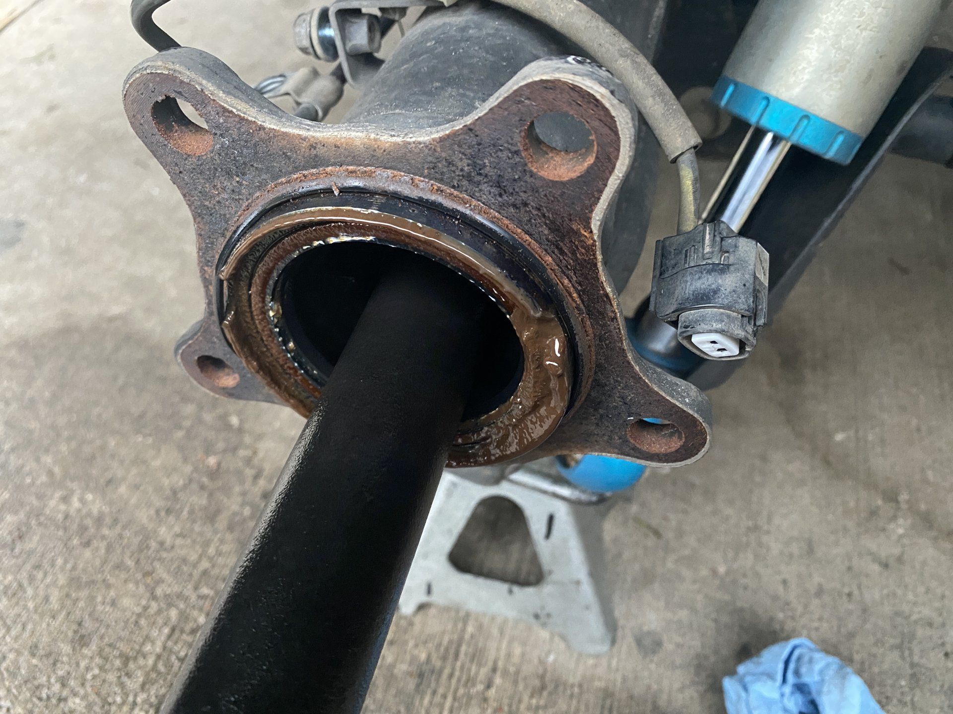

I agree with what @bloc said about the bearing requiring the support from the shaft engagement into the diff - it's not like a unit bearing on the front (unit bearings have 2 bearings and are designed for those forces). If I'm not mistaken, the rear bearing is just that - a single bearing with no means for torsional(?) support. You could probably make it a few miles to get off the trail with the shaft cut off, but you're definitely not making it from Moab to GA.

Not trying to argue. I was just curious what your experience had been with it. Saying i could drive from Moab back to Ga was a bit of hyperbole (although I would not hesitate to do it if no other option existed) but I do think i could’ve gotten from Moab to SLC no problem. I drove it off the trail and then from the Spanish Arena to the airport about 20-30 miles. The entire time it felt like someone was beating the bottom of the truck with a gigantic hammer because of the unsupported axle flailing around.
When the axle was pulled again the bearing was still tight as a tick.
I just think that sometimes we don’t give these trucks credit for how strong they are. Even when outside of design parameters.
And next time I’ll be ready to at least cut the shaft off so it’s not banging around. I honestly think it will get me to the closest/best shop to do the work. Or if I’m on the east coast home to do it myself 👍
Point taken about hyperbole. I was picturing a lot of miles for something dramatic to happen, but you’re right that it would probably give plenty of warning.
It’s actually a two-row bearing but with much less spacing between the races than the front (which dramatically changes the forces each race sees) and only a slip collar to hold the inner races together vs the huge bolt on the front. If you want to see pictures check out the thread where I disassembled my failed rear bearing out of curiosity.
Yes. The bearings are VERY heavy duty. Interestingly enough I’ve had to replace both driver and passenger around the 160k mark. They failed within 7k miles of each other.
My truck shakes and rattles a lot, but like you said in your thread dead giveaway was ABS codes. That wouldn’t go away even after changing sensors from front to back. If that happens it’s usually the bearing. 👍

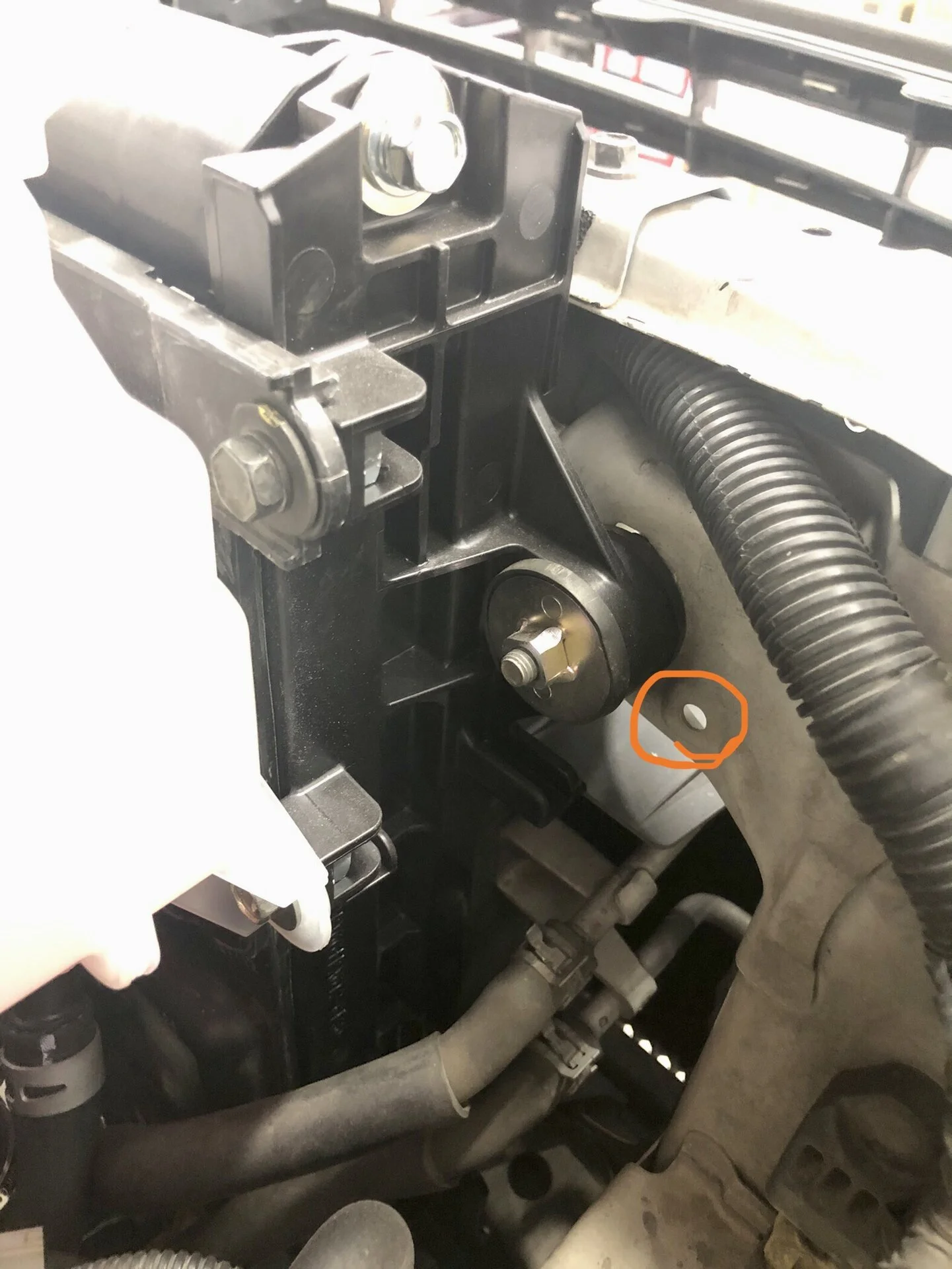

Can anyone see any problem (aside from a little reduced clearance to the fan for maintenance) to have the radiator drop brackets 3/8” thick?
If no one objects, that will be the thickness of the part.
Also, is this circled hole in use on anyone’s 200? We intend to use it.
Or does anyone not have that hole present?
I think 3/8 should fit once assembled - the only issue is it’s a tight fit on the lower 2 spacers. I know the radiator was hitting the fan as I tried to tighten the screws and my bracket was 1/4”
