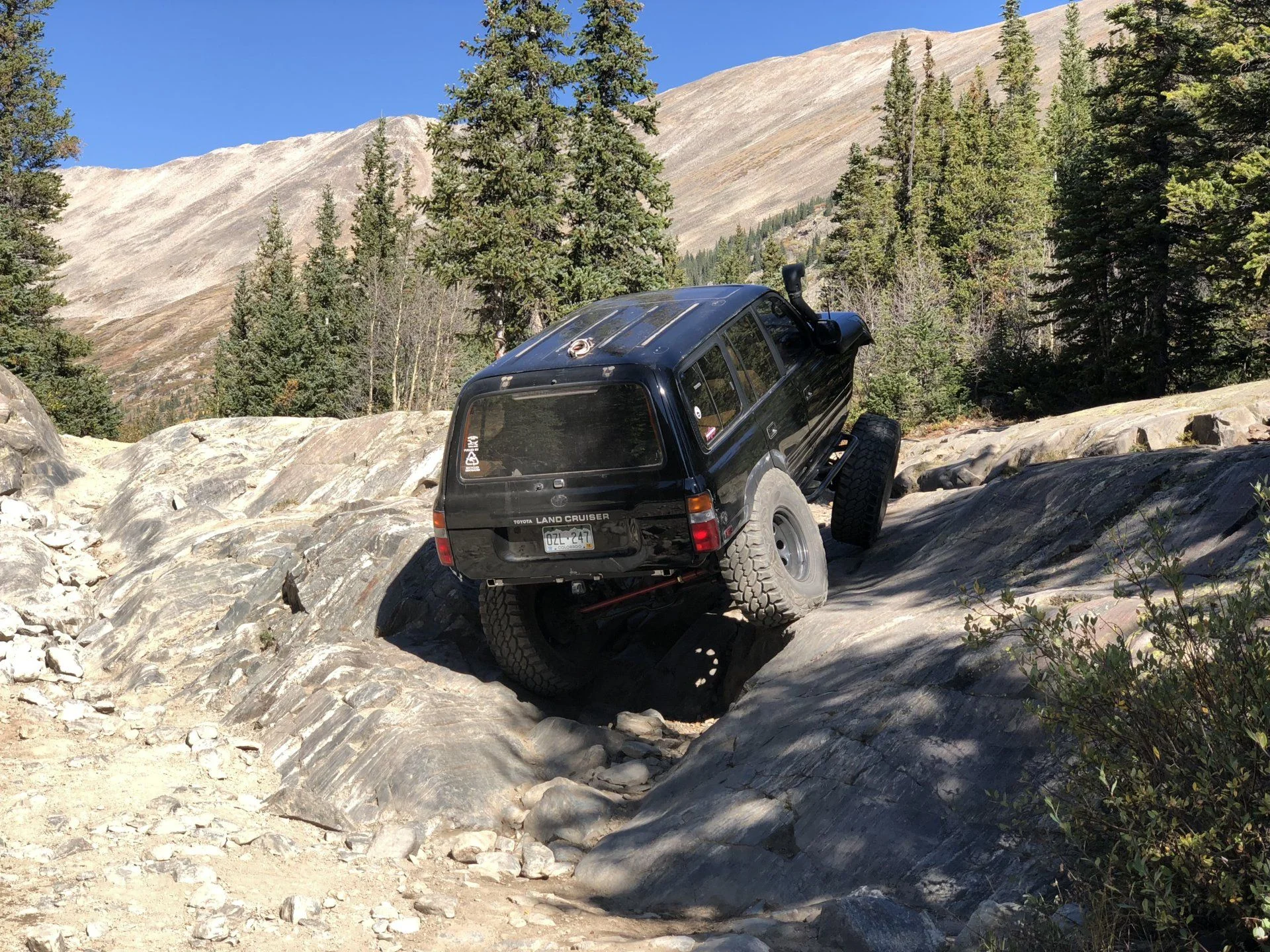

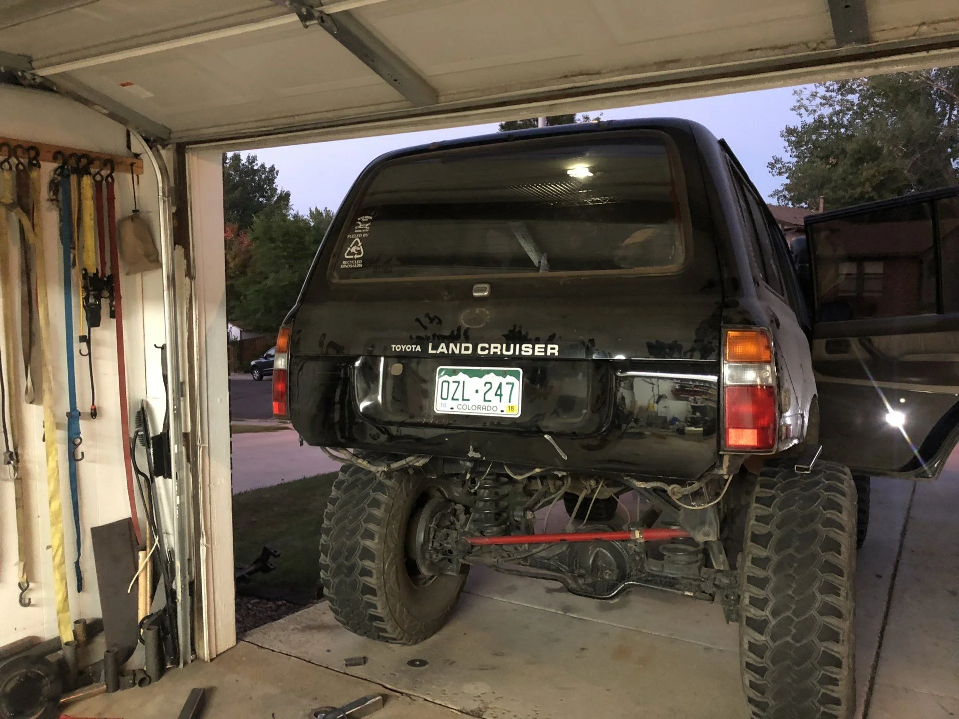

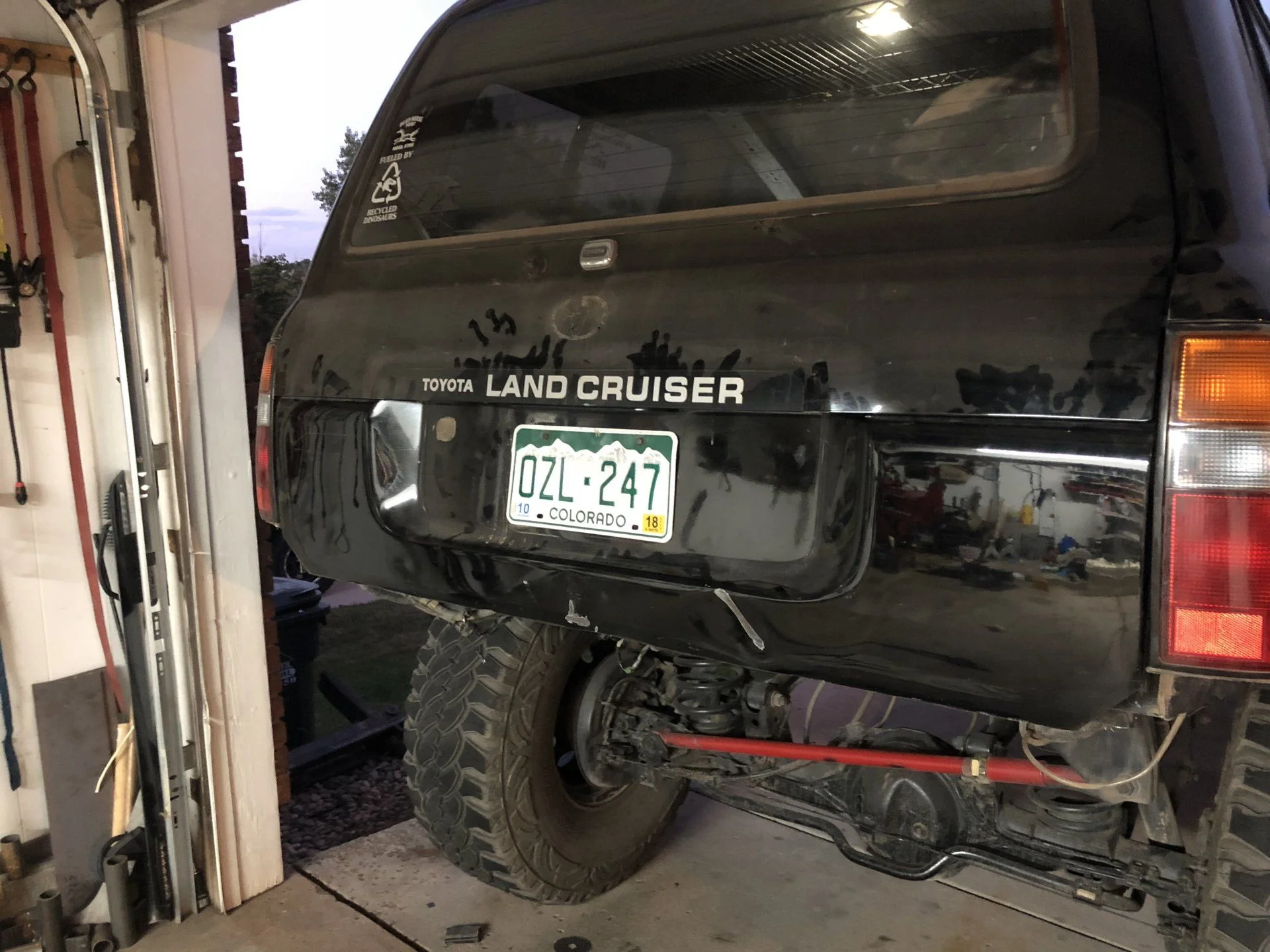

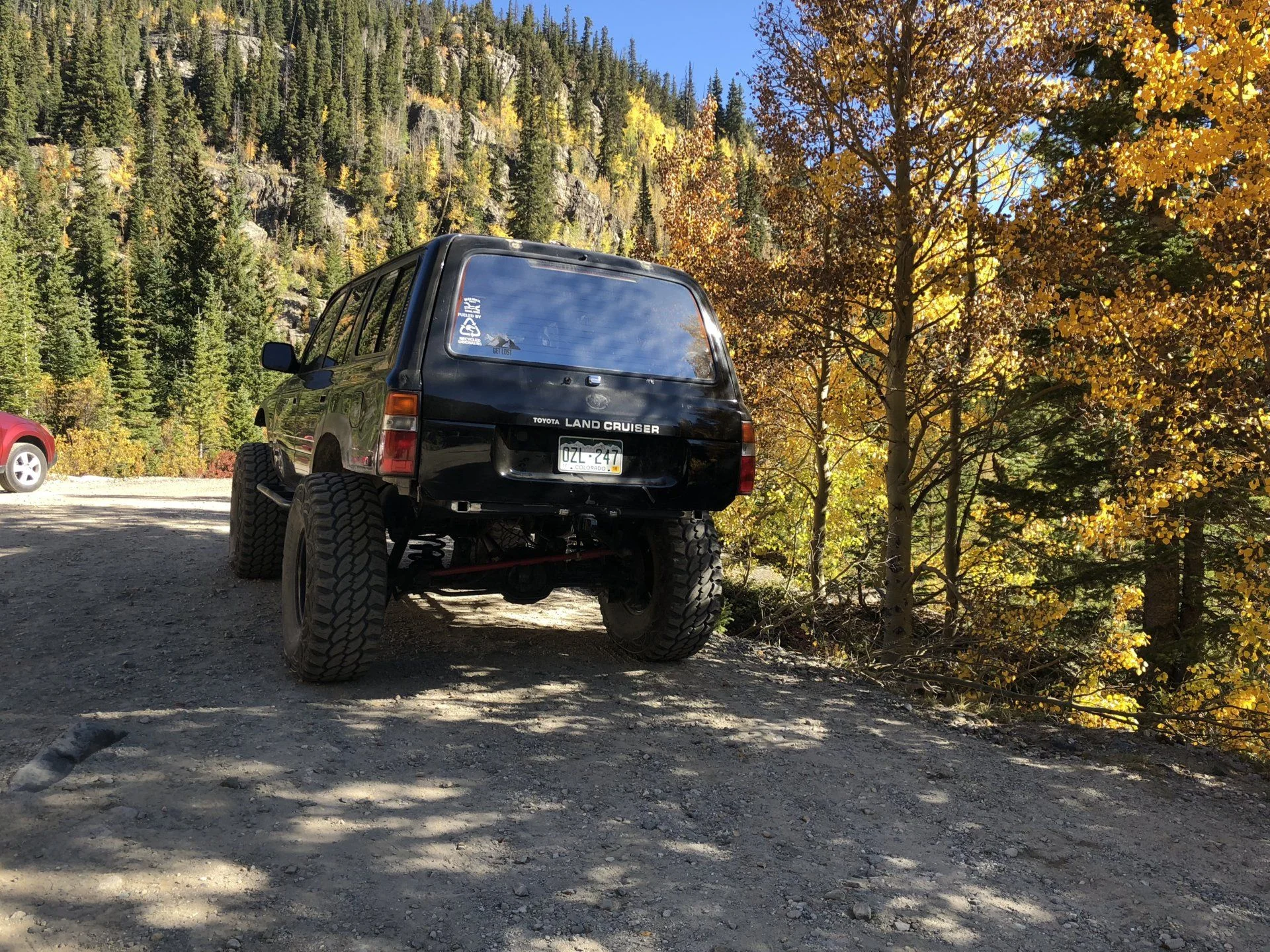

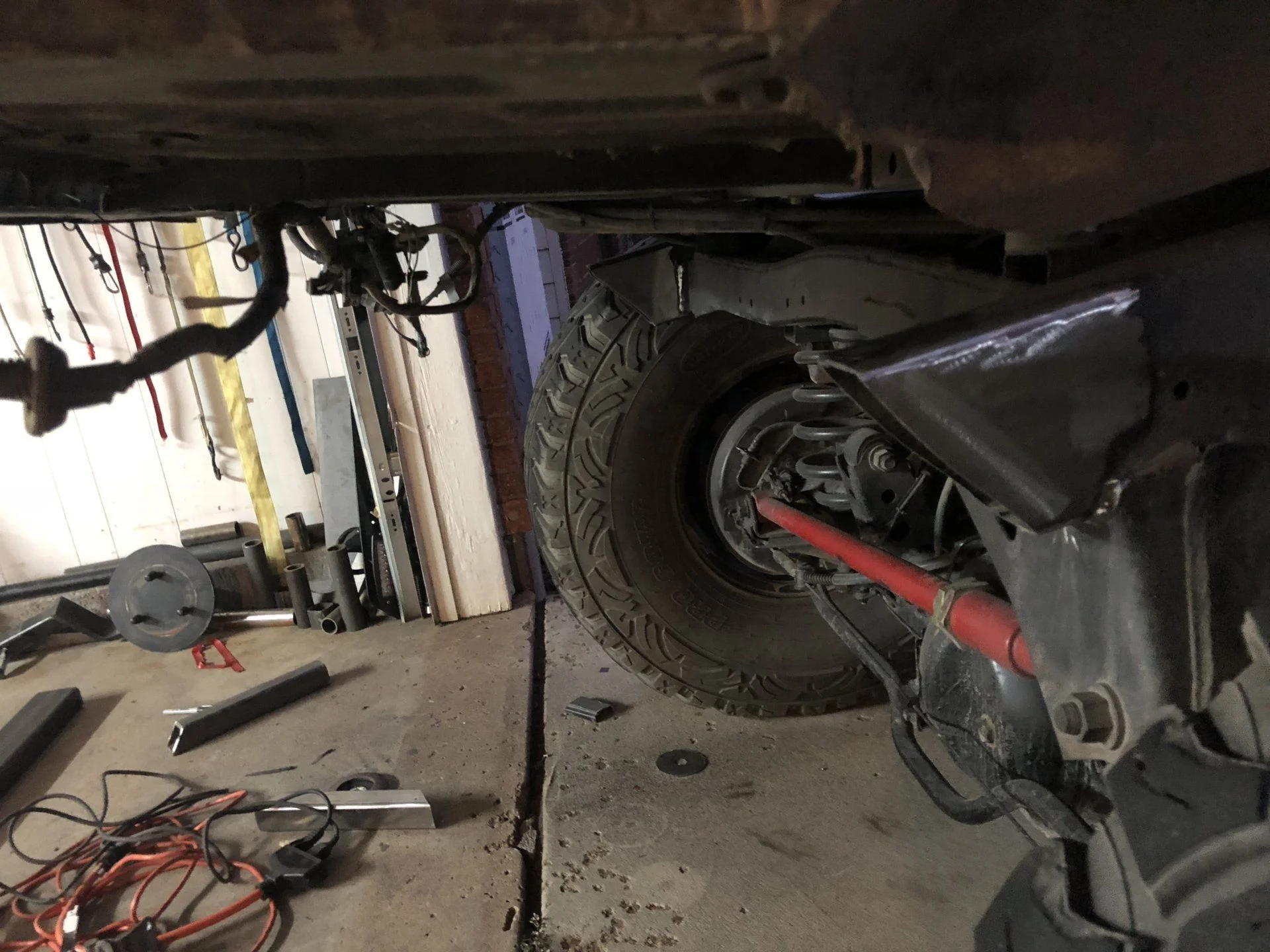

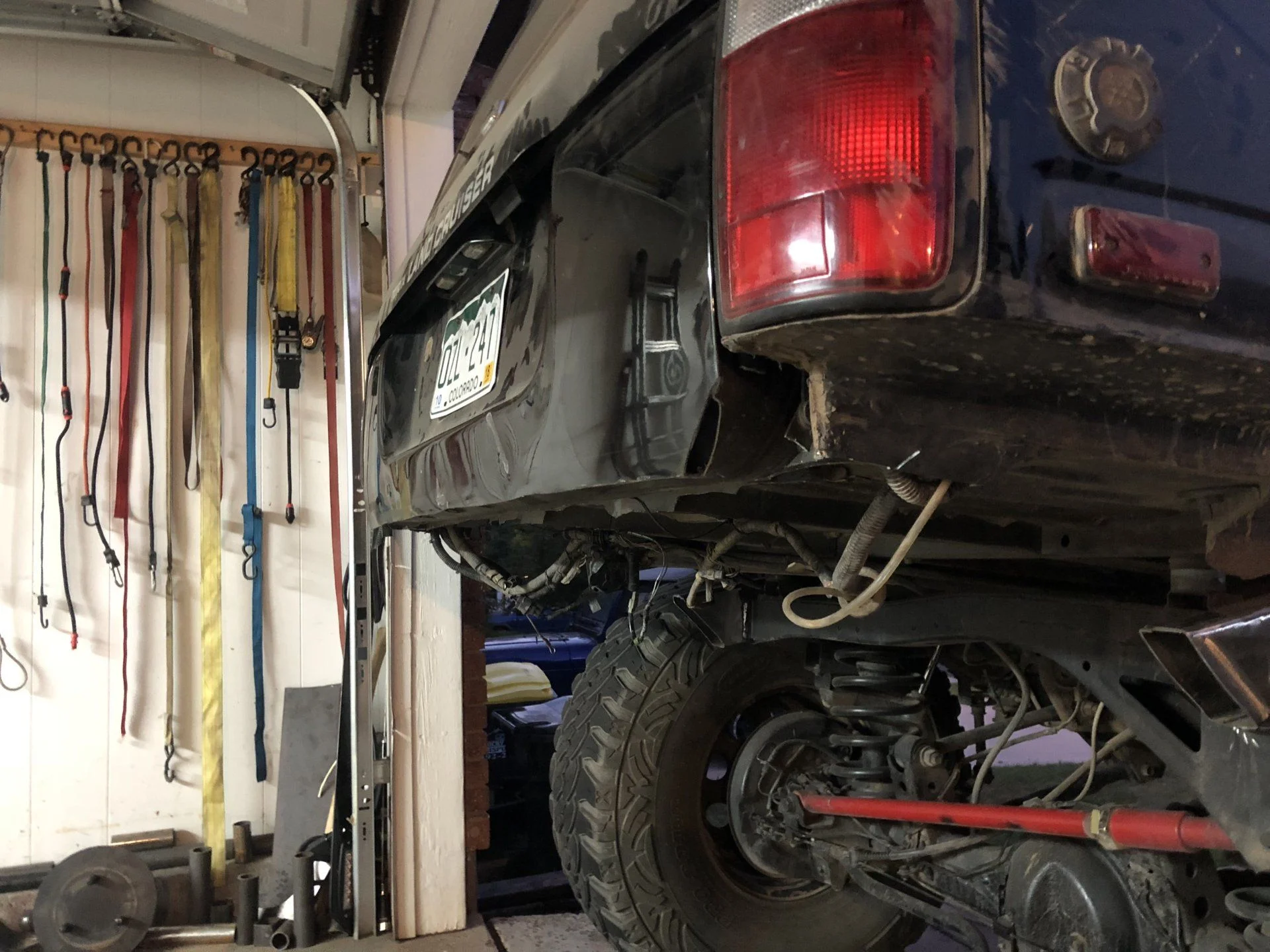

I have approached this departure issue on a different way by moving the rear axle close to 3” back. I had to reconstruct the rear passenger well to fit 42’s.
Looking forward for your next steps!
Did you run into any issues moving it that for back? I am going to eventually push mine back an 1” or 2” and cut out the wheel wells and tub so i can stuff the 40s at stock bump
Yes, a few issues:
- One of the cross members for the coils will be right on top of the axle, well in my case. I cut that thing off.
- Fuel pipe is also kind of the way in order to mount the shocks behind the axle. If you relocate this, then perfect for shocks
- there’s no room for vertical shocks. I ended going trough the tub in front of axle. While the cross member is gone, the shock towers itself made a little truss between the frame rails and the left over cross member piece.
- wheel wells are on the way as well, as we push the axle back the wells kind of tapers down. I had plan for 40’s and I think the best tire for an 80 but ended up with 42’s which they were 50% off. Pitbull didn’t have 40 and don’t like their 39.5”. Going back,
The well on the passenger side has to be redone as there’s no room for such a big tire.
Driver side will run against the filler neck.
- my rear axle is 64” wms and rubbed way too much while stuffed in, I added 2” spacers and it’s a lot better.
- I am suffering from too much body roll on the rear, I am in the processes of getting new stiffer coils, hopefully the rubbing will stop.
That’s all I can think of?
Here’s a few pics for reference
