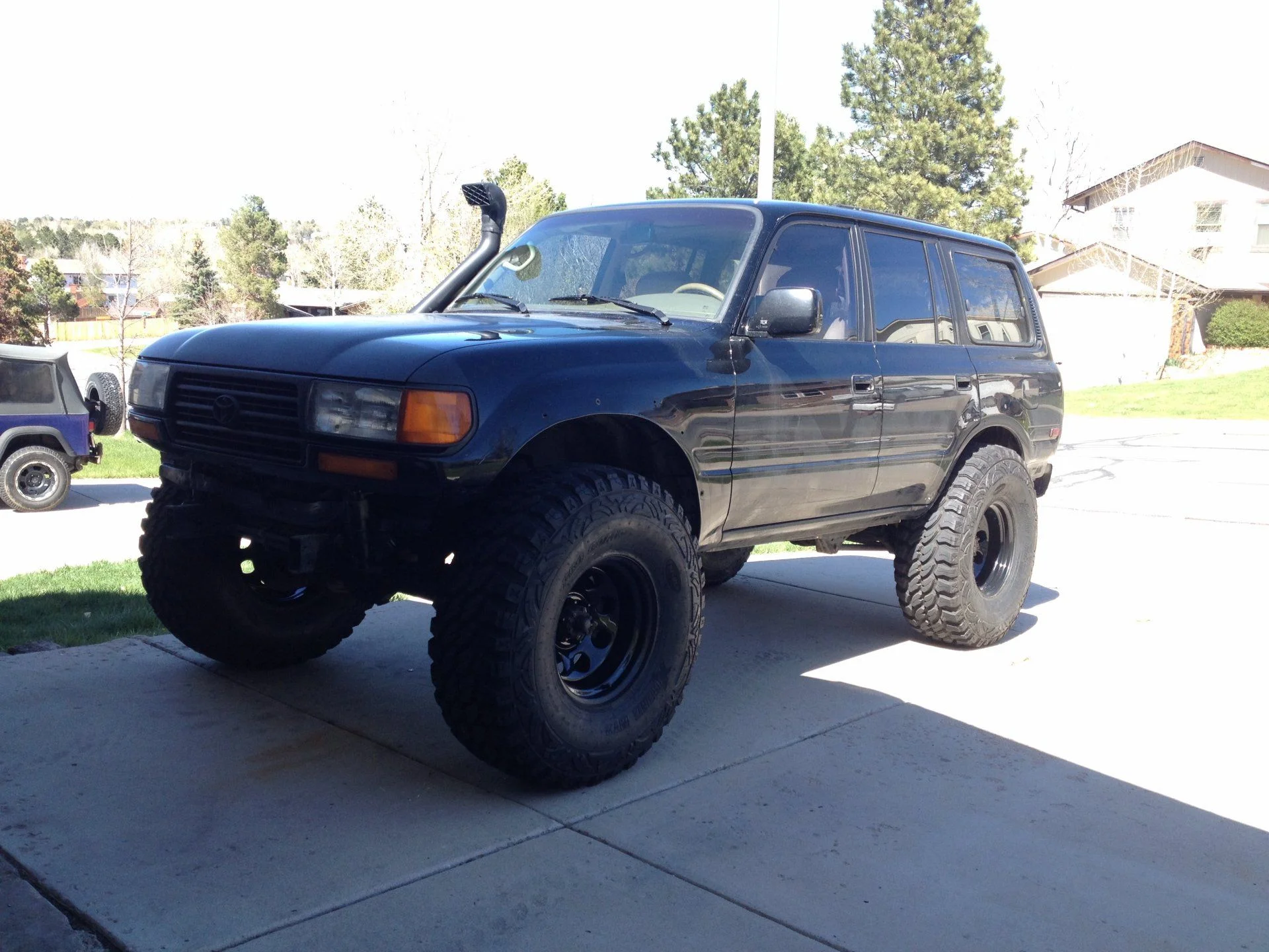

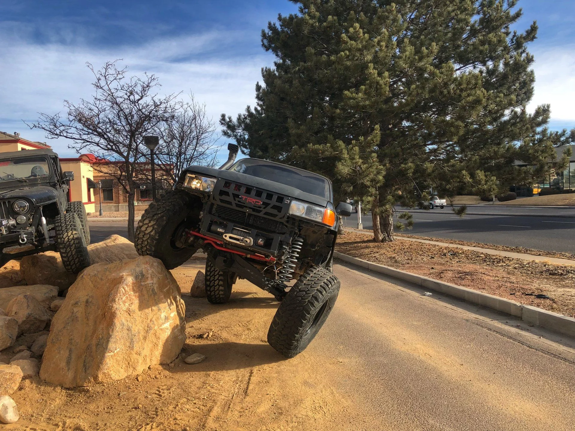

Hey everyone. I have been building my 1997 Land Cruiser for a few months now. It took a year of saving before this, and many hours of work in between high school classes. But ever since I saw @Apounder and his crazy truck I knew I wanted 40s. You can blame my dad for the love for Land Cruisers. :cheers:
This used to be my dads rig until he upgraded to a 3x locked 97 40th anniversary. I bought this truck from him about 7 months ago. Part of the deal was he would get to keep the bumper, sliders, winch, front springs, and a couple other odds and ends. All of that was fine with me, I had a different plan. Had 258,000 miles then, has 272k miles now.
This is a sneak peak of what this truck has evolved into. Still has a long way to go.
Current Mods Include (Pending):
Custom F/R bumpers
TG Sliders
Nitro 5.29s
ARB Lockers
TG Longfields
Trussed/gusseted front axle
3-link
Rocker chop
No Flares - Welded/Monstalined
13in Travel Pro Comp 9000 Shocks
1" BL
Dobinsons 4” flexi coils
Trail tailor adj. panards
1.75” Bumpstop extension Front, 2.75" Rear
40x13.5r17 Pro Comp mt2
17x9 3.5BS Pro Comp 97 Series Steel Wheels
1.25” wheel spacers
Upgraded Stereo w/ 10in sub
Built out interior w/ Bed, sink. etc.
LEDS throughout
China Snorkel
Hella Horns

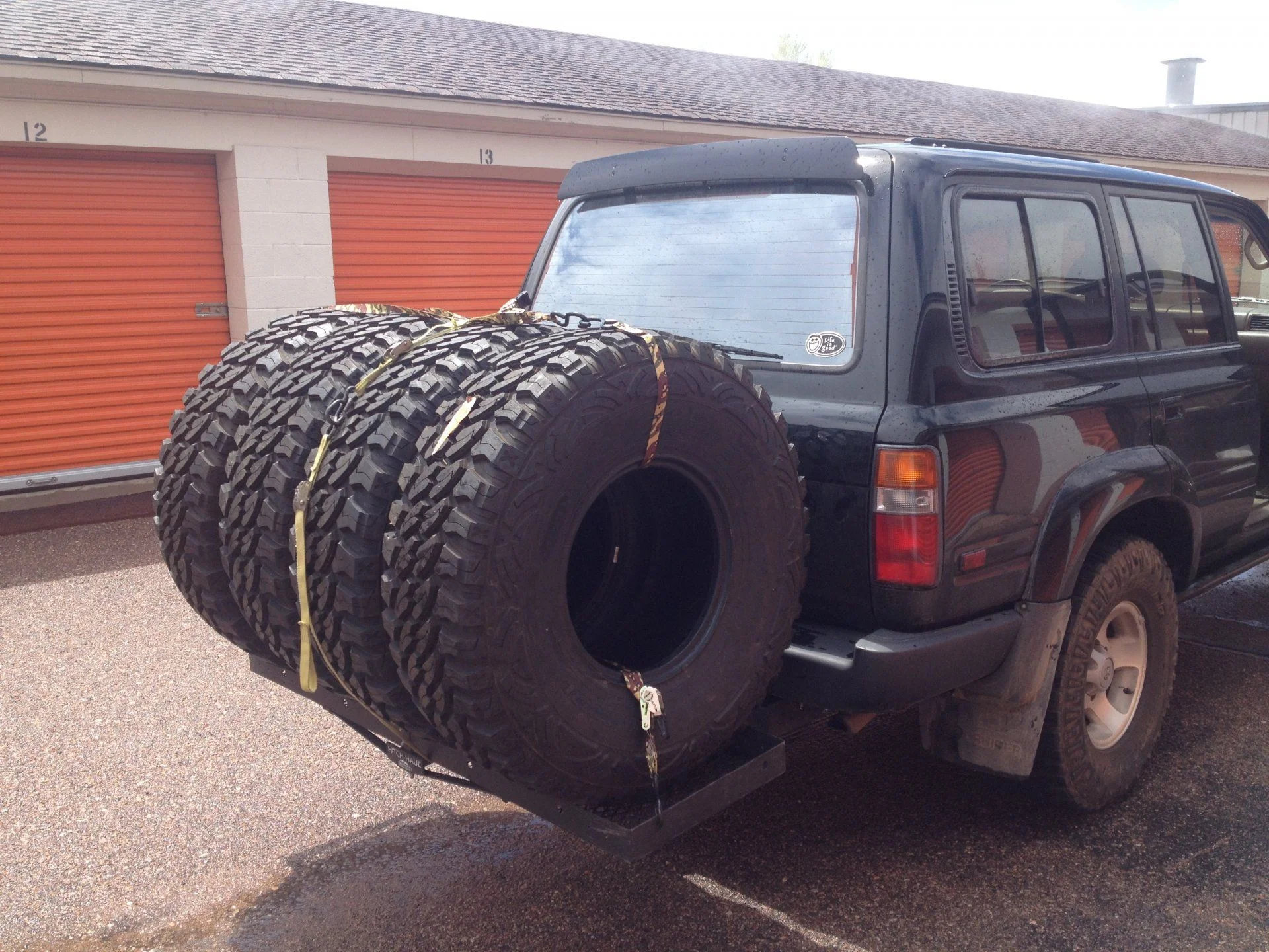

This is the day I found my tires. A guy on Craigslist was selling 4 brand new Pro Comp mt2 40x13.5r17 tires for $1000. One had a few bites out of the tread. Told me it must of been a muskrat or something. Talked him down to $800.

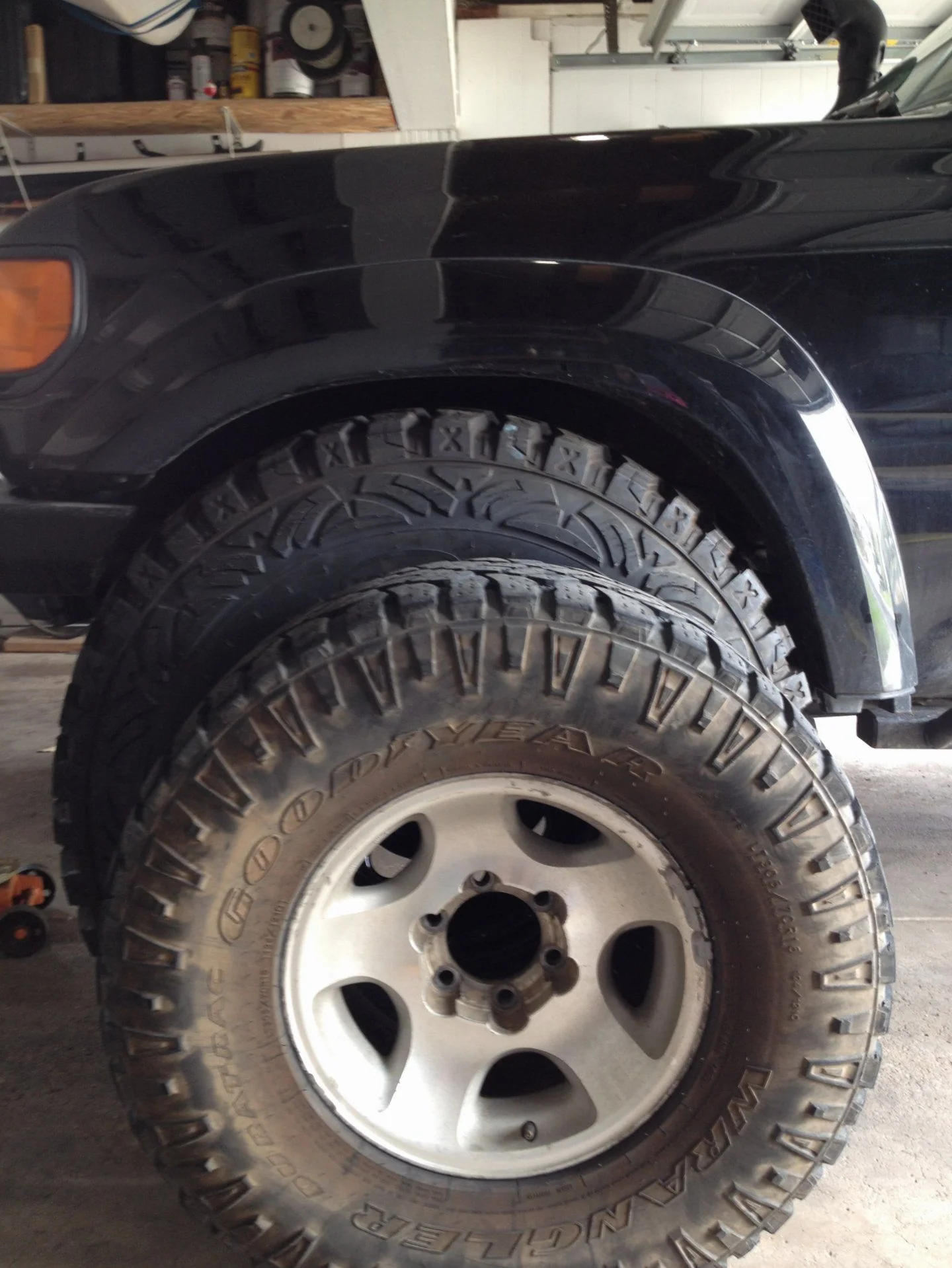

I cut 2.5in out of the front, and 1.5 out of the rear. I feel doing a 1in body lift also really helps out so you do not have to run crazy big bump stops.

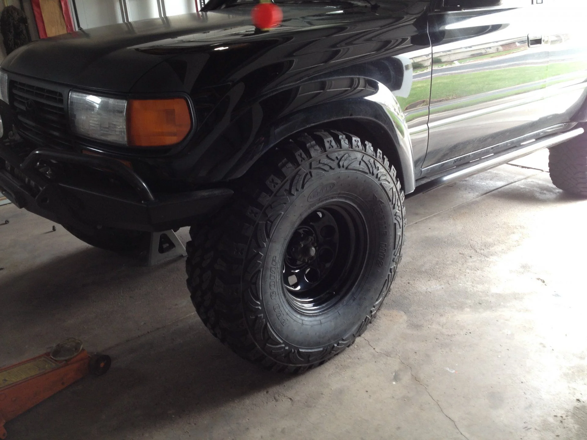

Rims arrived with very beat up boxes. Was slightly worried so I cracked them open fast. After much debate in my head between 2.5 and 3.5in backspace I decided to go with 3.5in of backspace. The wheels are Pro Comp 97 series 17x9 3.5in backspace. I found 4 off amazon for $89 each, and Prime.
Was very excited so I had to go test fit once I got them mounted up. I didn't want to pay 4Wheelparts $20 a piece to mount and balance them so I did it myself. Mounting a 40in tire is not as hard as you may think. All you need is some soap and a Harbor Freight tire iron! Not even a chance of turning with flares :doh:

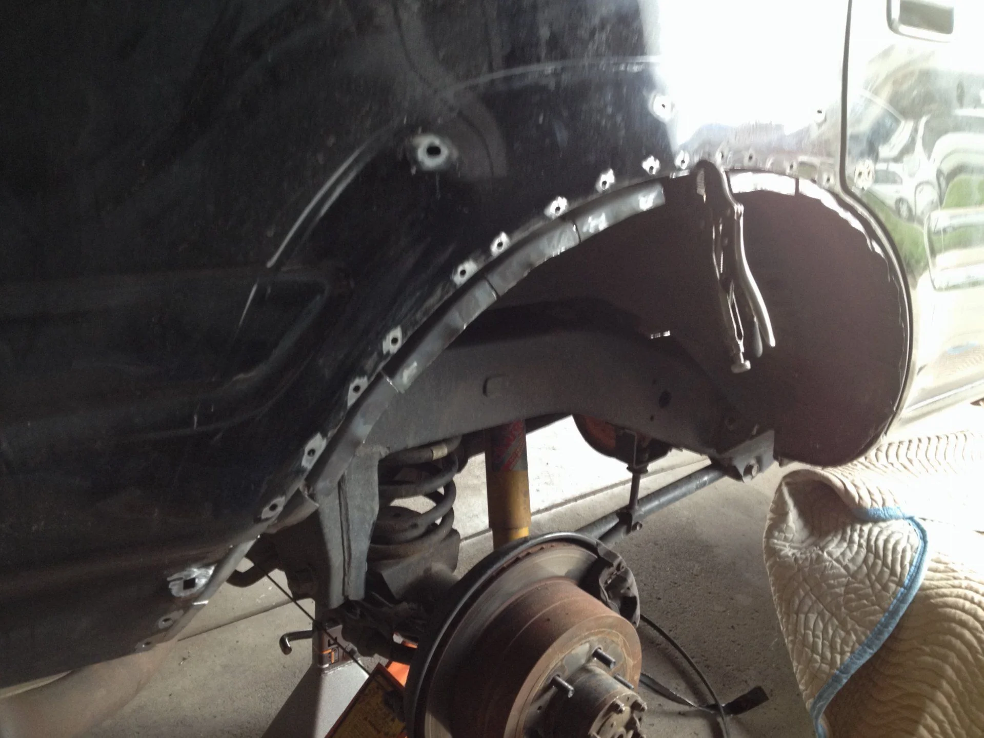

Now it was time to cut the fender wells. Also took off the front bumper and sliders. At first I only cut the front, but soon after realized the back needed to be chopped soon also. The tires rubbed quite a bit. I won't bore you guys with many fender cutting pics, but 2.5inches of sheet was taken out of the front, and 1.5in out of the rear. This is how the rear was done. We cut it, then bent it up, then re welded it. @LC4LIFE helped with the welding due to his superior skills.

I wish someone would lay out how to cut and reweld a fender, I need to do a bit but have to frame f reference at all most folks In massachusetts dont really run largewr than stock on thier caddys or prius
:hmm: Maybe I need 40's. Looks awesome, keep the pics coming.
I'd be interested in tips and tricks on cutting the fenders myself...
Ideally longer control arms to move the diff back about 1.5" works and moving the front diff forward around the same before cutting helps alot.
