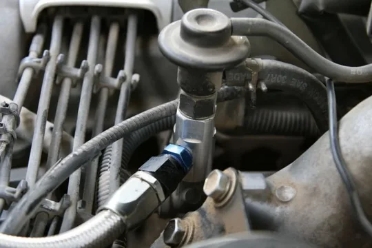

I made and installed a riser nipple to get access to fuel from the fuel rail. This allows me to install AN fittings and hose that provide fuel to the 7th injector.

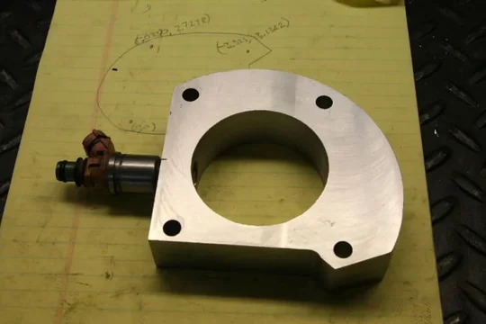

I butchered a spare throttle body and used it mount the injector. I cut off everything and filled all vacuum ports with JB weld. I then drilled and reamed a hole for the injector and made a small fuel rail to accept the AN hose at the injector. The completed and installed system is pictured below.
The hacked throttle body is my prototype and used for my initial installation and testing/setup. However, I am currently making a sandwich plate and will use this for my final install. This will replace the hacked up throttle body and will use the original TRD supplied intake runner for a clean (somewhat professional) look.

Do you mind sharing the machining specs for the injector hole on your sandwich plate? BTW, this is a really nice solution.
Sure, I will post up a separate post with this info.
Sorry, misread your post... but, anyways, the hole to insert the injector is 5/8" (0.625) at the nozzle which is ~16mm (0.630). The hole for the fuel inlet o-ring is 14mm.
