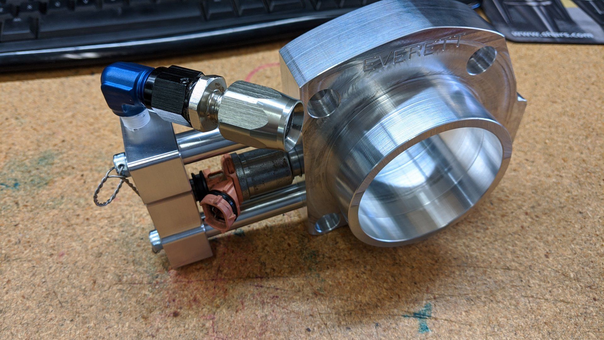

i finally got around to making a legitimate sandwich plate.
also made a few changes to the fuel map, otherwise running great after ~8-years.
Is it possible to purchase this set up from you? Looks top notch.
