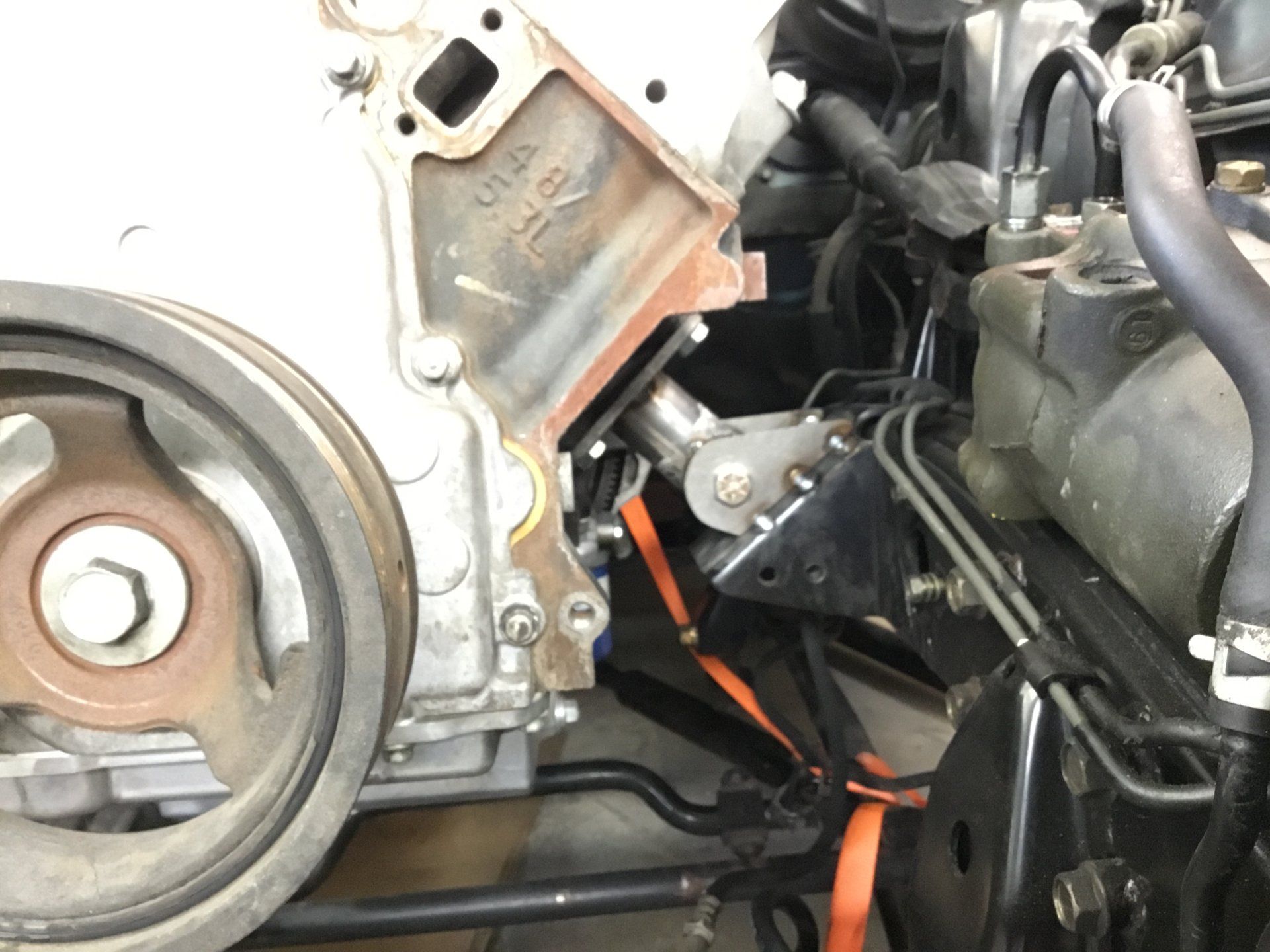

May just be the pic, but looks situated a lot higher than I could get mine while still being able to shut the hood. That's a regular trunk intake, right?
I've got the engine sitting as high and far to the left as I can as I'm trying to clear the transmission pan with the stock driveshaft. I don't want a big lift on this truck. Not going to use the engine cover.
I'll put the hood on and check clearance before I burn the mounts in, but I'm pretty sure it will fit.
