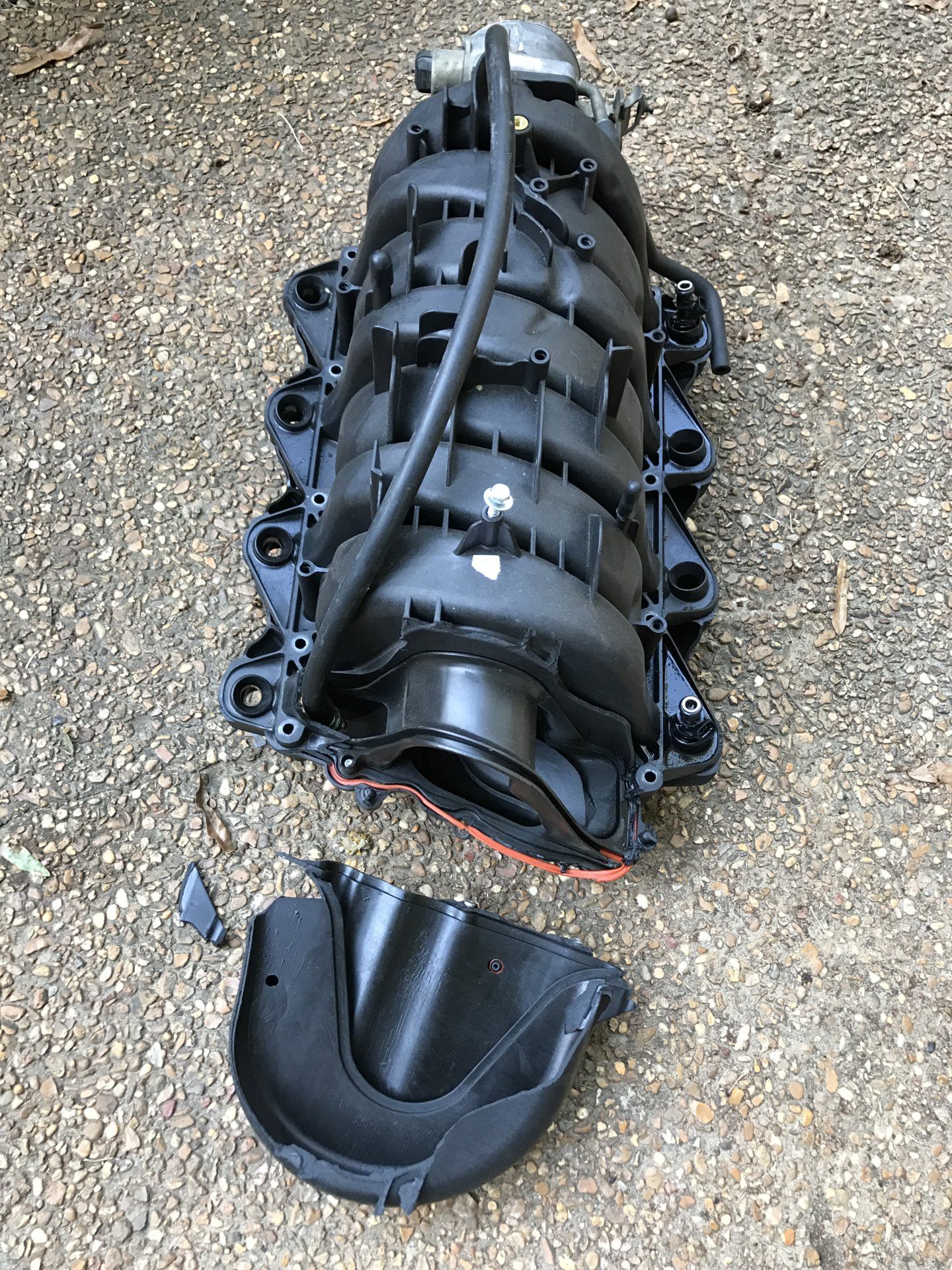

And for those that want to run a truck style intake, steer clear of the one from Doorman. It looks better than the OEM truck intake and flows almost as much as the truck intake from FAST but mine suffered a catastrophic failure.
It had a strange noise ever since I got it running that sounded like a baffle in the intake was loose. Took forever to get it cranked when its cold. It blew on a cold start and sounded like a 12 gauge. I know of a few rigs that are running 18psi of boost through the same intake without issues. I'm now running a stock truck intake with zero issues. Starts right up on the first crank now. Odd fluttering noise at idle is gone as well.

And for those that want to run a truck style intake, steer clear of the one from Doorman. It looks better than the OEM truck intake and flows almost as much as the truck intake from FAST but mine suffered a catastrophic failure. View attachment 1557566View attachment 1557567
That's crazy. I didn't know Dorman made intakes. Like you said, looks just like a FAST brand.
