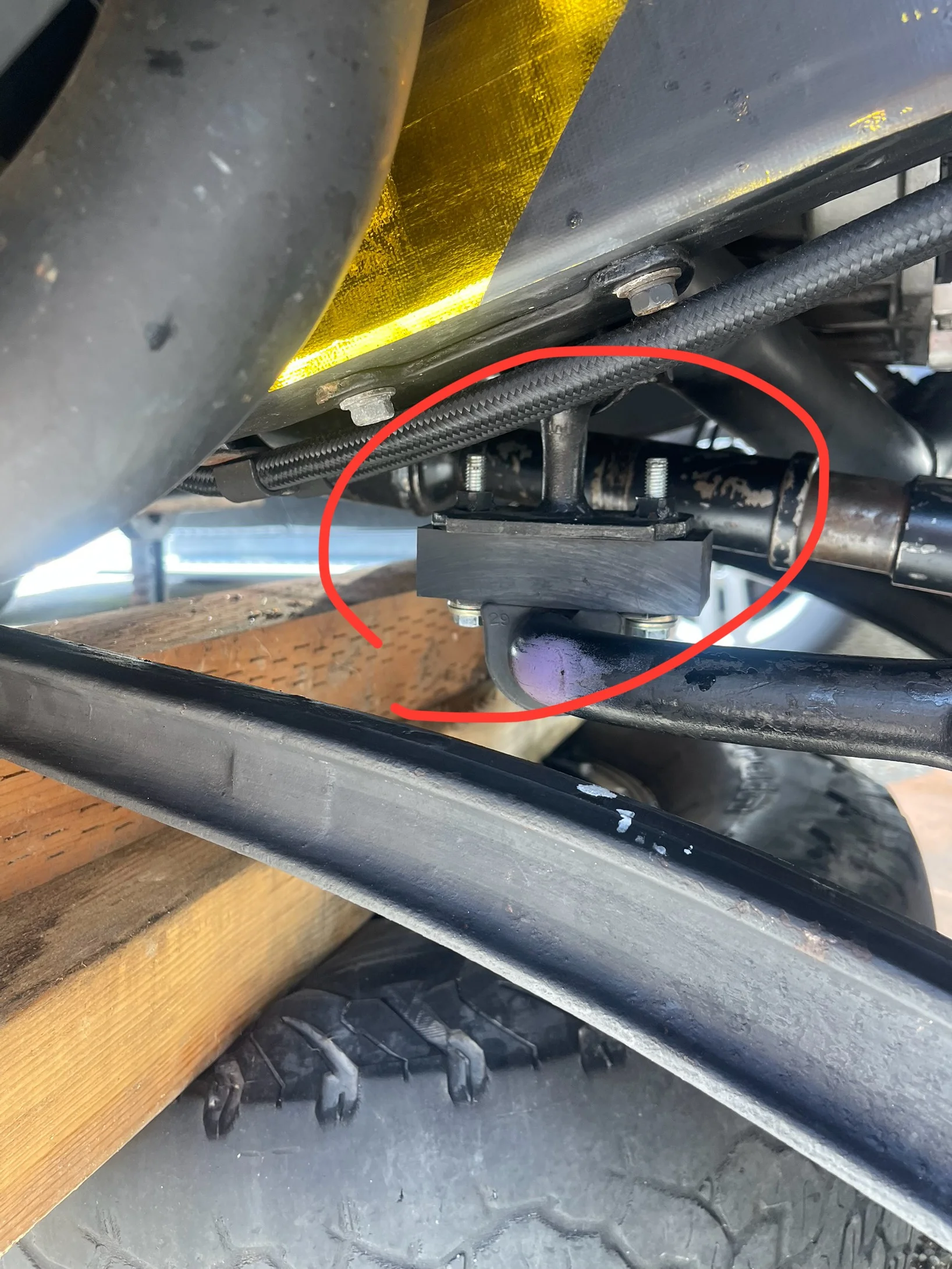

Yup. Power steering and driver side header was very tight on my swap. I figured the drive shaft would have hit sway bar over bumps or something so I fabricated the temporary sway bar drop at the time from the high density polyethylene (HDPE) plastic, rated 4,000 psi versus aluminum at 10,000 tp 75,000 psi. Easy to construct. I kept it on since I haven’t run into a problem with it yet. Wanted to experience with it. Will replace with a robust ones if it breaks. Torque on the bolts is 13 ft lbs I believe so I think the sway bar drop won’t need to be high compression, besides the sway bar shifts side to side.

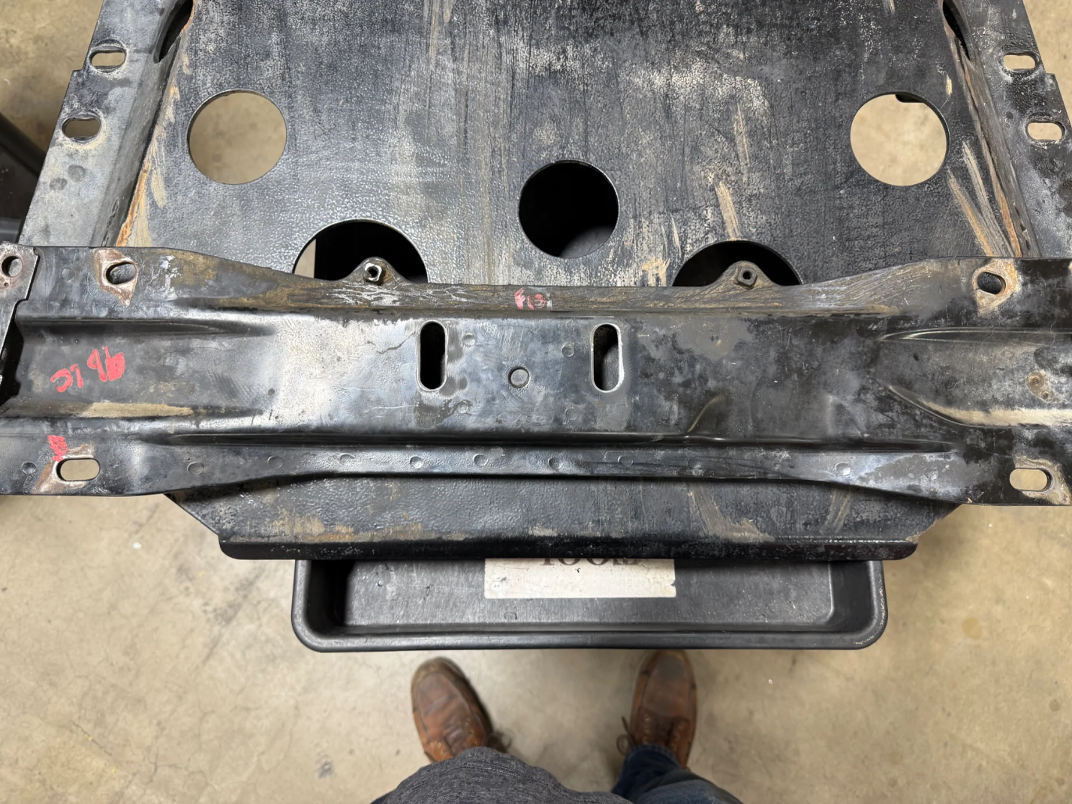

Oh for sure. Was just getting things in rough spots using a mock up block. I have my engine ready to go this weekend. Will be using it to place everything. Just machined my crossmember today to make it work. Should fit ok now based on what a few of you have been telling me. Slotted it 1 1/4 inch. Just to be sure. I won’t be using this once the truck is done. I have a stronger skid plate/crossmember that you can see under it kind of.

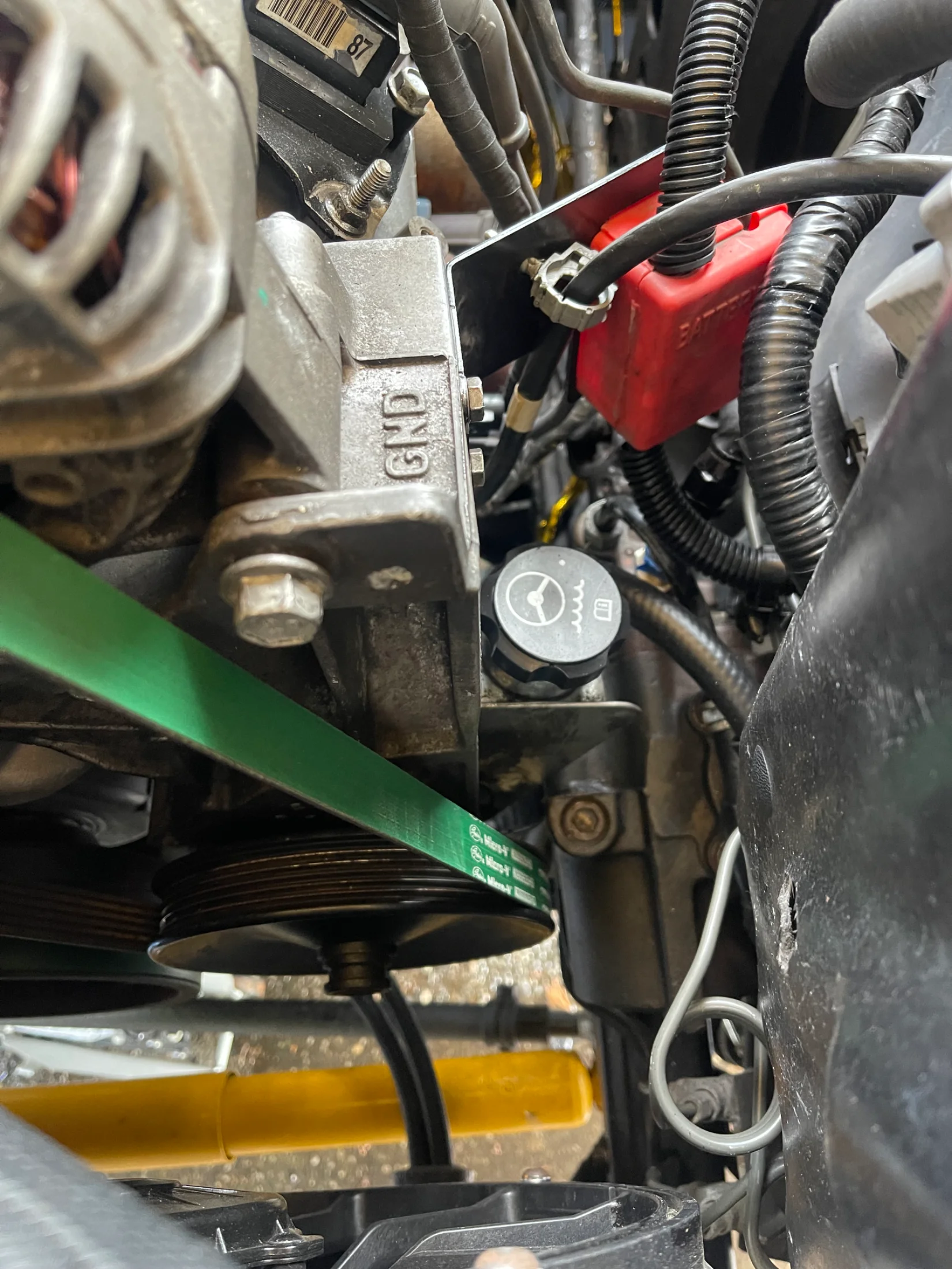

The PS pump coming very close to the steering box is normal with the OEM front drive set ups. One thing that will buy you 1/4" is to plate the outside of the frame in the area where the steering box mounts. This is common on wheeling trucks to prevent a somewhat common crack that forms in the frame sometimes behind the box, where panhard mounts. Two birds one stone kinda thing.

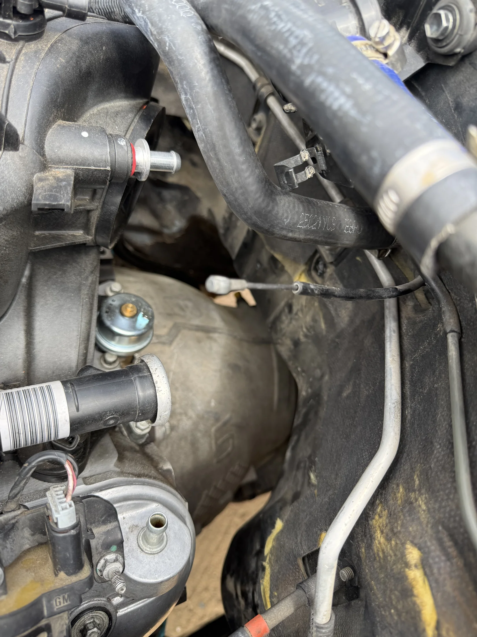

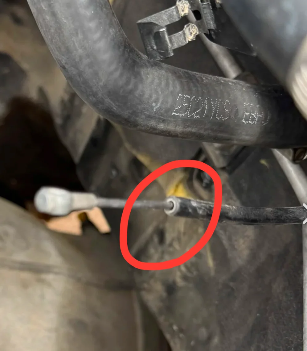

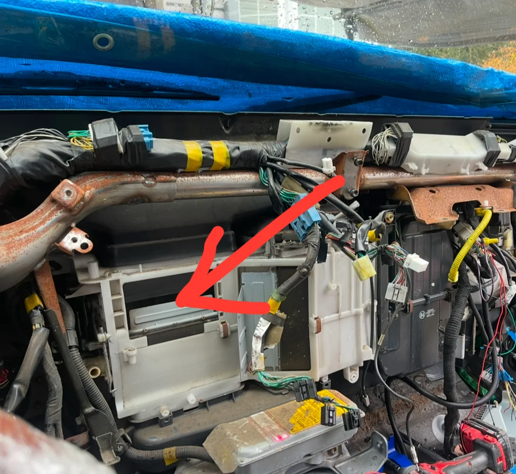

Hooking up my heater hoses today and realized this cable no longer moves when I adjust the hot/cold slider on my center console. Does it come disconnected easily in the dash? I have never encountered this issue before. I don’t think the vehicle needs power for it, or does it? Battery isn’t hooked up. Any ideas before I tear apart the dash for no reason?
The cable connects from HCV to a servo motor not to the slider mechanically so yes you need electrical power.
Yes electrical not mechanical. I believe that cable is connected to the heatercore flap. See if you can hear it moves when you switch from cold to hot. You can also remove this vent piece over the driver side, under the steering wheel area. Looking into the heater core. If it works you see it move as well. I replaced my heater core (leak). At the time I can see the cable move in the engine bay. And saw it move inside. So I knew it was working properly. If it's blowing hot air into your cabin and haven't fix the problem yet. Try to shut the valve with your fingers in the engine side if you want cooler air. From your picture, maybe the cable is bent, causing it not to move? Also, see if the cable retracts in and out.
I don’t have the battery connected at the moment so that would explain why it wasn’t moving. I thought I was mechanical, not electrical. So that explains it. I’ll have to check in the coming weeks when I start hooking it back up.
