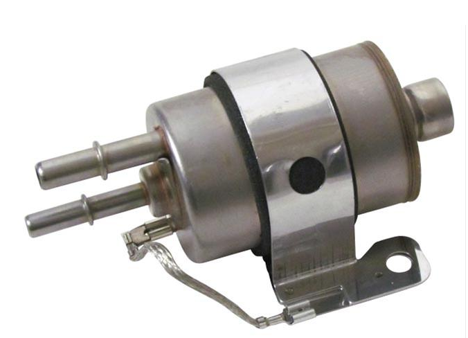

I’ve been reading and I see some guys talking about fuel filter issues with the lq4 swap. Something about a corvette fuel filter or a fuel filter on the fuel rails? Is this something that I’m going to run into and need for my swap?
You will need to have fuel pressure about 58 psi for ls motors. Corvettes had a combination fuel pressure regulator and a fuel filter. It is a cheap way to do both, and it is what many use.
Ok thank you. So what ends up happening with the regulator that’s on the driver side rail if you use this instead? I do like this approach so we aren’t plumbing a new filter somewhere else.
My L96 doesn't have a fuel pressure regulator, which is why I went with the Corvette pressure/filter. You can continue to use your built in one, and just add an inline filter.
yea, the lq4 have a regulator on the fuel rail on the driver side. hmm maybe i can still add a filter under the hood by the master cylinder so I am not cutting fuel lines. Hmmmmm...more digging i guess. Dont know the best way to do this.
