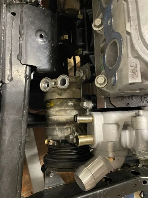

The stock ac compressor fit? Passenger side below the exhaust manifolds?

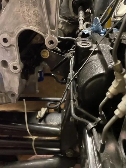

Yes, all stock 6.0 LQ4 truck accessories fit. I can get some pics if you'd like. I am using the summit hugger headers. That's the only aftermarket engine component. Also I put on a 5.3L power steering pump that doesn't have the 3rd hose for boosted steering.
Here ya go. Power steering pump isn’t installed. Pulled original off for one off a 5.3L.
The compressor fits but do the ac fittings clear
Not stock from a 2500 HD at least, I will get some fittings that come straight up which are very common with after market a/c mods. Have to get the lines modified anyway to match the toyota bulkhead fitting. Great news on the drive shaft, actually paid off to live in a rural area with lots of HD farm equipment. There is a great driveline shop, showed them what a I got and said easy as pie! I hesitantly asked for a ball park price, he said 350-450. With new bearings, I laughed and said Tom Woods wants 500 apiece! He laughed and said, I hear that all the time, said he has no idea why he sells them for so much, not like his steel is any different! So he will shorten my fwd drive shaft and make basically a new one for the rear. Only issue is I have to get my new springs now to measure accurately. So now the big debate of which springs to go with!!
That's what I was referring to is the after market ac fittings..
You will need an AC manifold of some sort. I use these from Hawk Motorsport. They have two types, essentially on puts the ports forward, the other puts the ports rearward. Both photos of the same piece.
