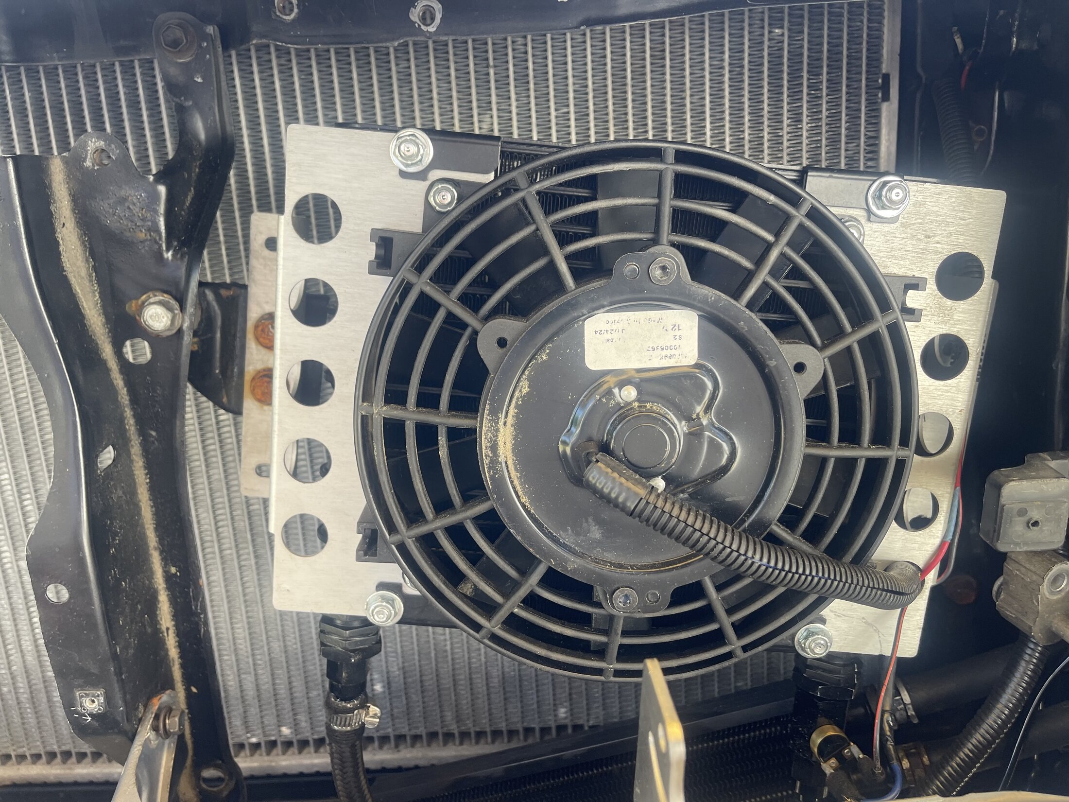

Thanks to all who have responded. Below are pics from my rig.
I suspect my problem is airflow so I will change to the Derake fans that I have that are 4000cfm. I will also add back my external oil and trans cooler. The final thing will be to address the IAT to see if I can lower that. Once done then I can reevaluate.
PS ignore the wiring for the fans that is temporary

I'm using this fan (4,000 cfm). I should have used the mechanical fan but too late. Was using a single fan, ford taurus, was a mistake (too loud).

I'm using this fan. I should have used the mechanical fan but too late. Was using a single fan, ford taurus, was a mistake (too loud).

I have those fans as well. The mechanical fan moves about 4K CFM as well, so the only issue with these is that they take a lot of AMPS to run. FYI. I am in Seattle too. I am looking for an airbox. I haven't found one that I love yet.
