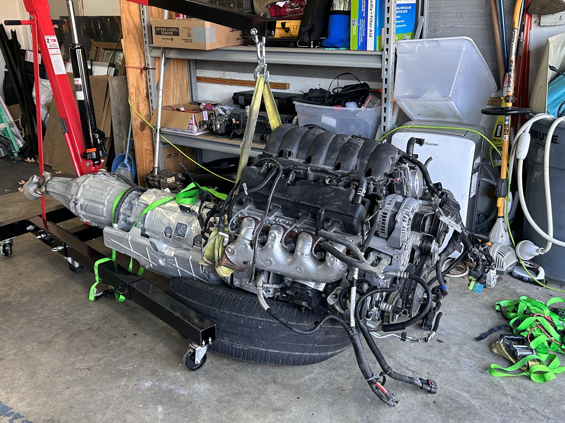

I guess I need to update my build thread! Picked up an L86 and 10L80. Also ordered my Torfab kit!

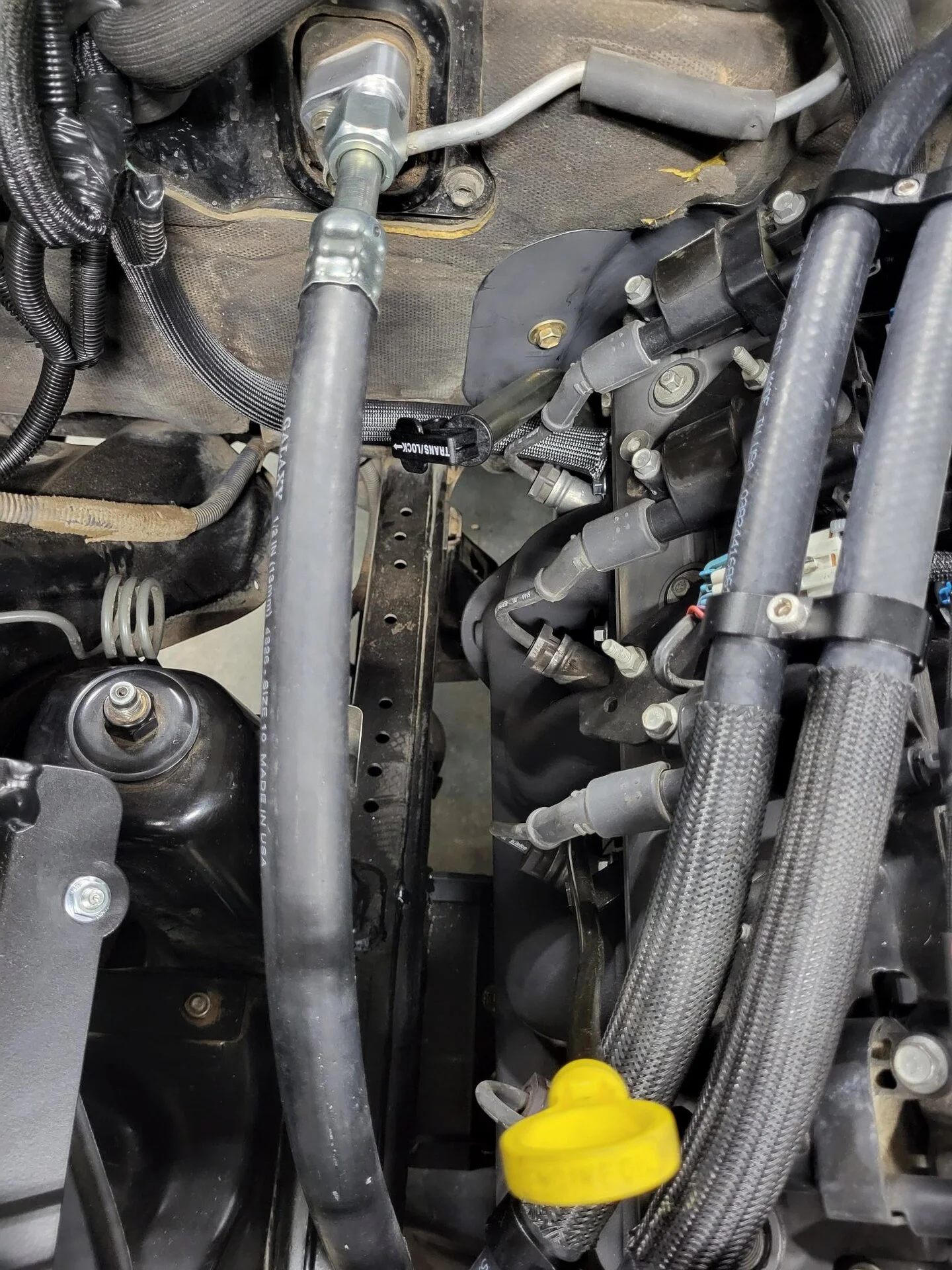

100% bolt-in AC hose kit for Gen 3/4 truck compressor (and assuming using 4l60e/6l80e with stock crossmember/transfer placement) will be available to order soon. Will be a suction hose and high pressure hose (from compressor to condenser) already crimped to length, with adapters for firewall and condenser (with optional trinary switch port on condenser adapter) and compressor adapters.

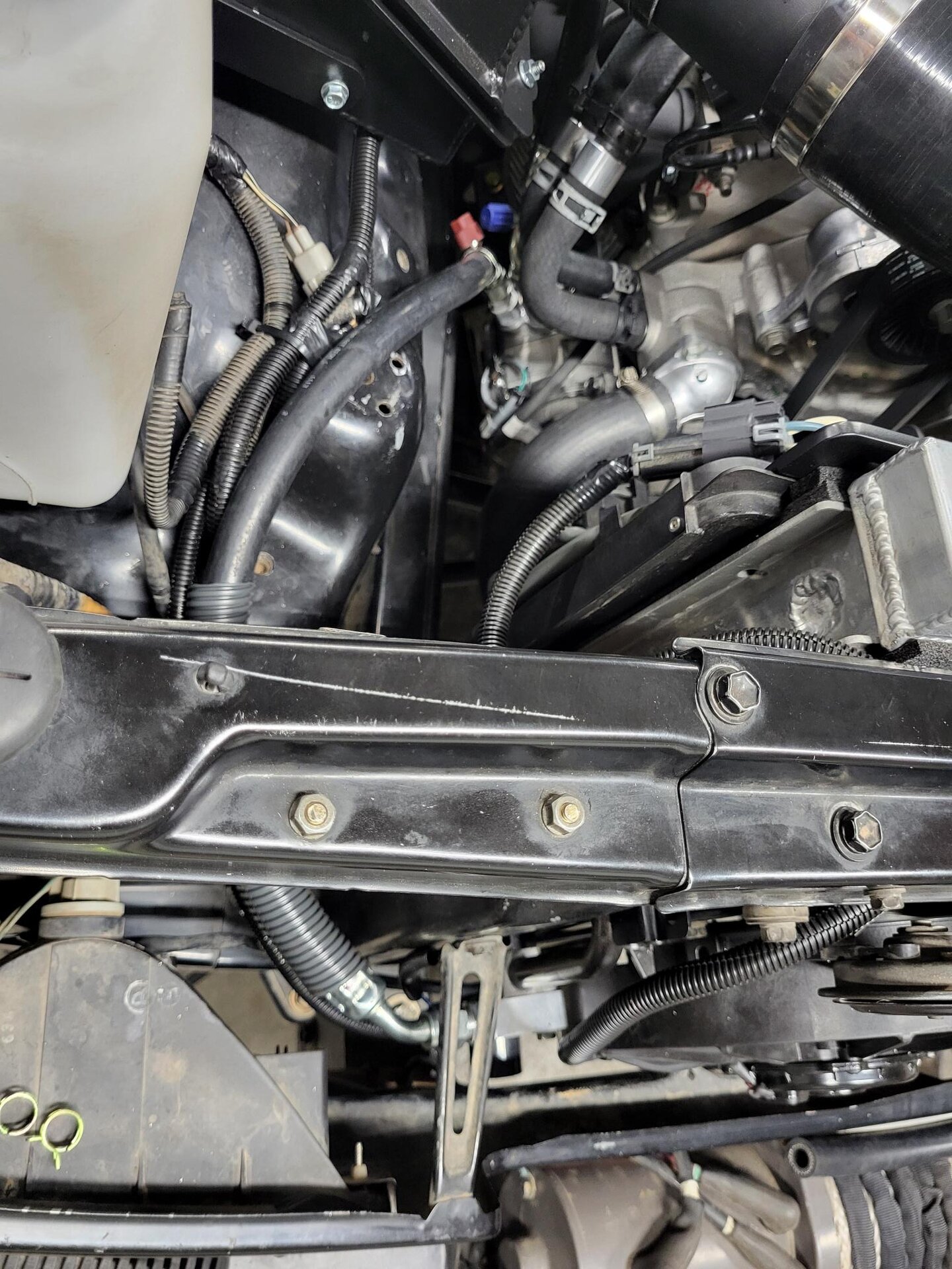

Nice Matt. Is that adapter with crossover tube on the heater hoses your creation too? Pretty slick.
No, I have made them in the past but I don't anymore since I don't believe they are necessary. My opinion is they are outdated myth. All that crossover is doing is bypassing the thermostat until it's open, and then all the water is going to flow anyways. there's just no need to do that and add four new potential leak points. They certainly don't hurt anything just not necessary.
I’ve never used anything to crossover myself. I do have a couple adapters in that spot on my 80 to neck down to Toyota sized heater hose though.

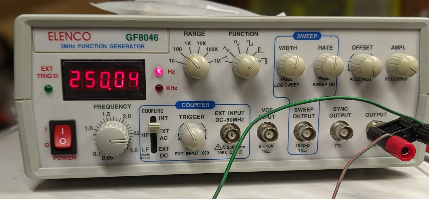

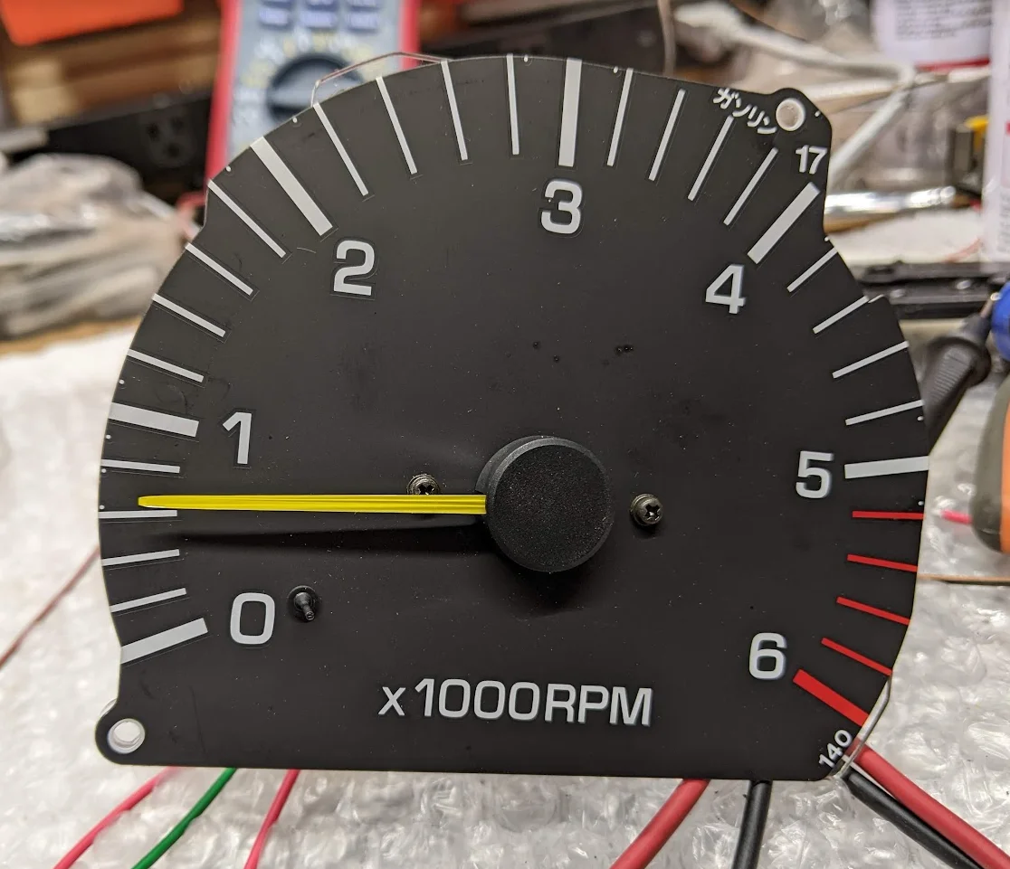

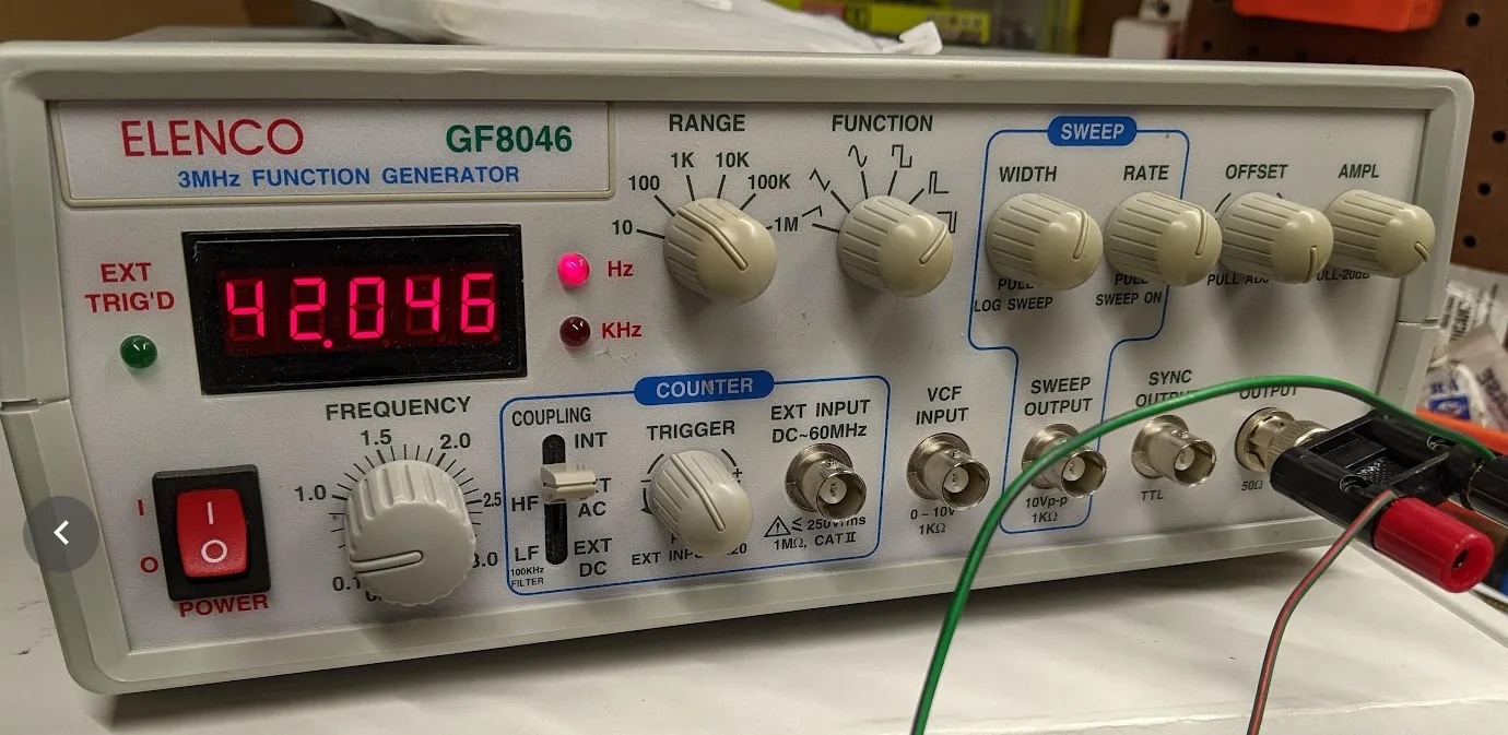

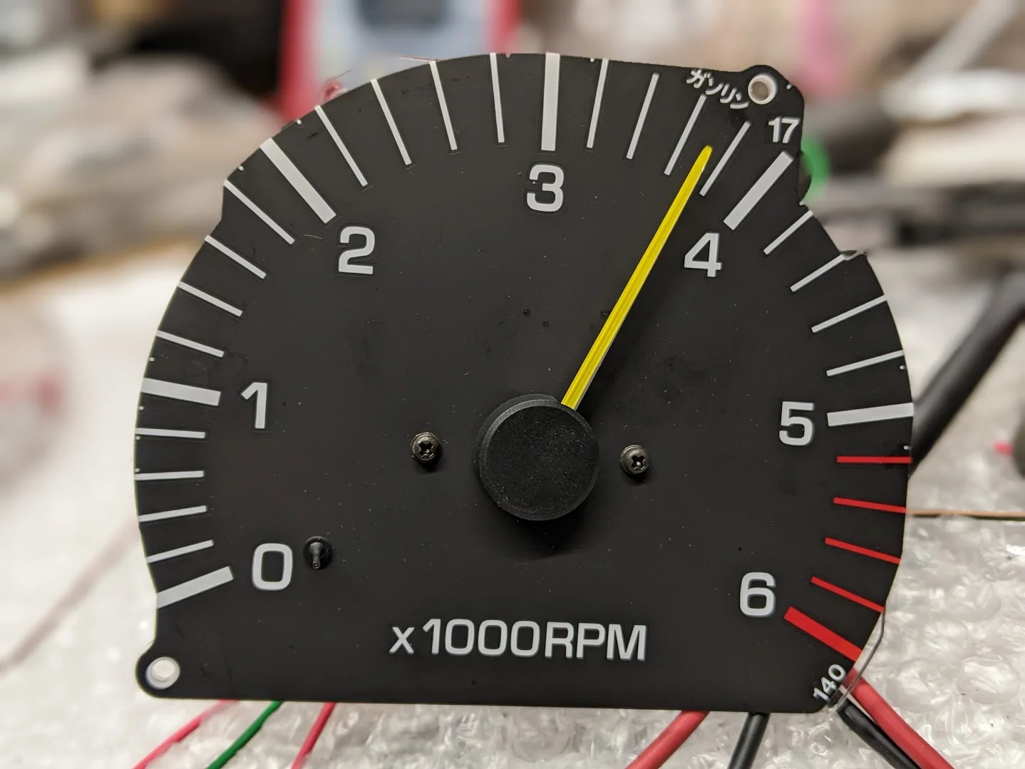

I want to thank @tmxmotorsports for sending me a spare tach to test.
I couldn't find much on the XRA6731A chip that Toyota used, other than some Russian websites. Usually one should be able to find a document to describe how to implement the IC.
What I did find is that the POT (variable resistor) that is on the board can be used to adjust the RPM vs Pulses. What this means is if your motor is outputting 2 or 4 pulses/revolution , rather than 3, this POT can be used to adjust the RPM to that frequency. That POT is a multiplier, which makes it super simple to adjust for motor swaps with different number of cylinders. I am sure Toyota did it this way to make it useful for 4 cyl, 6 yl, and 8 cyl engines.
I will update this post once I measured the resistance on either side of the POT. This way someone can just set the POT and get close...without having a frequency generator.
Toyota's 3 Pulses/Revolution * 60 seconds:
(42Hz/3 pulses/rev) * 60 seconds= 840 RPM
(250Hz /3 pulses/rev) * 60 seconds = 5000 RPM
SwapTime (V8) 4 Pulses/Revolution * 60 seconds:
(42Hz/4 pulses/rev) * 60 seconds = 650 RPM
(250Hz /4 pulses/rev) * 60 seconds = 3750 RPM
Resistances
Stock (1FZ-FE), 3 Pulses/Rev:
A <-> B 44.56 kΩ
A <-> C 54.91 kΩ
B <-> C 96.7 kΩ
Two different Tachs adjusted for SwapTime:
4 Pulses/Rev:
A <-> B 57.93 kΩ
A <-> C 44.15 kΩ
B <-> C 96.7 kΩ
A <-> B 58.83 kΩ
A <-> C 42.73 kΩ
B <-> C 99.1 kΩ
B <-> C is just measuring the total resistance of the POT. There is variance between POTS.
I think A <-> C resistance is being used by the XRA6731A chip. Get close to that reading for 4 pulses/rev.
I saw that pot and was wondering why that would be there. Makes sense to me now. So if we use a scan tool that shows the v8 rpm can we just adjust the tach to the rpm the scan tool shows and be done?
Yes, I think you can simply adjust that POT until the tach agrees with the scan tool. Tach has to be out of the dash, and just connect the tach signal to the P, Battery Positive to + and Battery Neg to -. I used the bolts that hold the tach in to attach the wires to the function generator.

Yep, I think some GM ECMs output a +5V tach signal, rather than +12V signal our tachs expect . Either use a pull-up resistor (GM recommends starting with 5K) needs to be used, and/or that resistor on the tach needs to be bypassed. I don't think a Dakota box for the tach is needed at all. I am using a GSS-3000 so my transmission dash lights work. 😉
