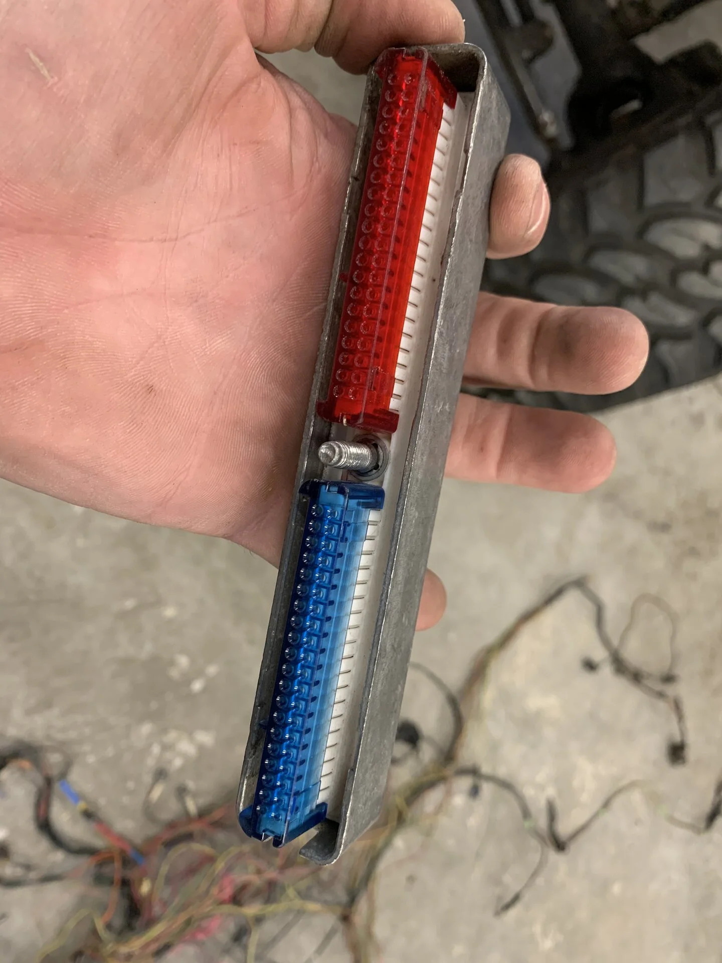

I’m doing a K5. Harness all routed and loomed just throwing the ECU pins on now

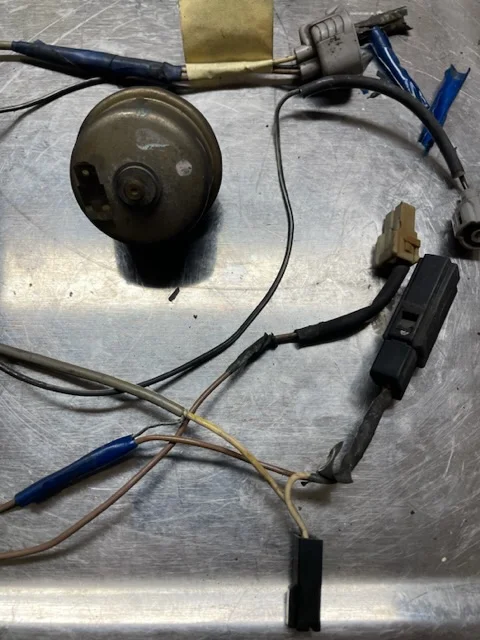

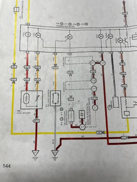

Can anyone shed a little light on this. Working on extending the wires for the oil pressure sender. I see the noise filter that connects to the spade on the oil pressure switch and white wire to the round knob. Question is, did you use the noise filter still in your swap, and did you need a ground for the oil level switch Y-R wire or did it ground when low? Thanks!

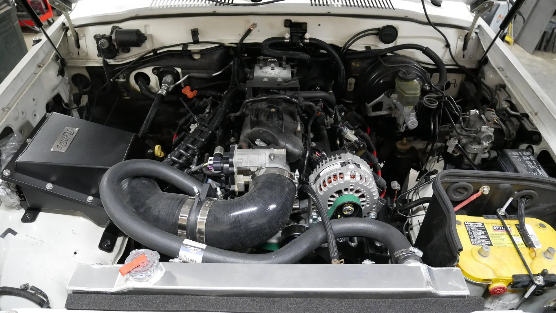

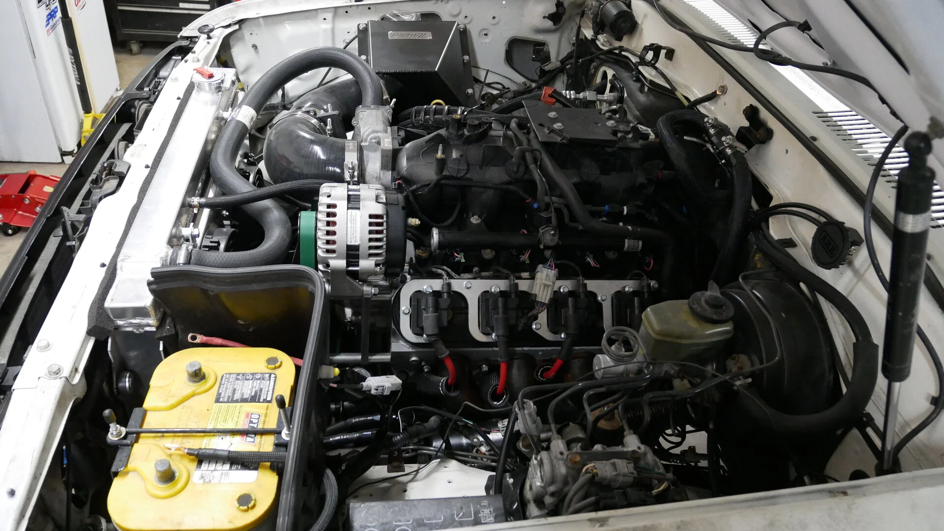

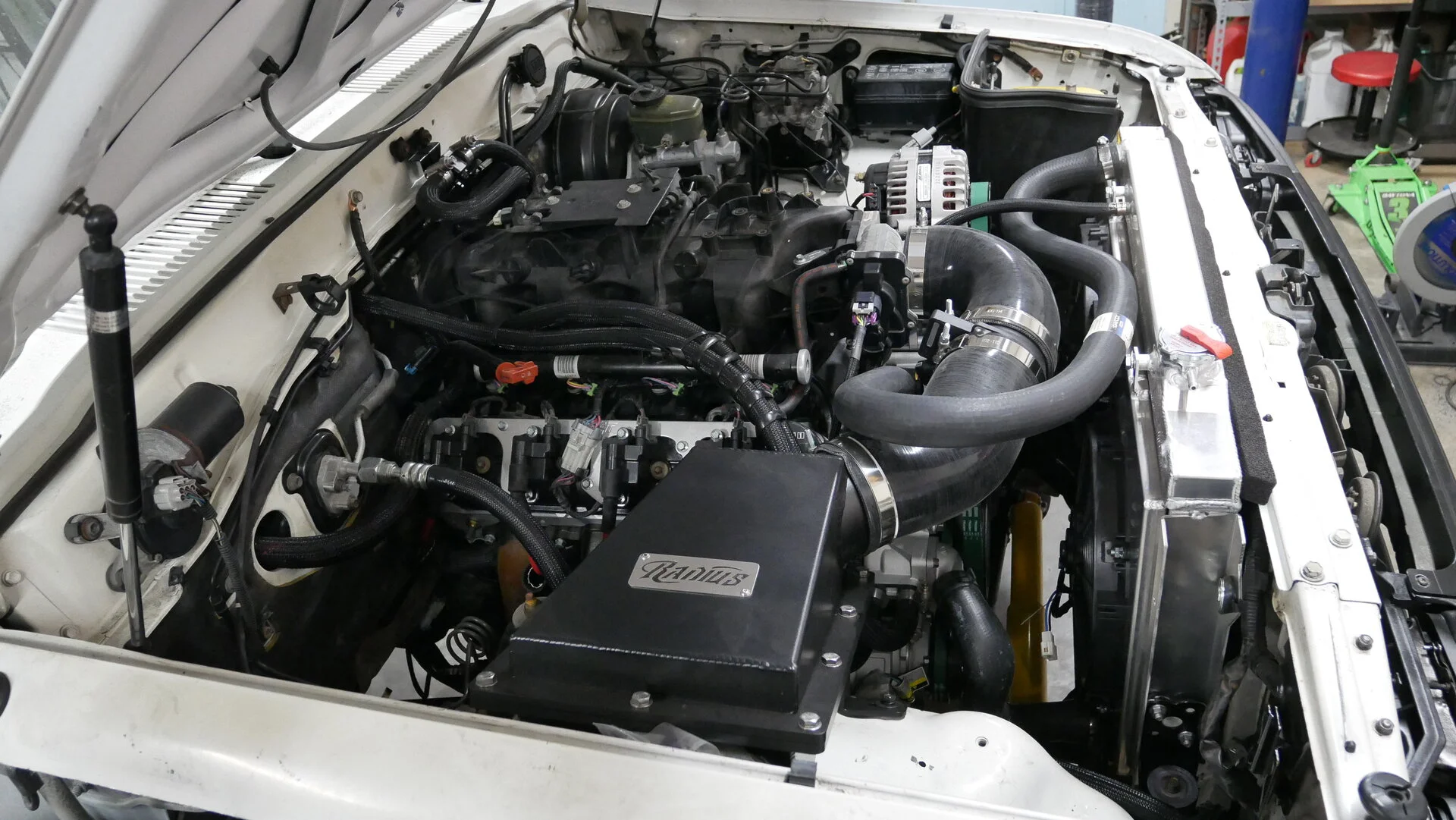

White Sheep, could you talk about your air box set up, looks real nice. Is that custom?
It's a Radius Airbox out of Australia.
I also have the matching snorkel (it's not required).
A guy here on MUD is selling the same snorkel for a pretty good price:
Radius Fabrications 80 Series Stainless Snorkel For Sale - Oklahoma City: Radius Fabrications 80 Series Stainless Snorkel - https://forum.ih8mud.com/threads/oklahoma-city-radius-fabrications-80-series-stainless-snorkel.1297293/

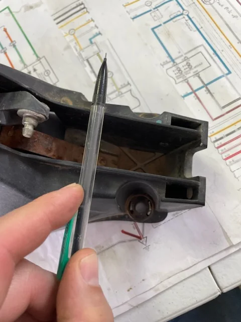

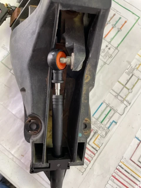

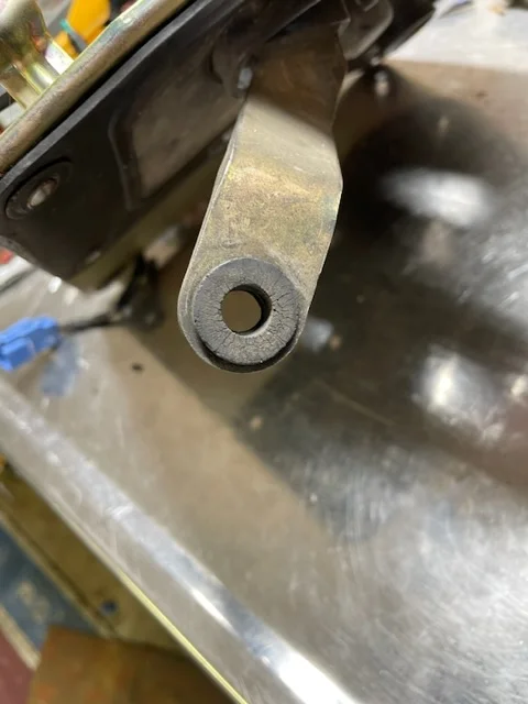

Got my trail blazer shift cable in. Went to a junk yard today and pulled the shifter from an Envoy out for a few pieces. I’ll use a dremel and cut out the metal stud to clip on the shift cable. I’ll weld it into place in the Toyota shifter. I couldn’t find an off the shelf cable barb. Also I figure I’ll cut off the plastic forward portion to lock in the cable and then route it around the other side.
One thing I need to figure out is where to mount my Dakota digital Transmission gear indication potentiometer. It shows it’s capable of being exterior on the trans, but I’m not sure how weather proof it is. Might be fine for a Sunday cruiser. I’d like to mount it in the cab off the shifter some how. Just haven’t figured it out. Any ideas would be great.
I know many have had great luck w/ this, I had the worst luck w/ this set up. It was sloppy for me. The shifter cable popped off a few times at the shifter. Finally had enough and went w/ a B&M gate shifter.
That’s odd. Mine is crisp and the indicator lines up perfect to the positions perfectly. Haven’t touched it since the swap over 80k miles ago.
