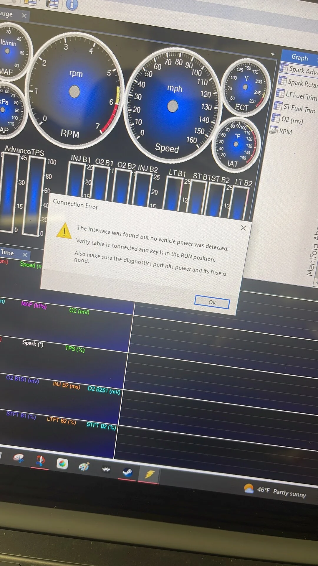

Has anyone had issues with HO Tuners not connecting? No matter what I do I can’t get it to connect.
I’ve tried Blue tooth. I’ve tried 3 different cables. I have power in pin 16 and grounded 4/5. 6 is high data and 14 is low data.
The ohms is right at 60
It goes to 120 if I disconnect the PCM.
The high side bumps around don’t 2-3V and low side is consistent. At 2.

Great question. The ohms check on the high low data would indicate that the network is operational. We should have about 60 ohms. If you unseat thecevu it should. E closer to 120. I had 117 when I did that. So I don’t think that is it.
I worked hard for 2 days. Maybe something is crossed up. I’ll continue to button up things and will get back to this. Just sucks as I am ready to drive it.
As with most things it’s something simple, check grounds? Case grounds, make sure power isn’t timing out if some relay is cutting open? Check for shorts? Sorry keep pressing.
Ground wires strike again. I made a mistake how I grounded the OBD2. Lol.

How did you ground it wrong?
So I am keeping the original OBD2 port. I moved the new port to the location of the original. Instead of running new positive and ground wires I just jumped off of the original port. However I jumped a data wire instead of a ground.
In my setup I had 4 data wires and I kept thinking I mixed them. Incorrectly.

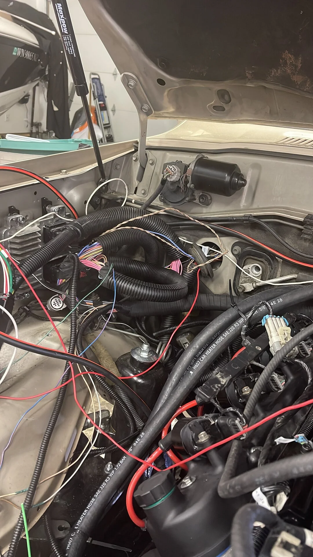

The good news is that everything seems to be good. Now the task is closing everything back up. And hiding the wires. I still have about 18” of too much wire on the X1 and X2 so I have to figure out how I will clean that up. No way am I leaving it like this.
That's a nice spot to mount the GM ecm. I guess your swap is DBW so you don't need the old cruise control.
