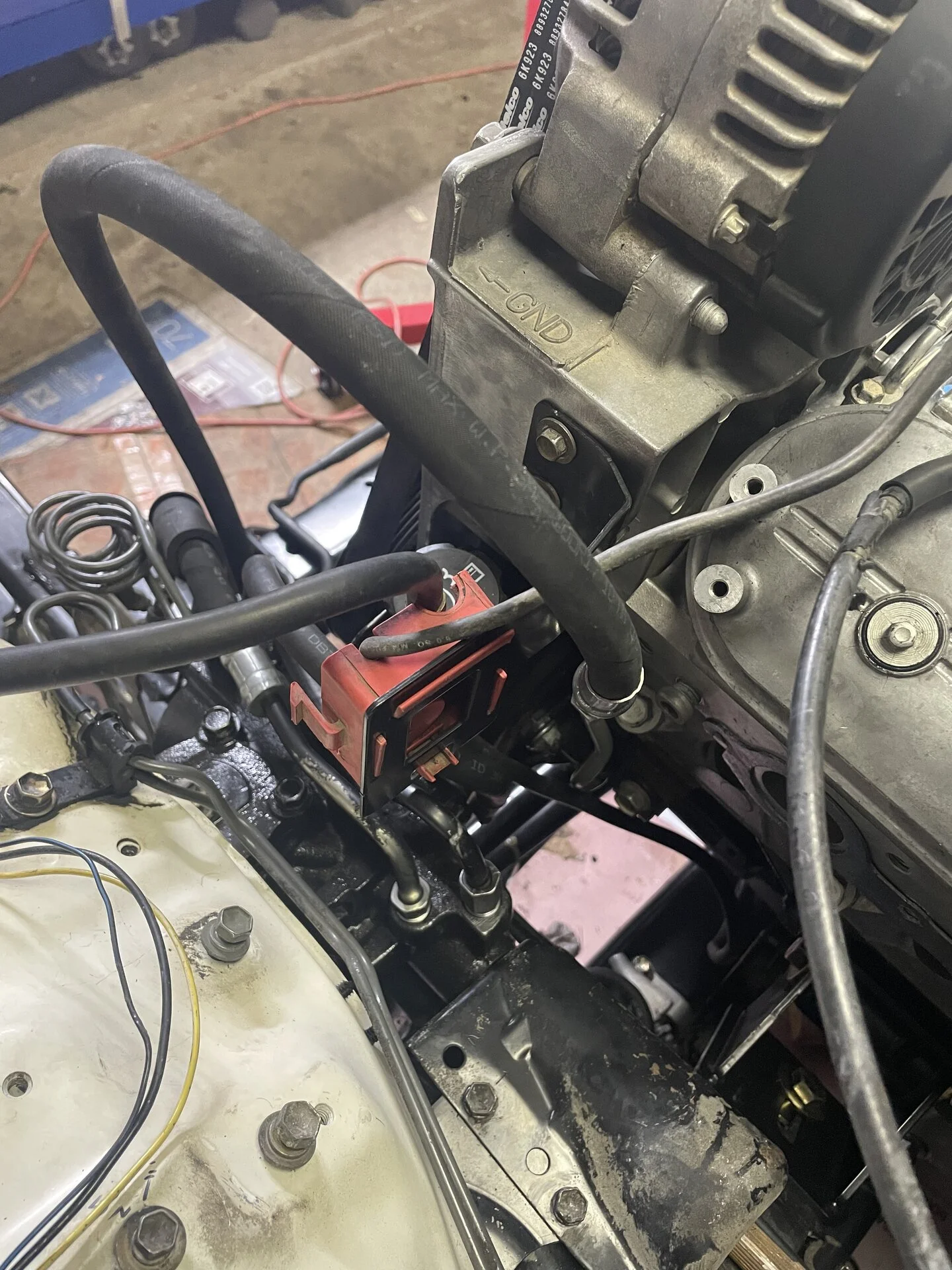

I got tired of looking at my ABS light constantly on so I installed the Marks ABS relo kit onto my already parttime SLEE V8 80 and finally have eye peace ! It’s a long story but after a very long wait and slow boat from Australia I ended up buying two kits , if someone in this forum is interested I’ll sell the second kit for a deal just direct message me . I’m glad I made the install .

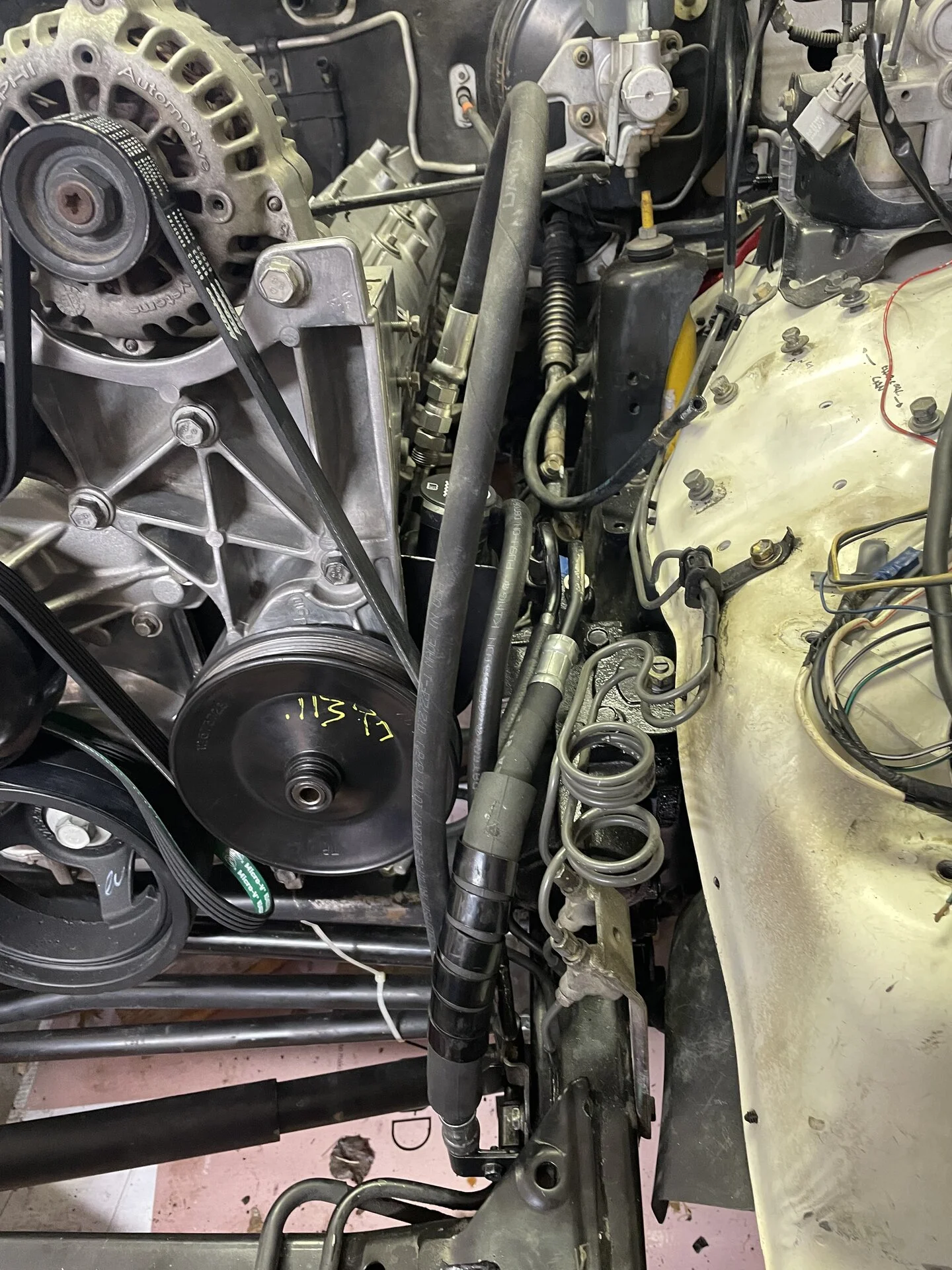

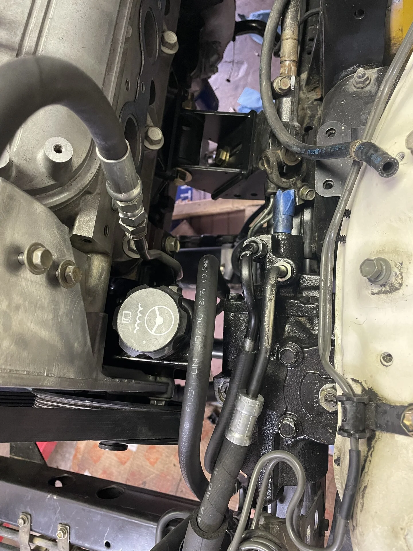

Got my power steering hoses done. Not sure I’m happy with them. I have the pressure line coming up and over where the battery block on a truck motor goes. Which I really like the idea of using. We’ll see. For now it’s hooked up. Can always change it later.
i just pulled the bulb.
Yeah, that’s unnecessarily huge and long.

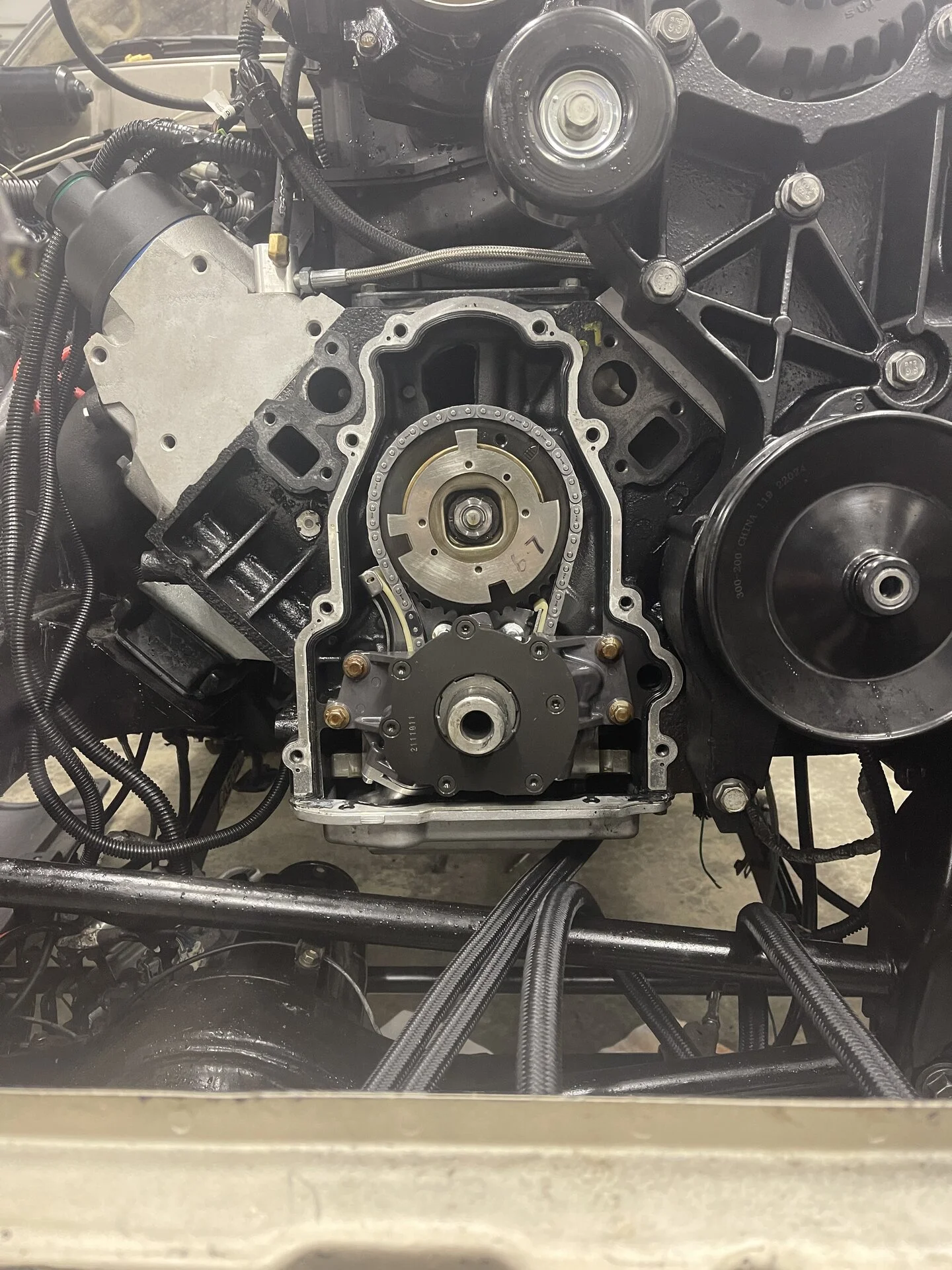

Are you referring to the oil galley barbell? Glad you figured that out!

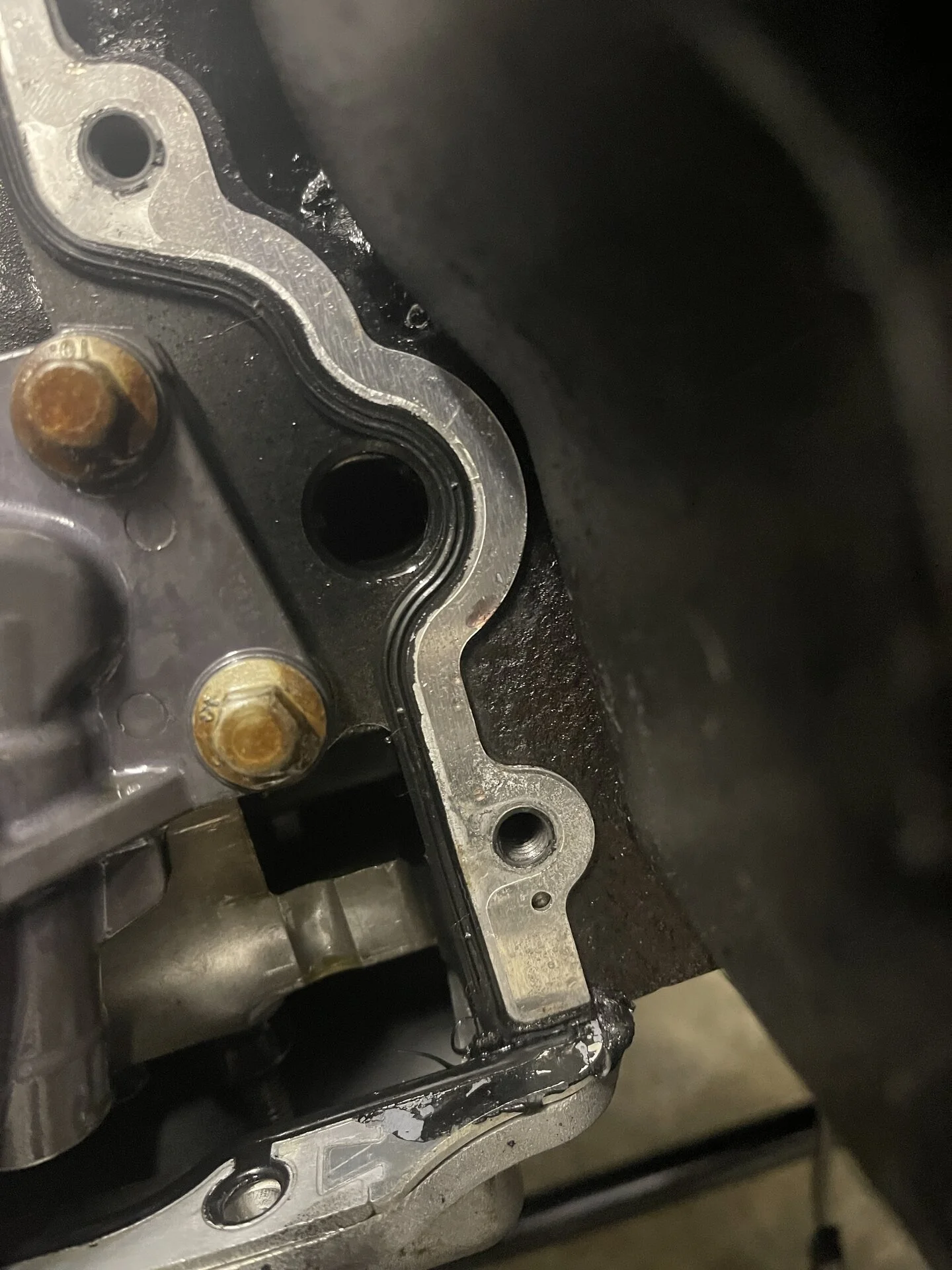

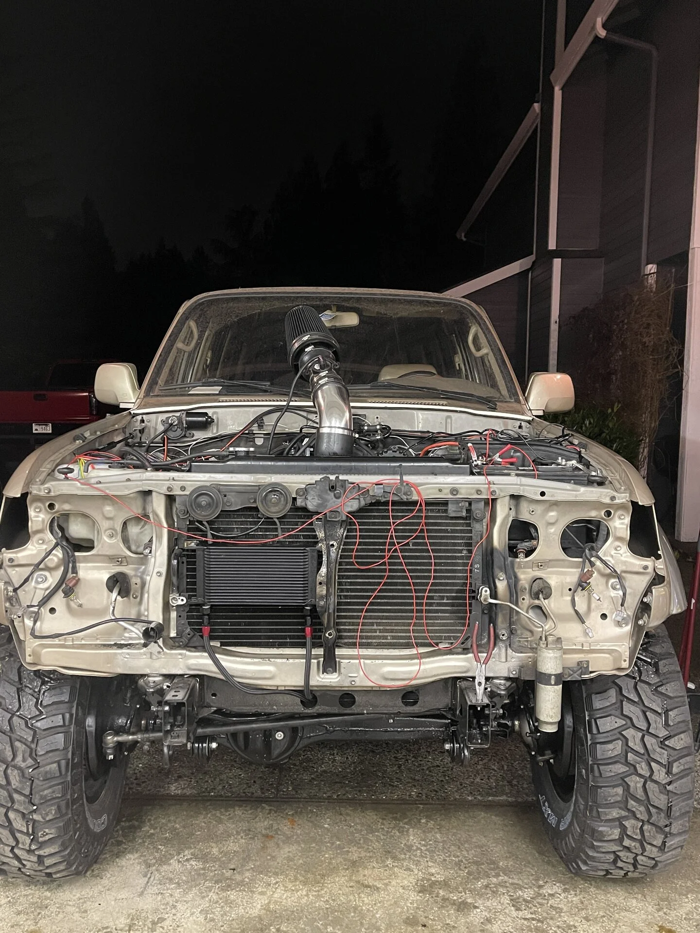

No. That’s on the backside. This is the front plug. Long weekend. Got it all back together then the front seal wanted to have the last laugh. Replaced that. We ran the engine for about 30 mins or so while on HPTuner. Still no exhaust so no O2 sensors.
Runs at about 208 pretty consistently. My shop was 56 so no real hard work keeping it cool.
Exhaust install on Wednesday.

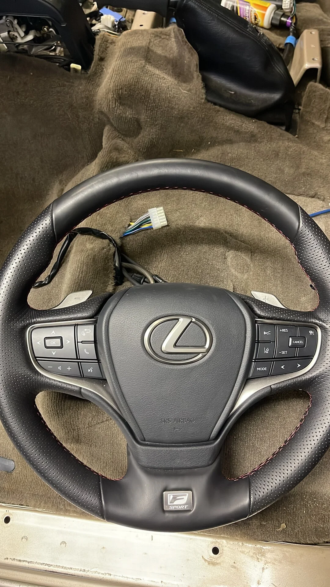

New steering wheel. 😎

Nice wheel!

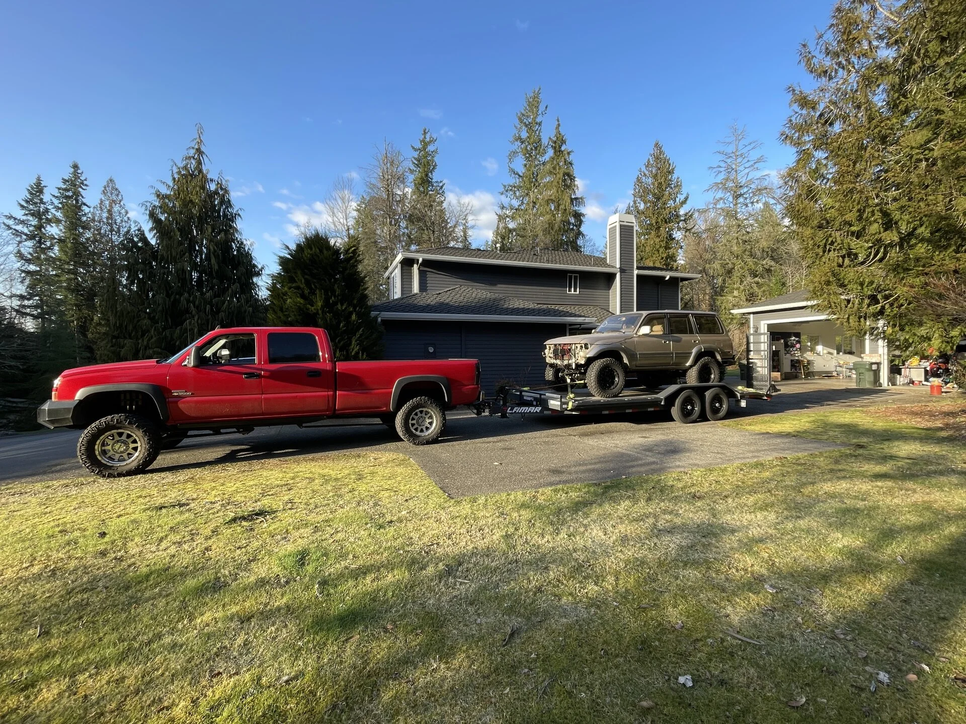

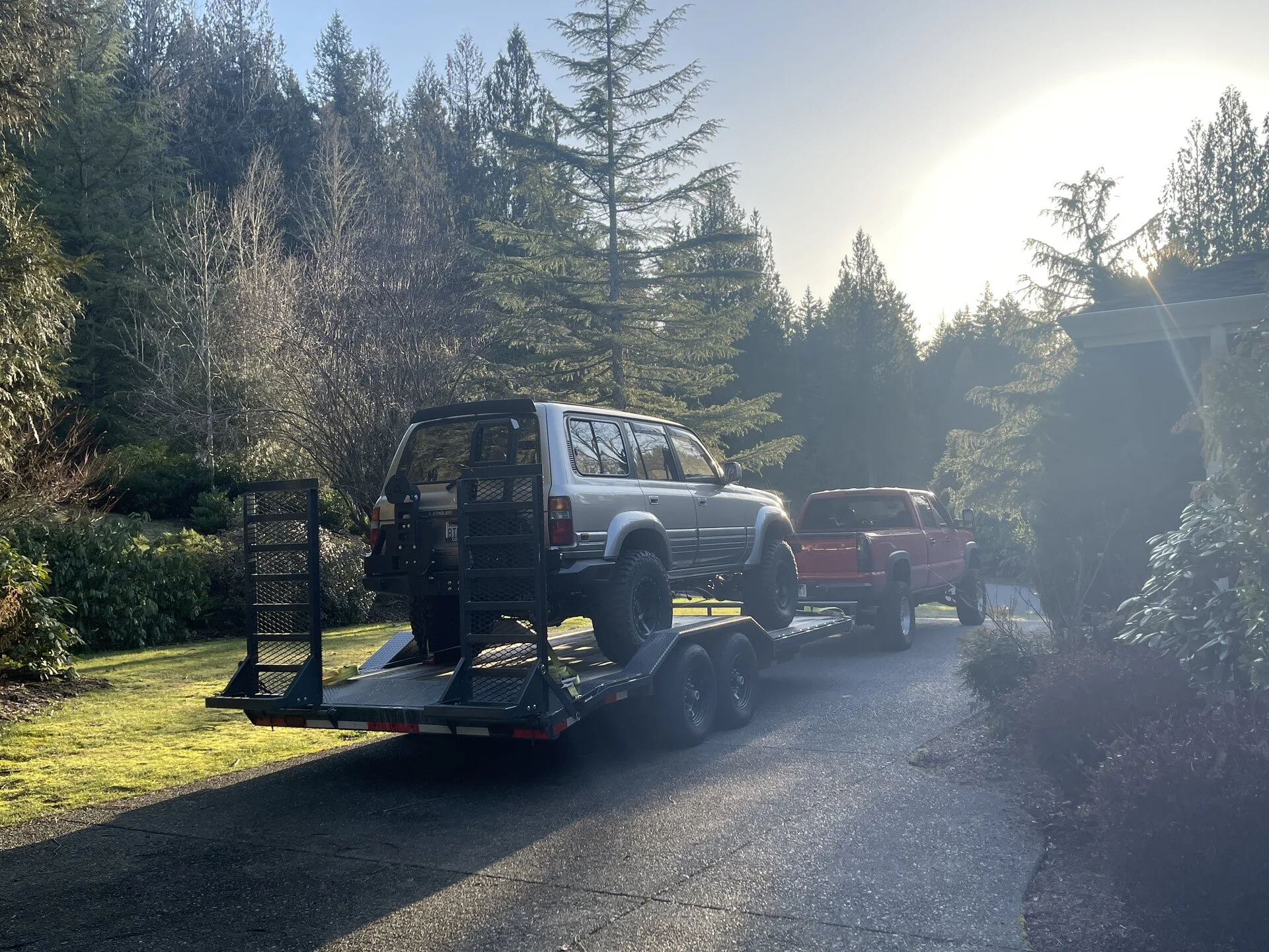

Loaded Rose up on the chariot. Parking gear would hold her. Go figure. PS leaking still. But I got the oil cooler on and appears to be okay.
once the exhaust is on I can get the O2 sensors in and she should run much cleaner.
Then it’s on to addressing the issues in the trans.
What rear bumper is that if you don't mind me asking.
It’s from @Delta VS I’ll be ordering a front soon. They are pricey. But as someone who sold bumpers for Jeeps for years. These are solid. Quality work.
Literally I have sold thousands of bumpers but Dave’s work is awesome.
Seconding on @Delta VS quality. I've beaten the tar out of mine since I installed it and the swing outs still close like they were new, even with a 37 and fuel mounted and driving over moon rocks at 30MPH for days.
Perfect match for the 80?

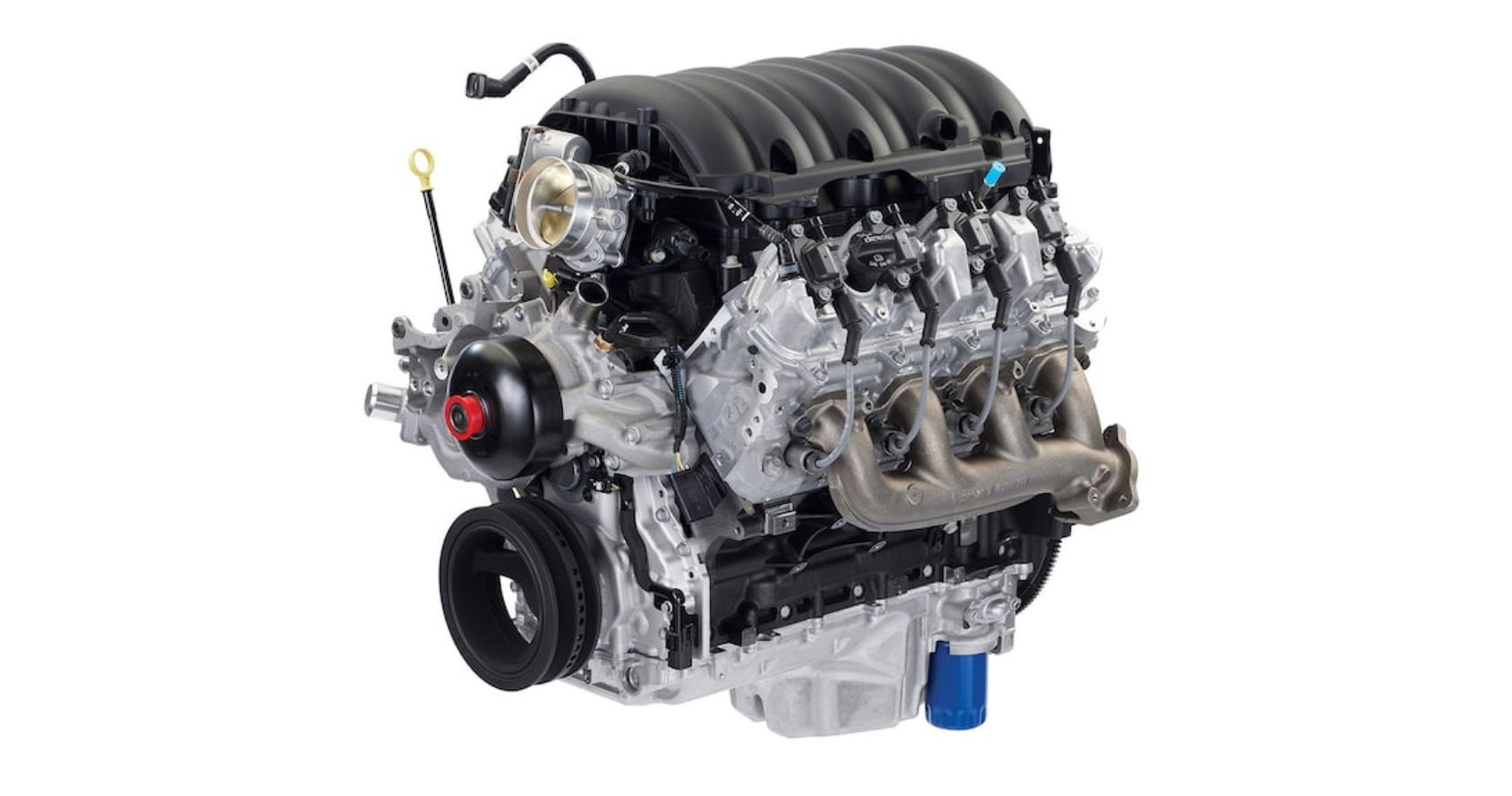

Those are going to be pricey even in the junk yard for some time i would think. You can put a stroker crank in a lq4 and get more displacement. The LT would give the option for a 8 or 10 speed. I'm sure it's a smoother driving experience.
