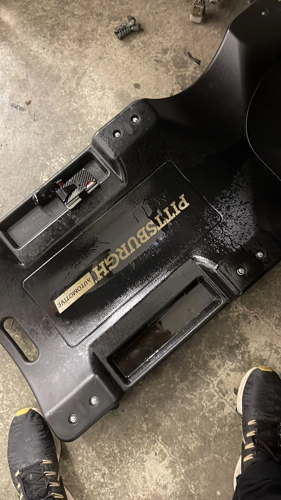

That feeling. I finally got the harnesses all plugged in. Let’s turn the key to see what happens. Only to realize you put the fuel return line on the wrong place.
