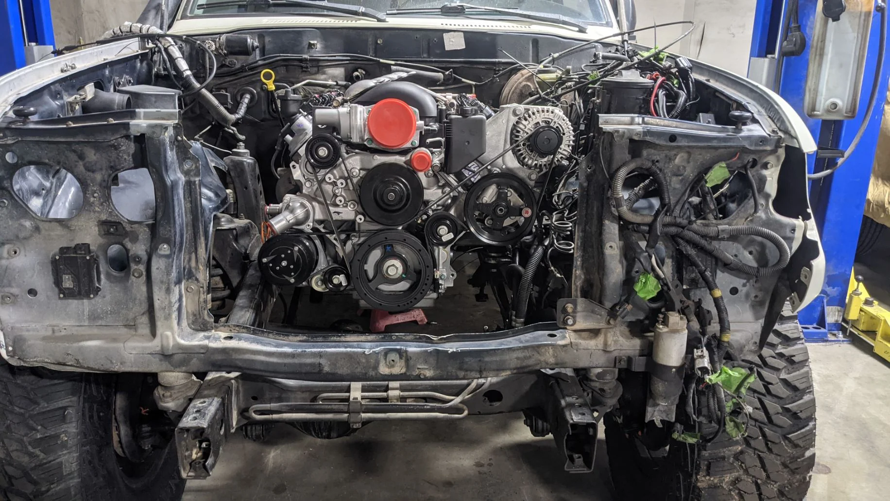

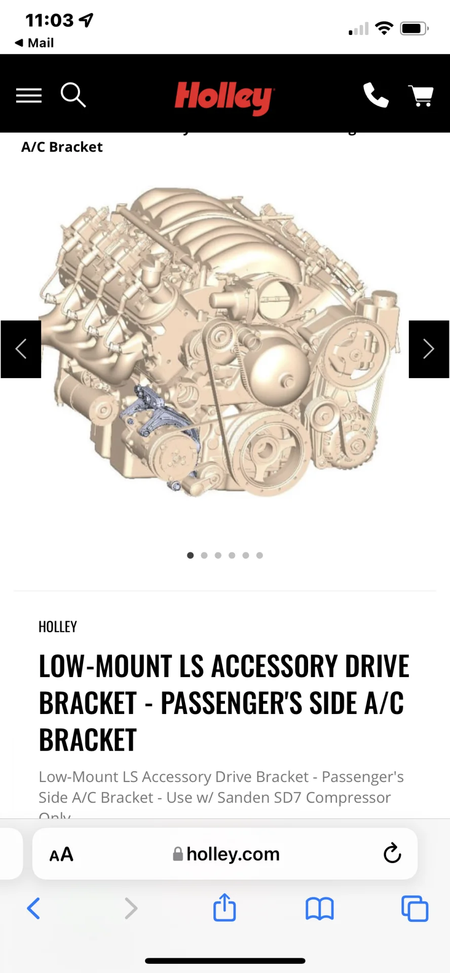

This might be what I have to switch to. The High Mount kit came with my motor and the SD7 compressor. I’ll have to look at it more closely. I forgot how much smaller that SD7 is. The oem compressor was going to have issues.
Oh wait, I thought that was literally your air compressor. I glanced and immediately thought it was a York. Not your AC compressor. Yeah, that needs to be moved.
The ac bracket is a holley high mount with SD7 compressor. I just ordered the Holley low mount.
Are you going to have interference issues running your alternator out that far? Seems like you could use a shorter bracket there too and avoid running really tight to your battery box.
Pretty sure I am good on the Alternator. I’ll throw the battery box in place today and check though.
Why not just run the truck accessory drive and intake that is completely free and works in an 80 like it’s designed for it
