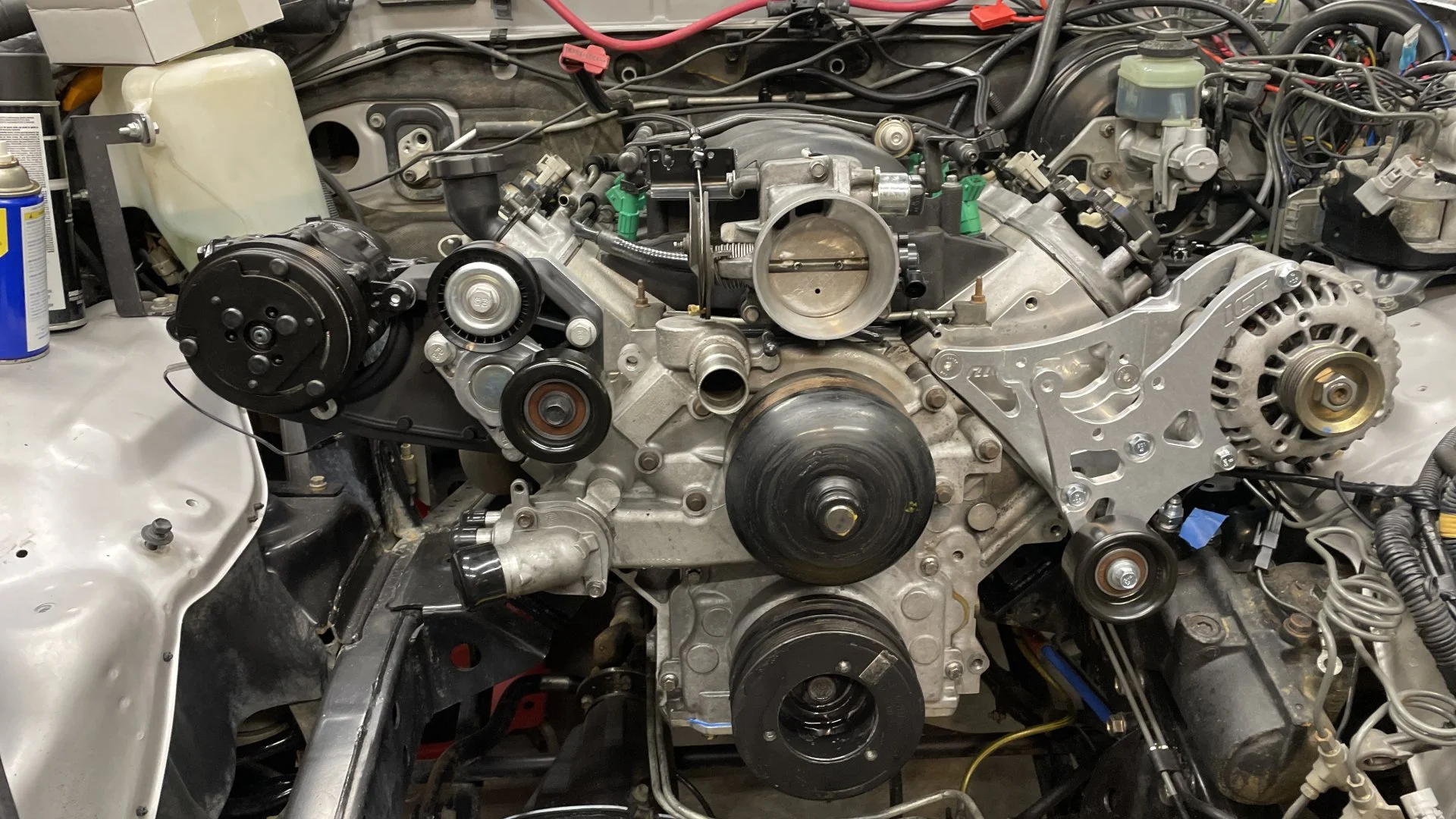

My air compressor location is going to make air filter location interesting.
Seem to remember there's a front drive setup that'll let you run the compressor down in that big gap next to the balancer. Would give you a lot more room up top.
Cool. I have a York that I’ve almost mounted there a few times. I have plans for a different kind of compressor to sit about right there in near future though. :grinpimp:
What bracket is that you are using? There’s other options that don’t have it that far out.
