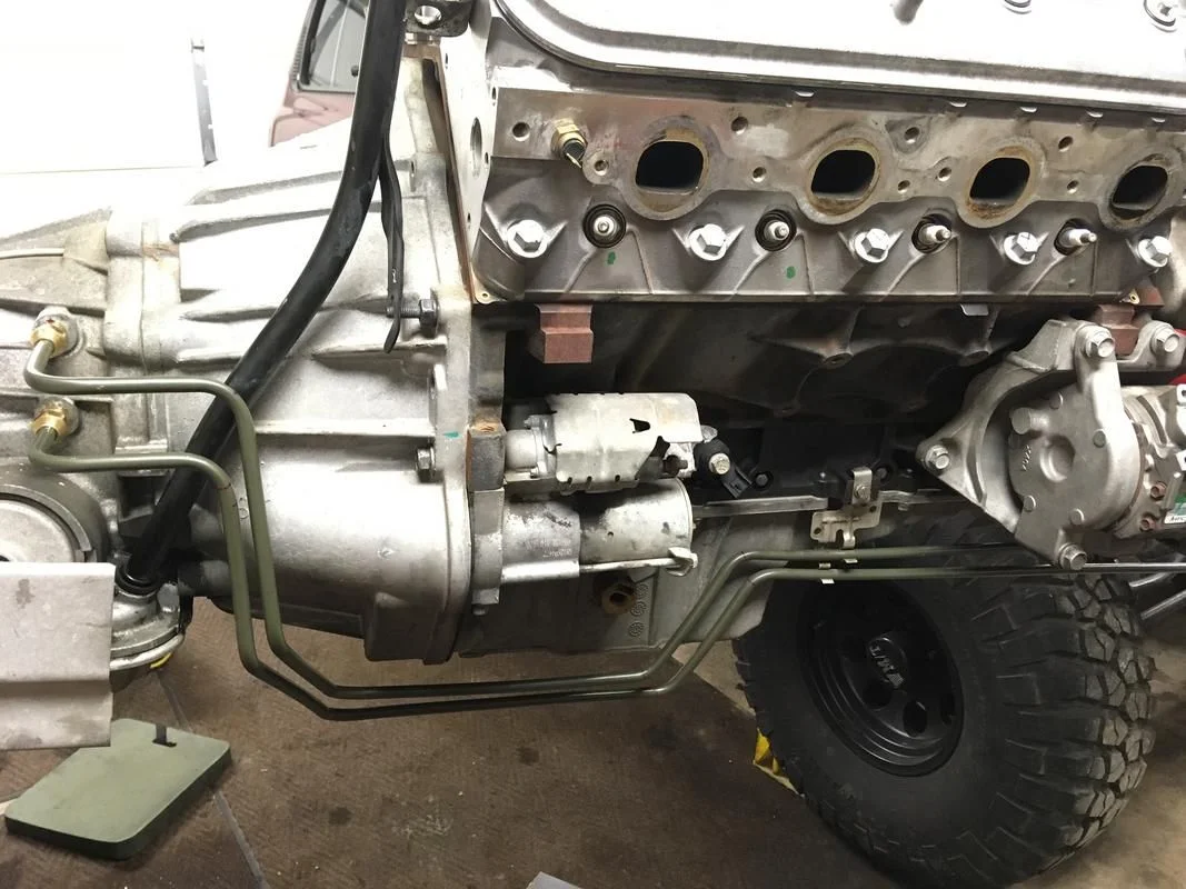

How are you guys doing your transmission cooler lines? I tried to use the original hard lines to at least get it to the front of the engine, but I can't find a way to make them fit with the new mounts and manifold.
I see lots of AN adaptors to connect hose to the transmission, but not sure that's the best route given that it's just a tube & hose clamp on the radiator end.
Is there a way to flare the existing steel hardline so it would hold a hose better? Maybe use that to get around the bellhousing, the run hose the rest of the way.

you make new line i used flare end on transmission side , you can get fittings in menards and at the end i used brake line flaring tool to make bubble flare end to hold hose

Firstly, I converted the trans oil cooler to AN fittings. The hard lines of the GM trans has AN fittings on it so then I ran ‘soft lines’ from the oil cooler to the hard lines.

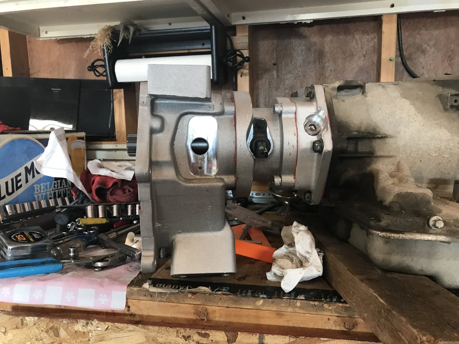

Those of you using the 4l60e 2WD transmission, does this look correct? Using all 3 pieces to the adaptor?
Mine didn't have that Allen plug on the top right, maybe an updated design? Make sure you red loctite all the adapter bolts.
I was just thinking the same thing. I don’t remember that being there either.
