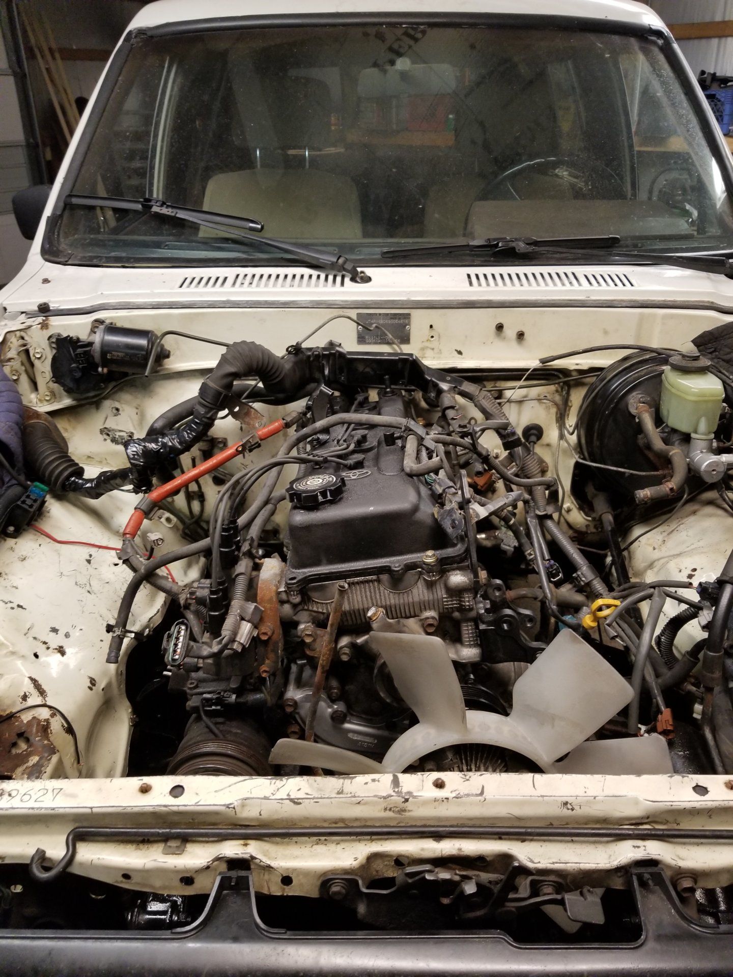

Motors in. It’s a smidge high in the front. There’s not much space behind the head. I might have to clearance a little firewall for the egr crossover and wiring harness is not going to clear the heater core inlet.

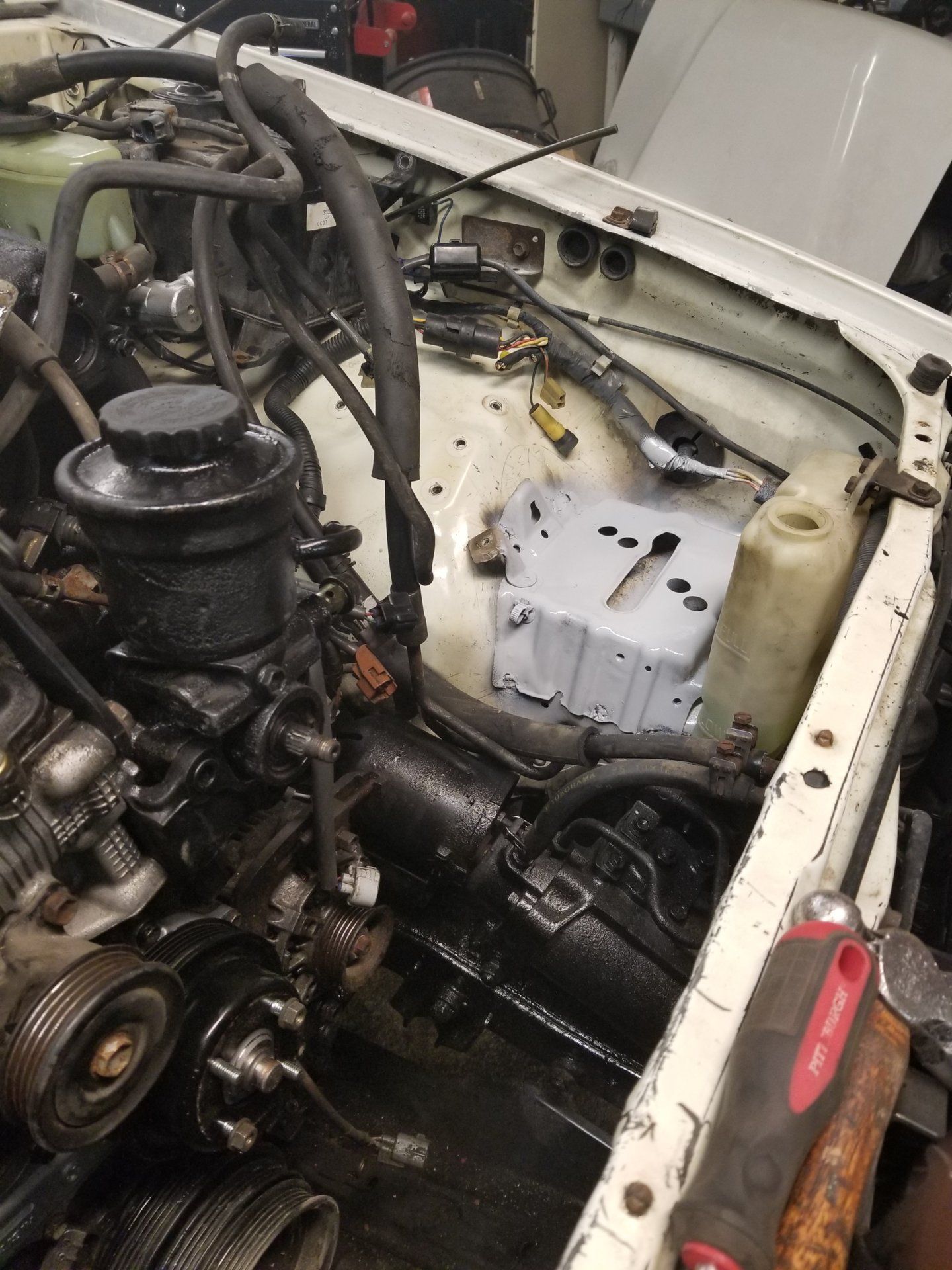

I drilled all the spot welds out of the 3rd gen battery tray. Looks like it’ll fit nice in the same spot on the 1st. Might drill out the 1st gen tray out too to make more room for the air box.

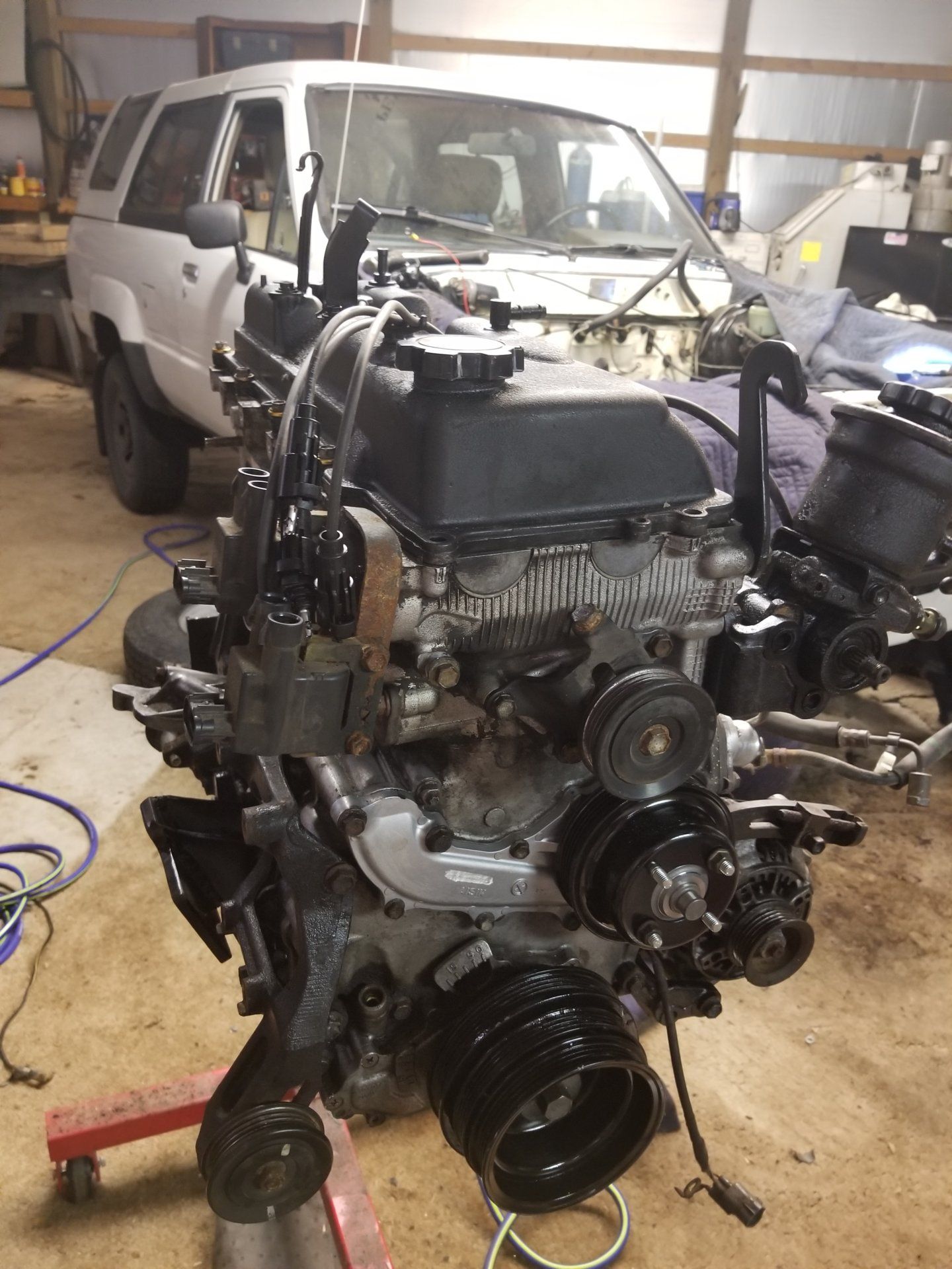

Bolted everything to the engine that wouldn’t be in the way of the motor mounts or bell housing bolts.
Toyonlyswaps oil pan showed up about 2. Drilled out the plug for the dipstick. Bolted up the pickup. Bolted up the pan. Drilled the motor mount for a bolt and boltied in the new dipstick tube. Kit did not come with a drain pan bolt so old bolt with new gasket.

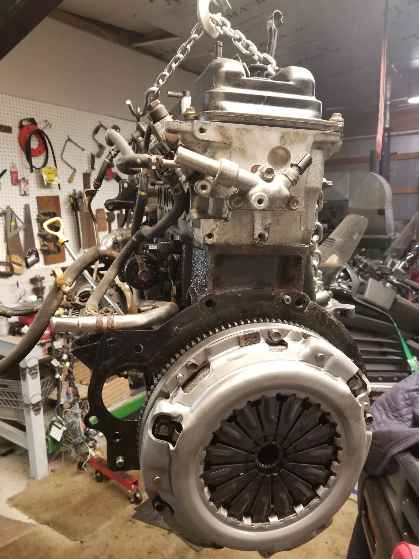

Pulled the motor off the stand. New rear main seal. There’s a plate on the 3rz between the engine and the bell housing. Can’t leave it off. New flywheel with new OEM bolts. New clutch kit. Pressure plate bolts to 14 ft-lbs. Pulled the motor mounts off the frame side to give some room and stabbed that bitch in. Damn I hate getting a clutch lined up with an input shaft alone and without a tilter. I thought I had one. Couldn’t find it.
It would have been way worse with intake and exhaust manifolds on.

Ideas stolen. Thanks. Question. Would the Gen1 tray work on the other side?
Ummm, so it's not just me. Lining up the pilot bearing sucks.

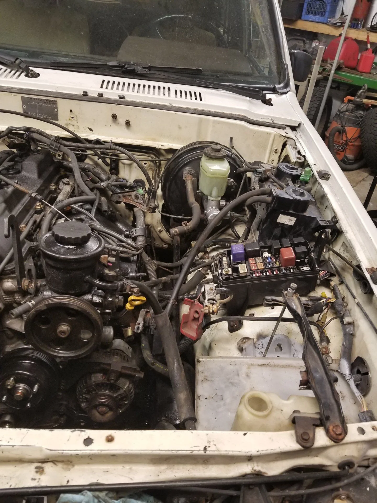

lots of little stuff in a short day. Welded in the battery tray. Found I’m going to need a shorter battery, but that’s easy and it looks clean. Drilled out the old battery tray. Still not enough room for the air box, but it fits really nice so I will probably modify the old air box and not just go with a cone. Bolted in the starter and looked where to put the 3rd gen relay box. It fits like it was made to be right by the battery. The tank vent canister fits nicely between the relay box and the clutch master.

Wire harness fits behind the head fine without the big plastic cover. Intake is really close to the 3rd gen booster. Heater valve might be challenging. I checked this morning and there’s no room to drop the front of the engine. It’s right where it needs to be.

Bolted on the lower intake. It’s a bit harder to get at the bolts in the truck, but worth it to not fight it when putting it in and way easier to do the wiring, starter and coolant bypass tube with it out.

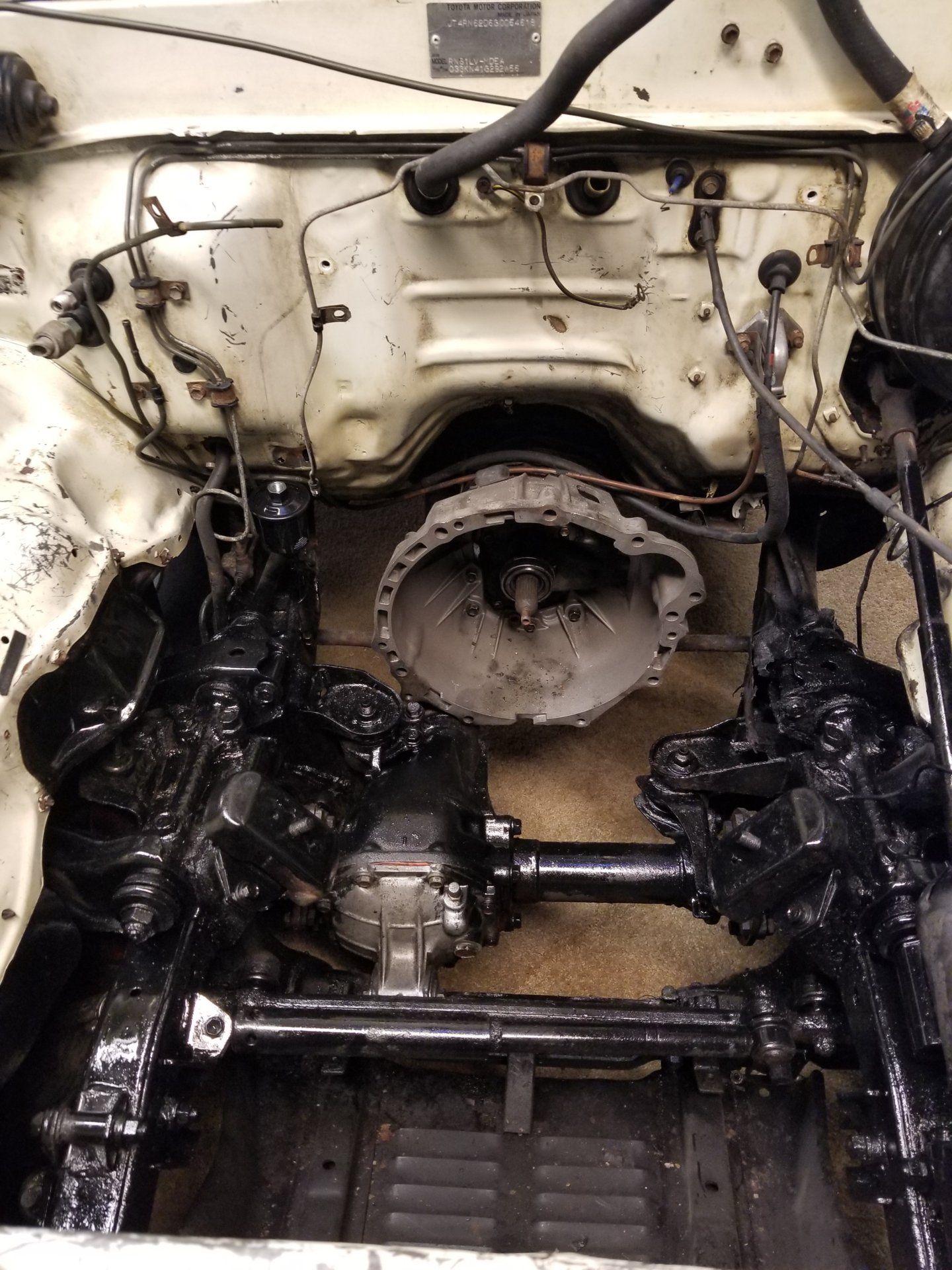

And the motor is back out.

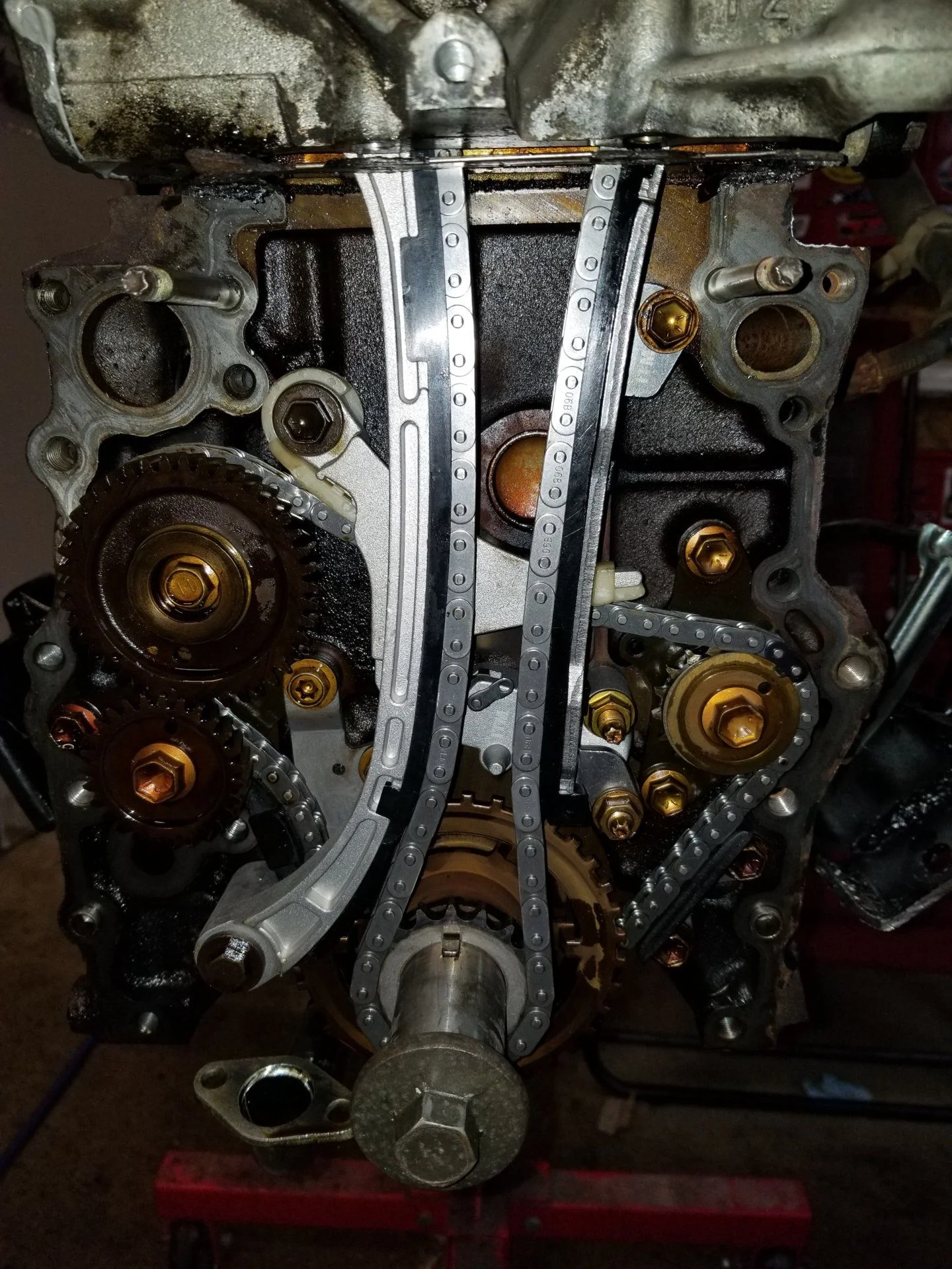

I went to turn the engine over and it wouldn't budge. The crank pulley had forced the oil pump gears into the timing cover, broken it and was pressing the broken part into the front of the main. When I installed it the first time I lined up the crank pulley, turned it with just a little pressure, felt it engage the oil pump. It slid in another inch or so with no resistance, then turned it until it lined up with the key and tightened it down. Something went kitty-wampus.
found a new timing cover used. Ordered a timing kit because it's apart. There is some minor wear on the guides. The process for measuring the chain requires it to come off, so I'm just going to replace it all. New oil pump, both new chains, both adjusters, all the guides.
sum bitch.
