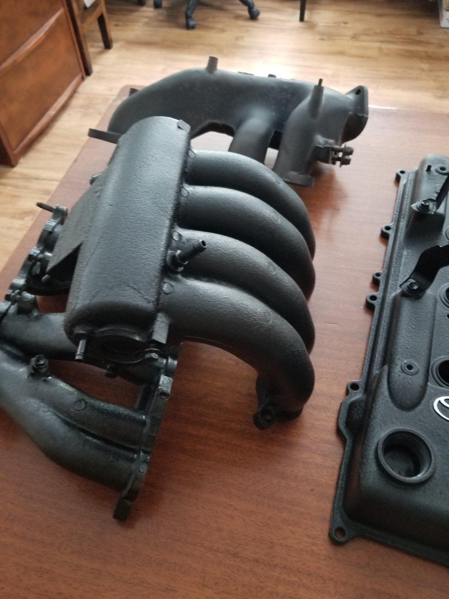

Taking stuff off the 3rd gen. I'm really struggling leaving the motor alone. I'm losing the struggle. Took the valve cover in to work yesterday. Ran it through the jet wash, baked it in the oven, ran it through the shot blaster, tumbled it, washed it again, blew it all out, painted it in wrinkle finish. Got a new PCV grommet and ordered PCV valve, and a gasket with spark plug seals.
48 hour wait time to handle, so Friday I'll file the paint off the T.
Took the intake off tonight to take in tomorrow.
Exhaust got shot blasted, painted with 1200 degree satin clear. Cured it in the oven so hopefully it'll last. The heat shield came off in on piece too, so it's not like it'll be visable at all.
Intake got washed, baked, washed again and then painted with the wrinkle finish.
