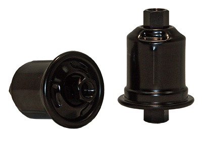

So the stock fuel line fitting is 14mmx 1.5. Nobody seems to make a 14mmx 1.5 union to put the stock fuel line together with a piece of store bought steel fuel line to extend the line from the right to the left side of the engine compartment. A compression fitting would probably work with 35 psi, but it's near the exhaust and a leak could be catastrophic.
But a number of fuel filters have a 14mm x 1.5 inlet and outlet. having an extra fuel filter that you can actually reach wouldn't be a horrible idea.
Wix filter's page has an application chart. Catalogs
The 33625 is the smallest, but is for a Geo Storm and wasn't available at my local NAPA. 33236 is for a 00-05 Toyota and was available, it just has a goofy shape that might not package as cleanly.
Are you looking for something male x male, or female x female? For male x male you could make something from tubing and nuts. For the female x female, the short hose that runs from the top of the tank to the frame might work. At least that was my thought for a solution.
Edit: I was considering relocating the filter to the passenger side frame too. Where the 3RZ filter is now is about as silly as where the 22RE filter is located. My thoughts were to route the fuel similar to what I did on the 2FE in my FJ40 ... hard line along the passenger frame, hose to filter mounted on frame, OEM 3FE hose to hard line that runs behind the valve cover to the manifold.
The only difference is the exhaust manifold on the 3RZ. But, I have an idea on that too that I will evaluate once I have the engine.
I found a 5/16 line and compression fitting to be the same size after removing the factory coating on the Toyota fuel line but I understand the worry. I was checking my compression fitting constantly for about a month until I finally felt comfortable. I may have bought something like this Fuel Line Repair Kit but in the end I think I used the Taco line and only the 5/16 compression fitting from the kit
Female on both ends. A union would have been perfect, but not easily available.
I bought a new filter for under the intake. They are supposed to be lifetime, and probably will be with a 2nd filter upstream. The one on the frame rail where the rubber hose used to attach to the hard line will get changed regularly and I can forget about the one under the intake for many years. It has the banjo fittings I need for the fuel rail and a 14mm female for the other end of my hard line.
I used Braided SS and AN6 fittings to replace factory soft fuel lines. I had to relocate the fuel filter to passenger inner fender. Used compression fittings on metric to AN6 at filter.
