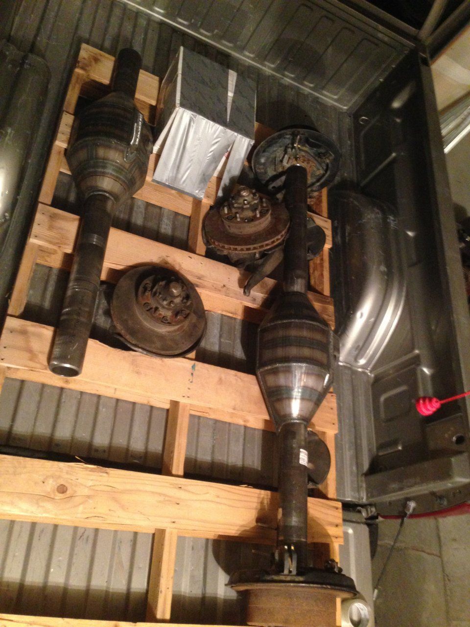

Dem thar'd be the intended diffs that mi amigo, AlbertoSD and an amigo of his drove ten hours round trip to procure.
Mucho gracias, Señor.
What does the class notice about those bad boys?
Answer:
There's no dial. :)
Commendations are also in order for me mate Baz from down under.
Dood's successfully tracked, hunted, and bagged some of the rarest unicorns on earth, on a previous expedition, sourcing not only the rarest of rare split case parts, but in NOS form.
Most recent monster, one point buck kills include two H151Fs, one H150F, two HF1A mechanical cases (yeah, that'd be those with no electric motor) a free ECU, free wiring harness, and free engine mounting brackets.
