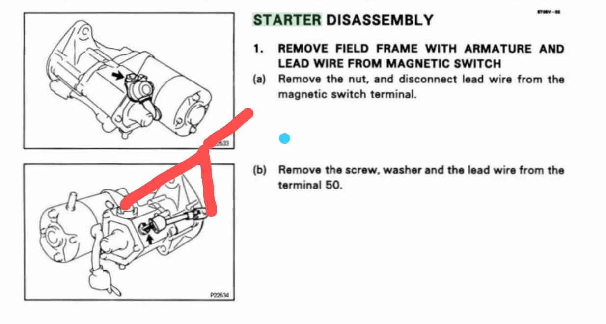

Also narrowed the problem down to the solenoid connection after giving it a 12V Jump on each battery individually and observing the 12/24 Switchover Relay closing but no crank from the starter.
Will try to get it out and test it or hot-wiring it is something that someone else has also suggested. End goal would be to get it to the 12V setup.
Trying to get it to start for now
Car is still not cranking.
Hot-wired terminals on starter from solenoid to motor, was able to give it power. Heard starter screech but no engine turn (see video)

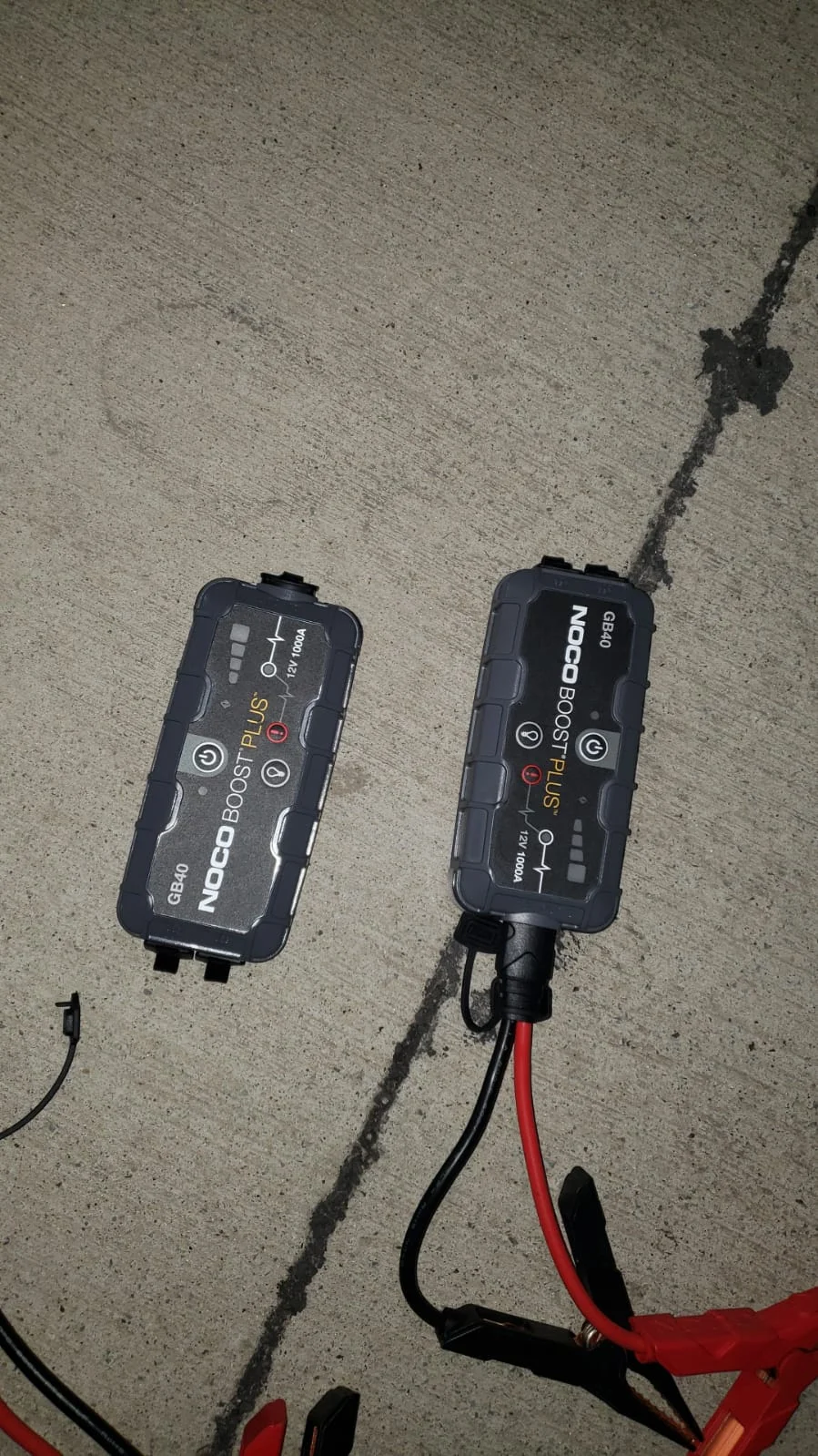

Using 1000A 12V Jump starters to supplement the car batteries (see pic)

Voltage
Voltage spike on crank at change-over relay- ok (~18v)
That's very low.
Test voltage at each battery as you crank it. You should have 12ve + on each battery under load.
The 24 volt start system has a habit of killing batteries prematurely IMO.
If one battery is weak, the other will try and compensate

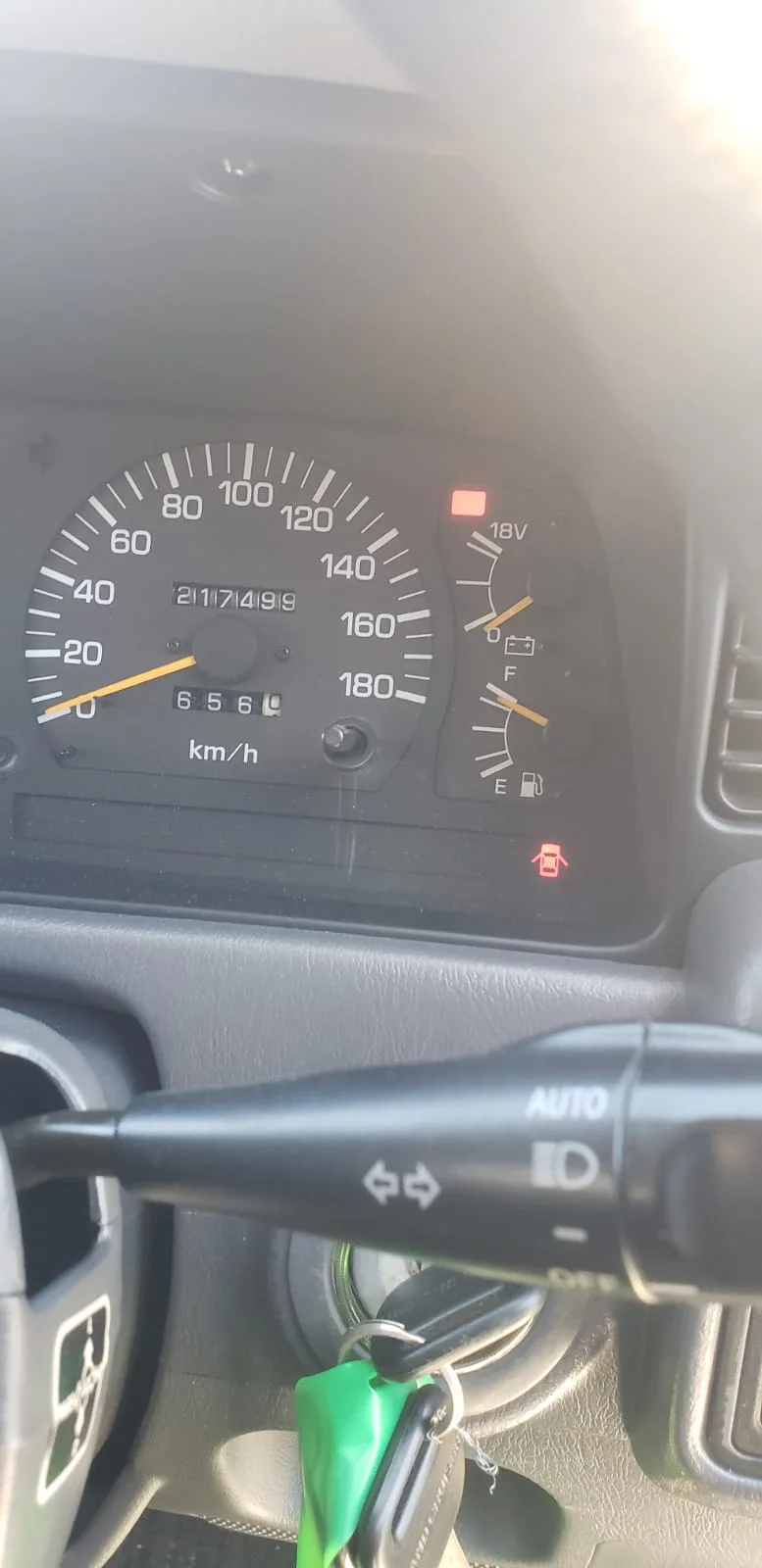

There is continuity from ground terminal to body for both batteries. Battery light is on and not showing any charge after replacing brand new batteries

The 24 system eventually kills batteries, since they are unequally loaded. I had one drop a cell, so that it showed good voltage, but couldn't supply enough current when asked.
Start simple.
Fully charged batteries
clean tight connections
Check your Gauge and IGN fuses.
Check your fusible links on the RHS battery
Check that the start relay (LHS guard) in the engine bay clicks when you try to start it
Also ditch the 24v starting system ASAP. The 24v starting solenoid is a known failure point on these trucks. I did this and truck starts on 1/4 turn of the key even when cold. Also gives you a home for a house battery and gets rid of several 25 year old cables.
