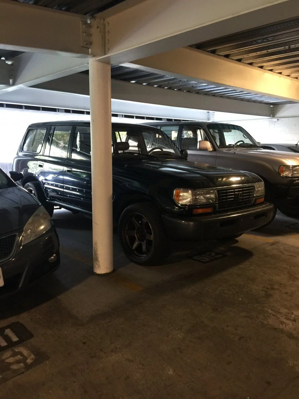

Well didn't quite get what I wanted but I am not going to mess with it more right now. Each time the shop takes the springs out and puts them back in costs me about $400, so I am going to be content with where it sits lol.
Initial measurements
Front tire to wheel well - 5.25"
Rear tire to wheel well - 6.25"
After measurements
Front tire to wheel well - 3.5"
Rear tire to wheel well - 4"
So 1.75" in the front and 2.25" in the rear. I was shooting for 3" all around but this will give me a little more up travel in the front. Not a bad thing.

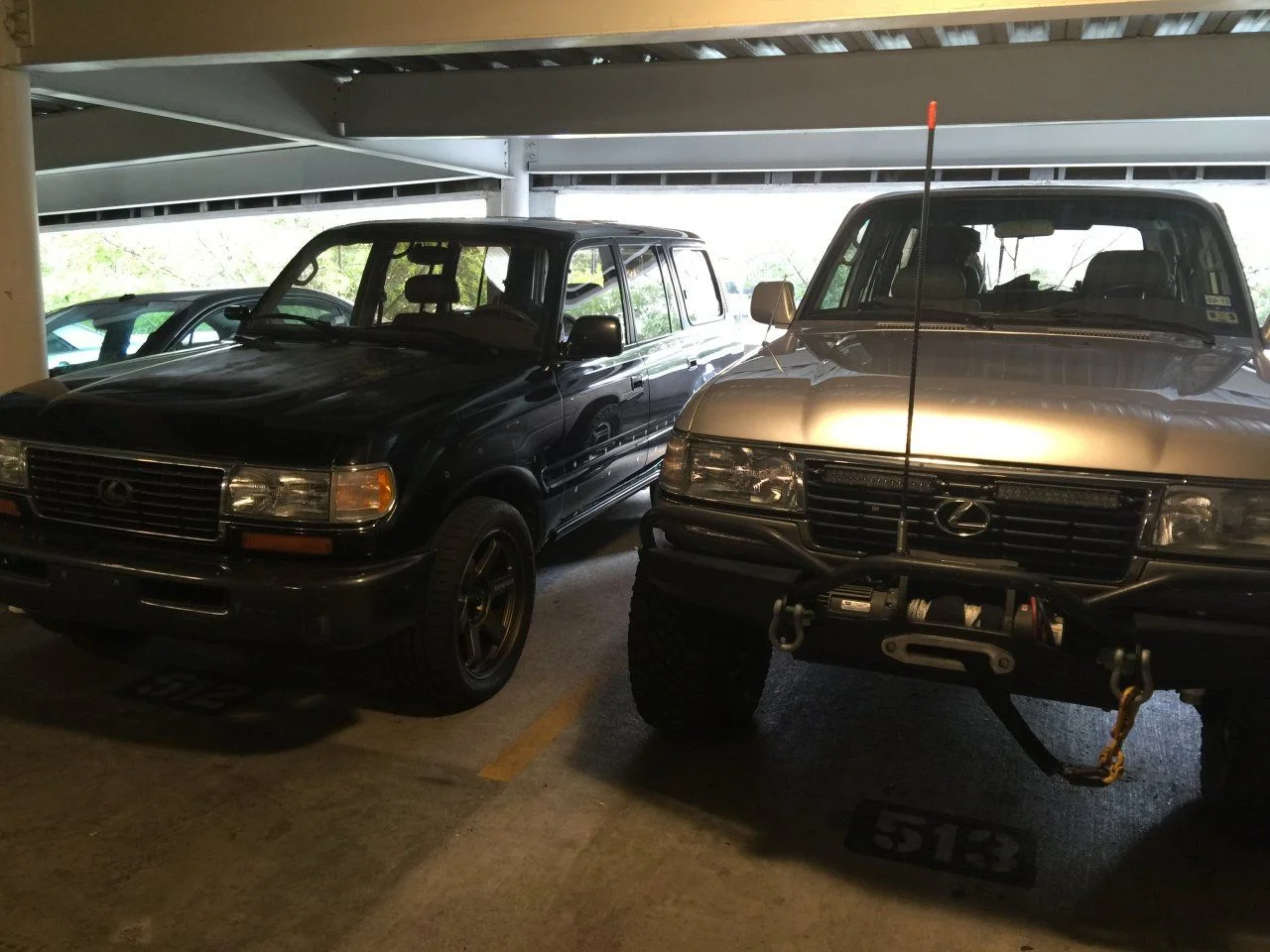

I'd run it and see if you get any settling looks tiny next to your other rig. But out in yhe open I'm sure its a different story. The real story is how does it drive? Higher spring rate large heavy damping. I'm sure its a different drive.
Yeah and my other truck is very small by mud standards. It is a 2.5" lift with 35's. It actually looks pretty small in general. I did my test drive and stopped to grab dinner I parked next to a current gen RAV4 and I think it might actually be shorter. lol
It does handle very differently! The old on-ramp that is a long sweeping right hander in either the grey truck or the black truck when I used to take it at 30mph I could watch the right front of the truck come up. Now it is flat as can be and actually I can accelerate through it. ha. The ride is about as rough, maybe just a little more taunt than my truck on OME heavies.
