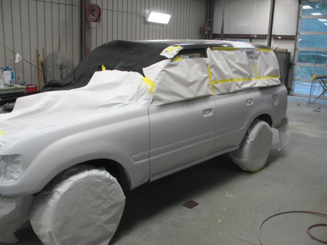

Holes patched and first coat of primer down before any real body work starts.

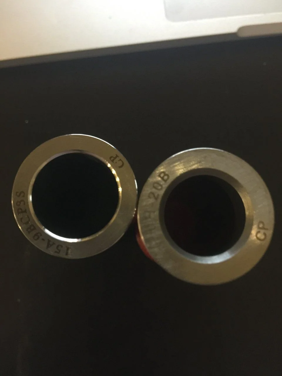

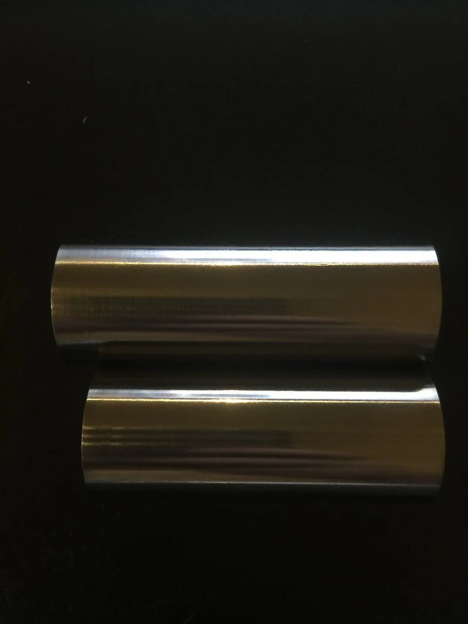

So after getting ahold of CP and showing them photos of their piston spec sheet and pictures measuring their wrist pins to prove that they do not match. I finally got them to agree to send me out new wrist pins. Awesome! Well they get here today and I am excited to get them opened up. And ugh they sent me the cheapest thinnest (0.165") pins they offer in that size. Knowing I upgraded my pins (0.220"), knowing my power goals and the fact I ordered the strongest rods they offer.
So I guess I am done with them. I am not even going to fight with them any more. I will just eat the $180 cost to buy H13 pins from Trend. But really when did companies just start turning to s***. They sent the wrong pins out, completely wrong dimensions. I offered to return them, (off the shelf part) and then they agree to fix their mistake and their fix is sending me pins that would likely not hold up to the load. :mad:

I am not even going to fight with them any more. I will just eat the $180 cost to buy H13 pins from Trend. But really when did companies just start turning to s***. :mad:
Sucks, but I see no reason to take the high road and eat the cost, smallish as it may be. Hold them accountable and maybe they see that it matters to get things right.
It kills me to see crappy stuff happen to you on this project. It's ground breaking stuff and has been great following along but easy for me to say keep going when it's not my money. But, for what it's worth, keep going!
Yeah it was such a fight to even get them to send these, even when it was clearly their mistake. I will just order exactly what I need from Trend Performance, they gave me 2 options first option was H13 tool steel $34 and 217g per pin, second option was TP1 steel $125 and 185g per pin, sooooo I will be going with the first option unless there is a rich sponsor out there. haha. They are even stronger than the 0.220" 9310 steel that I ordered from CP, so with these pins and Carillo rods, I should be good for 275hp per cylinder. I will be adding nitrous at some point. haha.

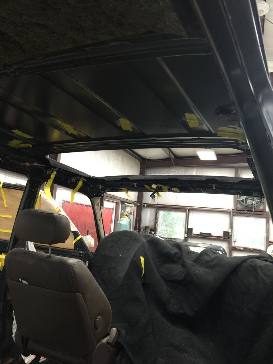

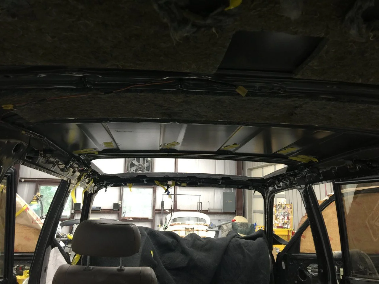

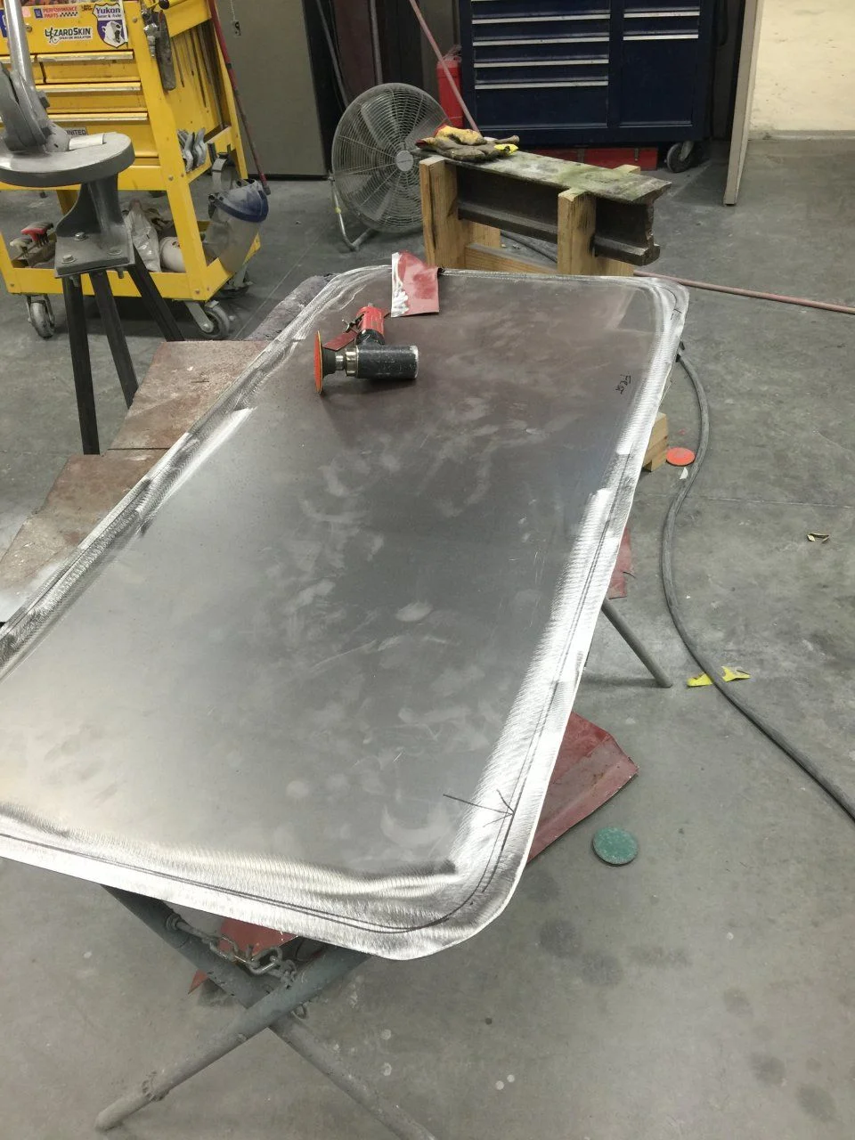

Sunroof is out. New panel is shaped and should get welded in maybe tomorrow. Looking at maybe Friday or next week to lay down the Tuxedo black.
Dang, they're moving fast!
