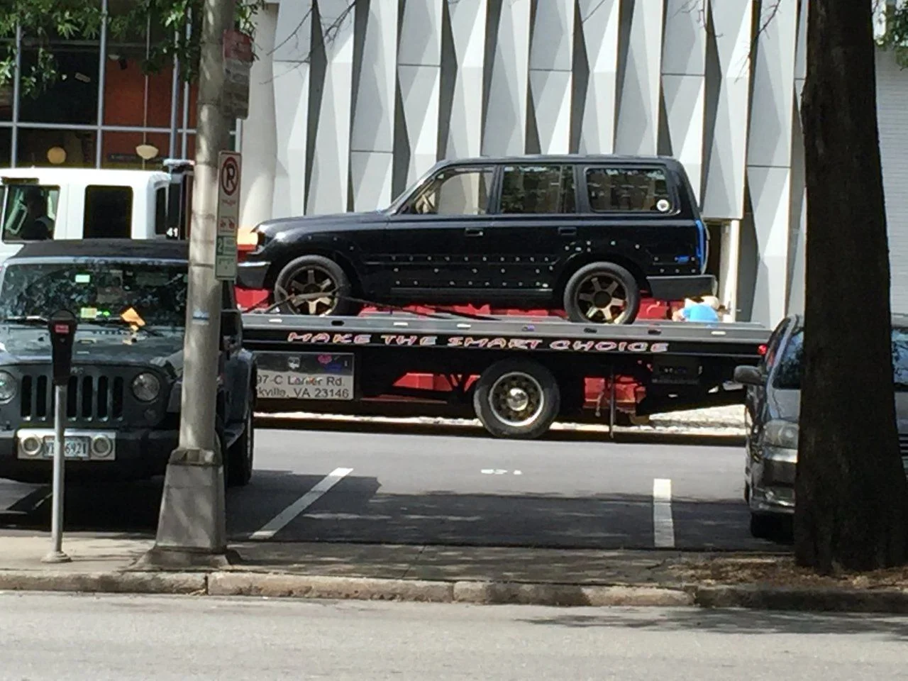

There she goes, off to paint and body!
That thing looks f***ing awesome. Maybe a little bigger tire one day? or a little lower? Though it could settle.
I', surprised the shop that built the Matador didn't laugh at you when you told them what you wanted done...
Just looking at the shot of your truck on the flatbed I can see why you were interested in poverty pack rear bumpers. It would look nice if there was a way to tuck that thing in but still retain a clean, simple factory look. Either way, it's gonna be sweet.
Trust me I have been racking my brain to find a tire that is any bigger and not an all terrain. I am running a 295/40 20. The Jeep SRT 8 runs a 295/45 20 in a Run flat that is about $530 a tire. In a 305 and 315 they are only 30 or 35 series so they are actually shorter. There is a General Tire in 295/45 20, but I don't really like the General brand. The original plan was the custom 21" wheels but when Volk/Rays came out with TE37 Ultra's I thought it would be a cool Japan homage. I have been looking all over, I was even thinking if I could find a drag radial I would do that, but Nitto, M&H, Mickey, nor Hooser make anything bigger than a 29" and the current wheel is 29.2" so I will keep an eye out but as of right now this is about as big as you can go given the performance tires out there.
I think I will get a little more drop once I get the interior and everything back in. But with the 80 series if you run your hand under the front fender you can see there is no place to tuck, the top of the fender is at the wheel opening.
And like you recommended earlier I would love to do like a 3" chop, but just is simply not in the cards. lol
Yeah I think once everything gets 4 coats of Tuxedo black it will blend a little better, not custom but better. :)
