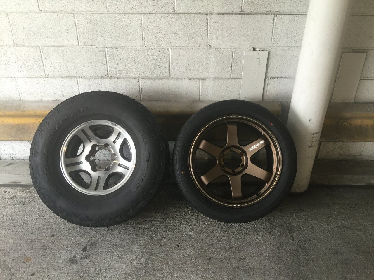

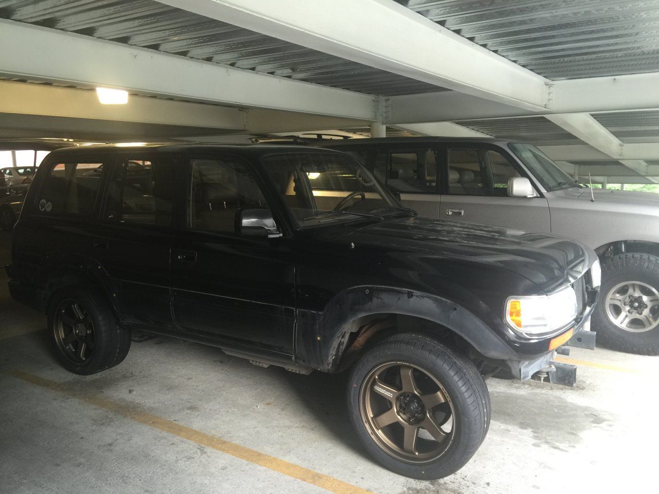

Oh s*** what have I done??? Haha!! It definitely looks better in person but it definitely needs that 2-3" drop and a serious cleaning!
285/75 16 vs 295/40 20

It actually looks good as s***! I can not wait to get the suspension and paint done!!! Just wait. Lol
Love the Black / Bronze combo, just heat the springs for instant gratification!
or you can just call up the whole neighborhood for a quick load on the suspension
Haha no I will wait and do it right. Still waiting for the custom shocks anyways so can't be in too big of a hurry, but once I get the paint to shine a bit and get the filth off from underneath the flares I will get a real picture.
