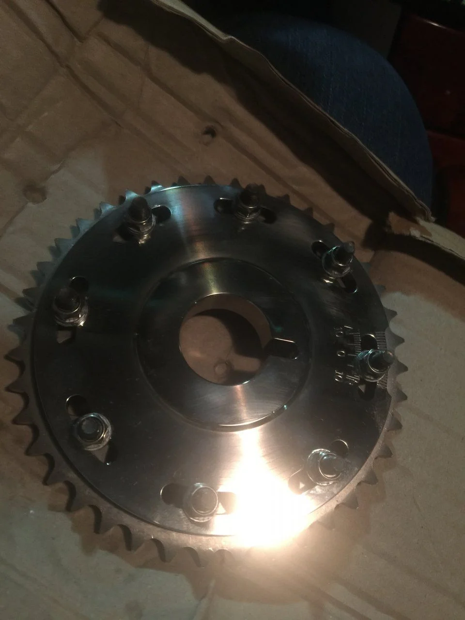

Well I have been talking to Headgames, they are big in the Supra world, they have a lot of credibility with race teams etc. They feel like the head work that I want to do is excessive for the "small" amount of power I want to make. They said 1100hp could be done on stock valves and cams. They told me they just did a Nissan TB48 with stock valves and cams for for Al-Anabi racing in the Middle East and made 1200hp.
So I am a little stuck. I have all the parts for a killer upgraded head but I also have a very well known shop telling me not to waste my time. But better flow would mean more power at less boost, less boost means less heat, etc.
After looking at MS75's head flow numbers after a porting it only makes sense
Since you have the parts for the upgrade already, I agree you would be better off using them. Really cool to know that kind of power can be made on a stock head though! Temptation grows for my own turbo 1FZ-FE!
