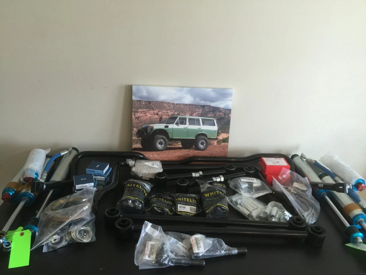

Ryan's "handling kit" haha.
Whiteline swaybars F&R
Whiteline panhard bushings F&R
Whiteline radius arm bushings F
Whiteline solid lower trailing arm R
Whiteline adjustable upper trailing arm R
New tierods and connecting rod ends, Front and rear axle rebuild kit with new bearing, and other cool stuff via @beno
1* camber bearings and new stainless brake lines from Slee
Custom King's with a 14" F and 13.6" R compression lengths
Not pictured cut OEM springs. lol.
Other thing I really want to do before making any decisions about handling is get the steering box rebuilt.
Install should begin tomorrow!
Ok fail #1. King's front shock shafts are smaller than the rears. Rears are 0.875" fronts are 0.750" So my Eibach shaft bumpstops are not correct. I guess I can throw them on while I order another set. At least it is the fronts they are a lot easier to just unbolt the bottoms and fix. I wonder why they use a larger shaft in the rear? I guess weight distribution was 50/50 before I started taking stuff out and people carry heavy loads in the back but you have that big lump of iron up front. Oh well my oversight.

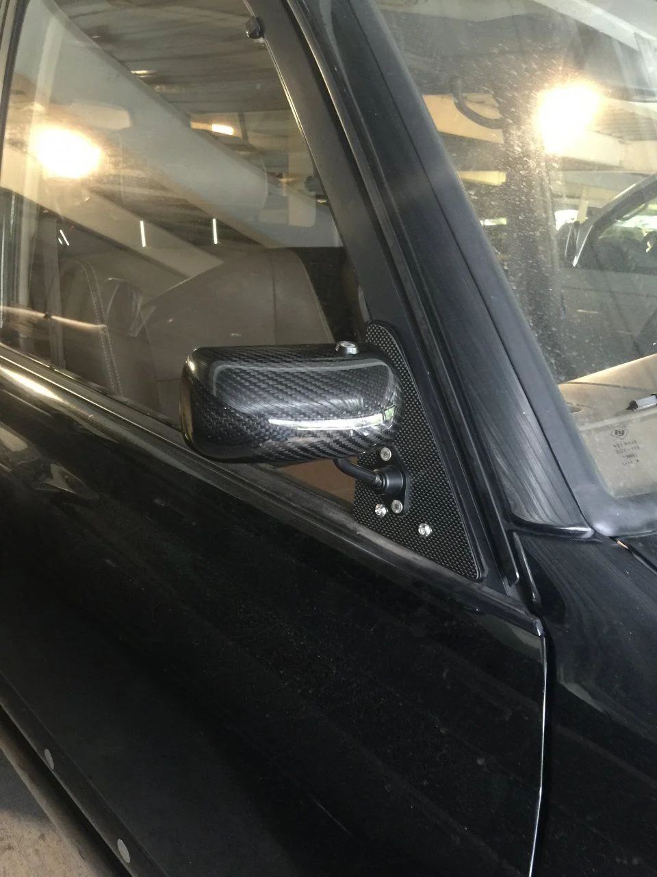

Just kind of goofing off today. I cut the mounting plate from a sheet of carbon fiber and mounted the APR carbon fiber mirrors. They are completely ridiculous but it's a 7lb difference between the stock mirrors and the APR mirrors, still using the stock mounting gasket.
I likeey, how does it look overall when you step back and look at it in its entirety?
I think it is going to look really good once I actually get things moving. I was given a lead on a shop to do the suspension stuff, and I should have gone to see them today, but I was messing with these damn mirrors. I will see if I can't make some time in my schedule to actually make some damn progress. I have all the parts, just need to make some headway. I even have all new weather stripping and belt line trim for after the paint. I am really excited to see how it comes together, with the solid rear windows and everything smoothed out. The only thing I have not been able to find that I really would like is a rear window without the defrost grid or tint, so that all the glass would be clear and I could put a nice tint on it.
