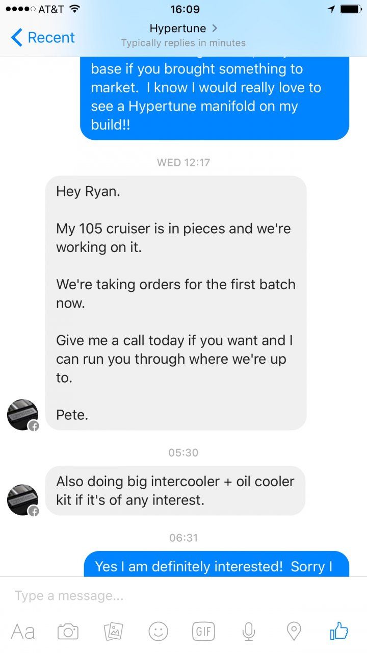

Sooo I took one more chance and emailed Hypertune, they are the ones that make those amazing billet intake manifolds for 2JZ's, RB26's, etc. Pete got right back to me and let me know his 105 is apart and they are taking orders!
Hopefully this is an actuality....
Their TB46 intake manifold so the 1FZ should look pretty similar just reversed!

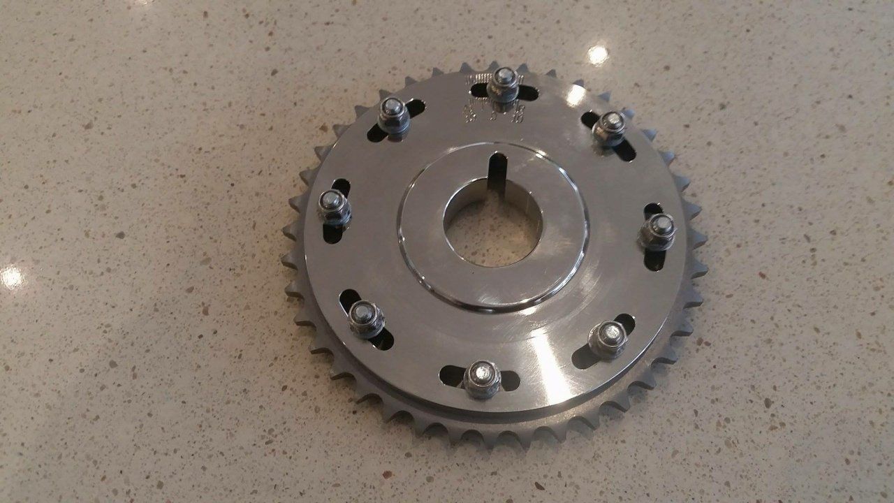

I also managed to pick up a set of one off, stainless steel adjustable cam gears for my new Kelford cams. They are also coming from Australia so that should be pretty cool.
