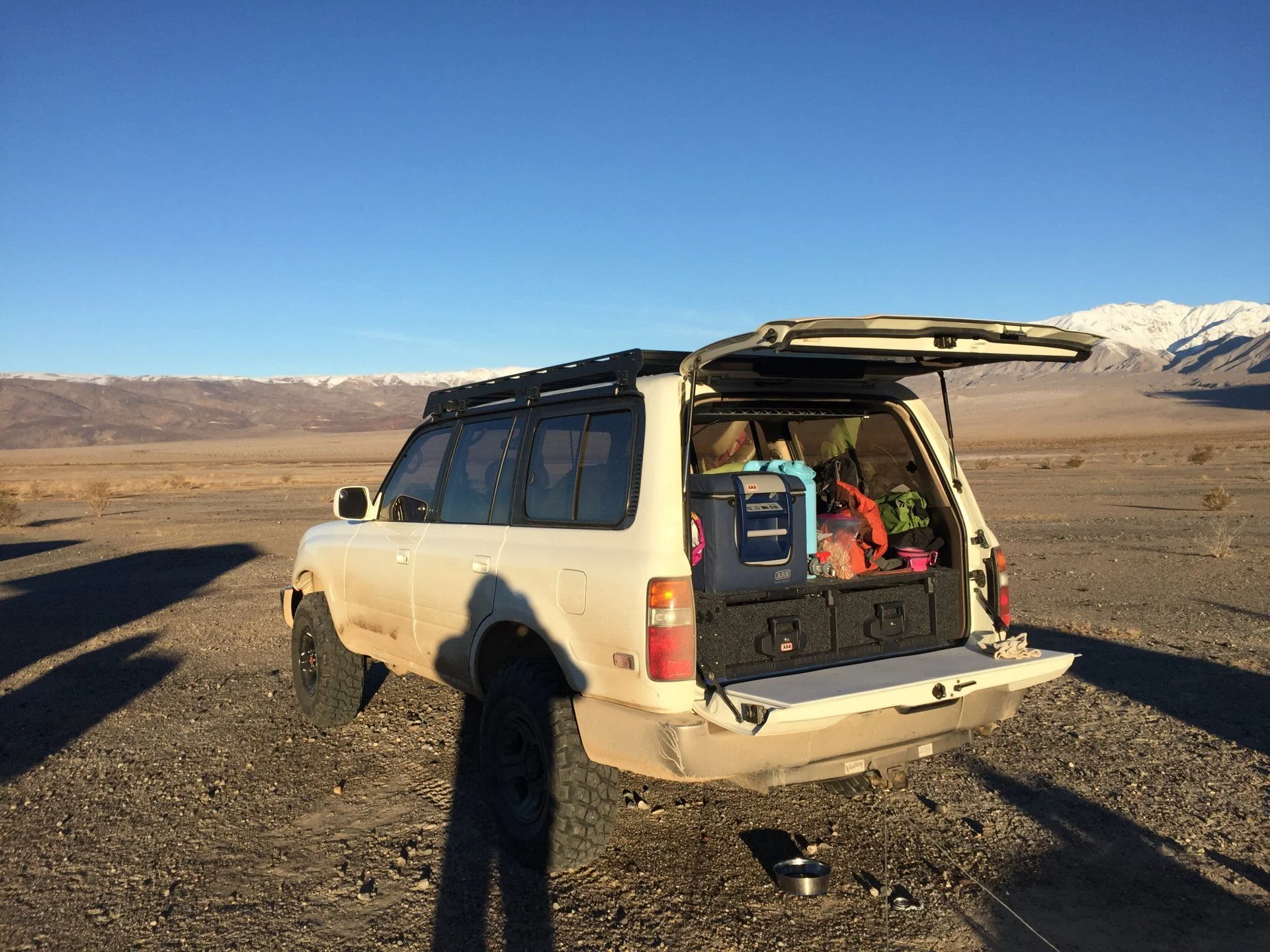

I finally got off the pavement with mine last weekend in Death Valley. Did some slow crawling and some faster washboards. I was really happy with the ride. No bouncing or harsh bottom outs. I went with the 50mm intermediate and it was a hair under $2k. I don't have anything to compare it to on this vehicle but I've had a number of other lifted vehicles in the past and this is the best riding setup I've had to date. Dealing with redline was a major PITA. I can't even count the number of phone calls I've had to make checking the status or trying to get the correct parts. I'm still missing the rear protective shock boots but I've given up. I'm just going to order a set on eBay.
