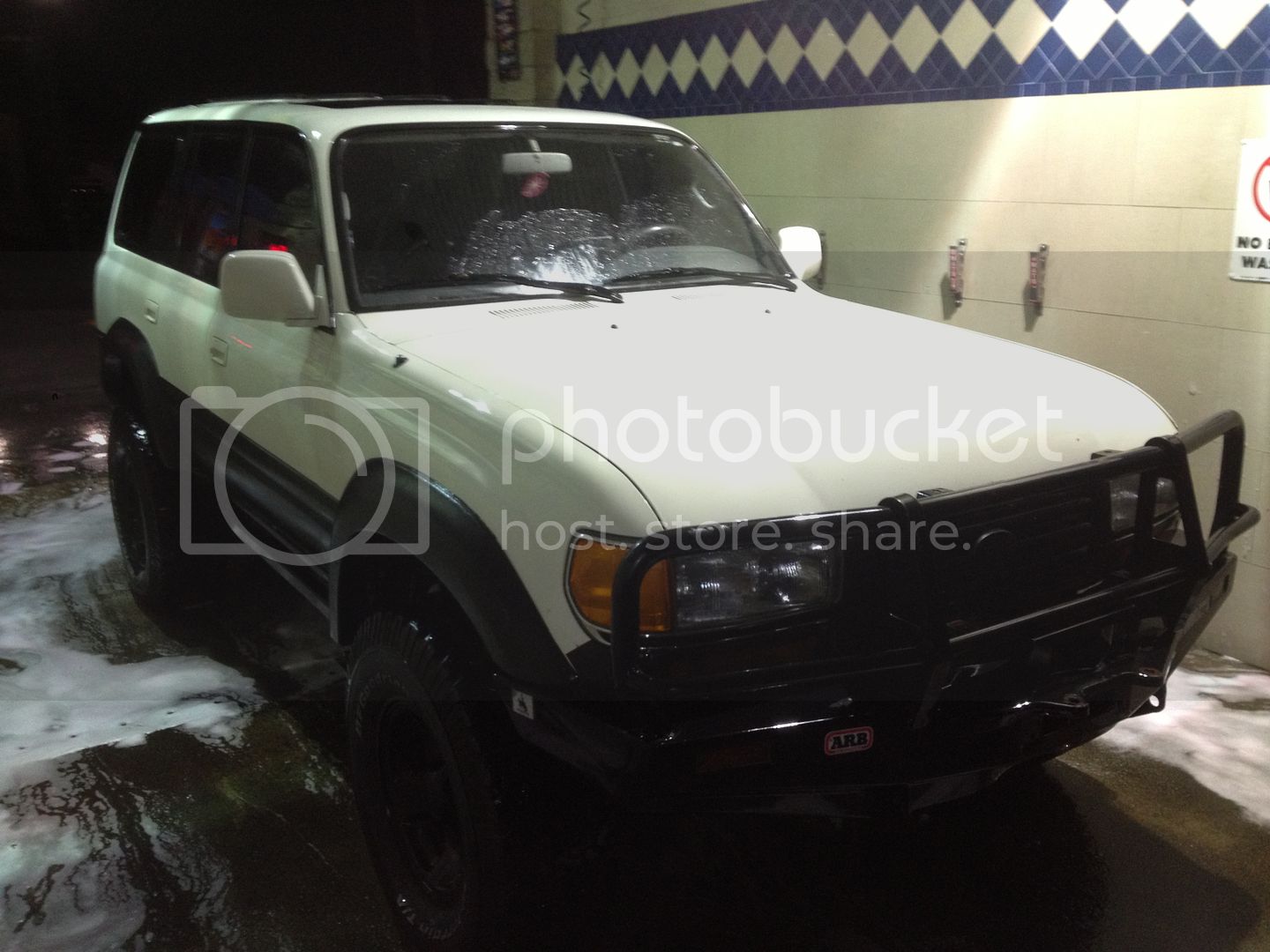

All I had to do them was give it a quick tub, and head for my road trip from San Diego, via Riverside CA toward Las Vegas for the night, [Thanks Ben] enroute to Slee Offroad.

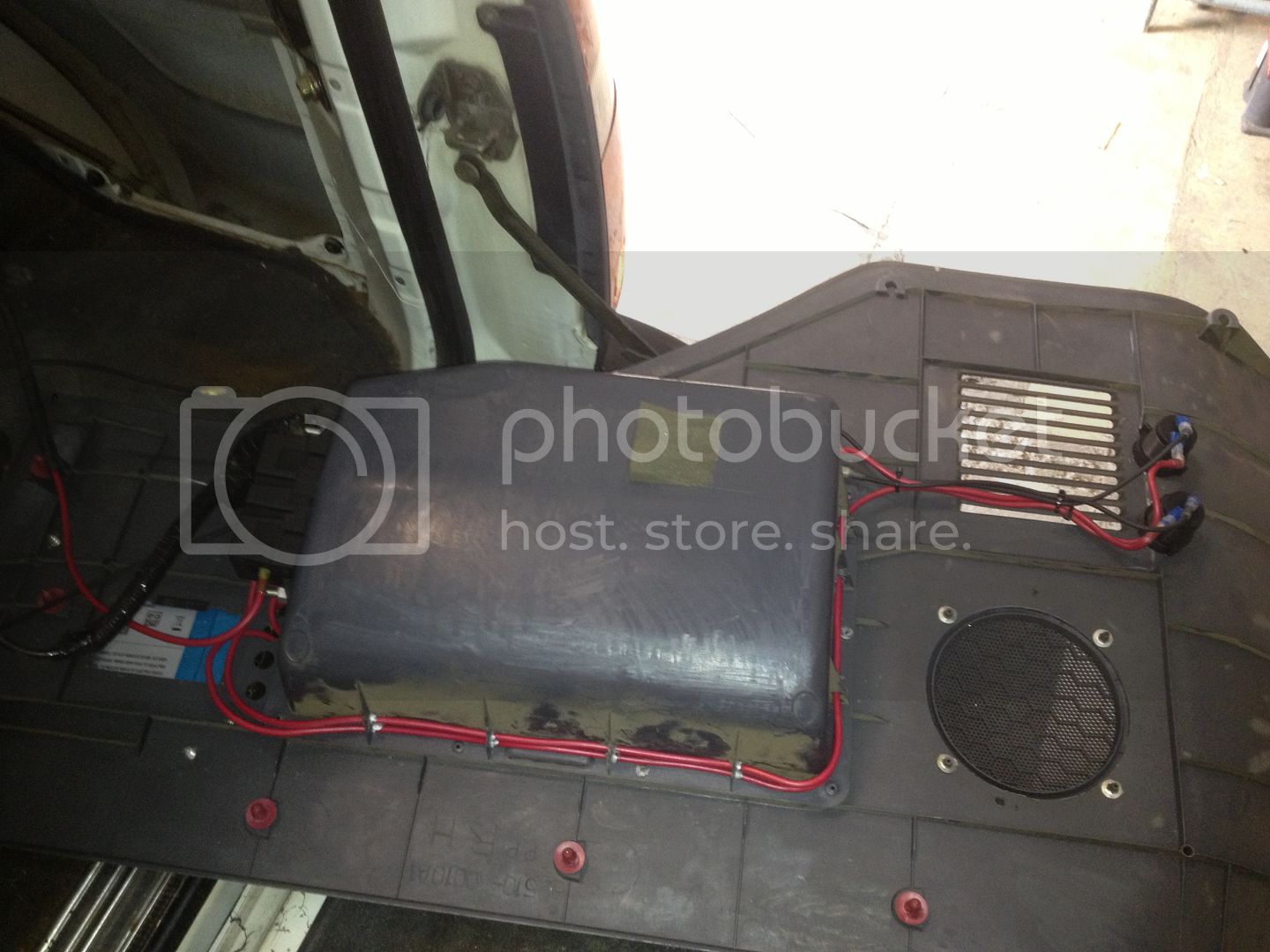

The winch being fed by 2 die hards, with new battery box, isolator, switch to join the batteries if required, and the washer bottle relocated with the Slee kit. [link switch for batteries mounted to box]
This type of battery with good plate mounting for anti vibe damage, and good storage are typical of what we use in Aus, for camping with fridge, lights etc, and make sure the vehicle will start in the morning.
All the dash extra charge plugs, rear accessory plugs, invertor, engel fridge, camp lights are wired to the aux battery, to keep the main from being drained, while in camp.

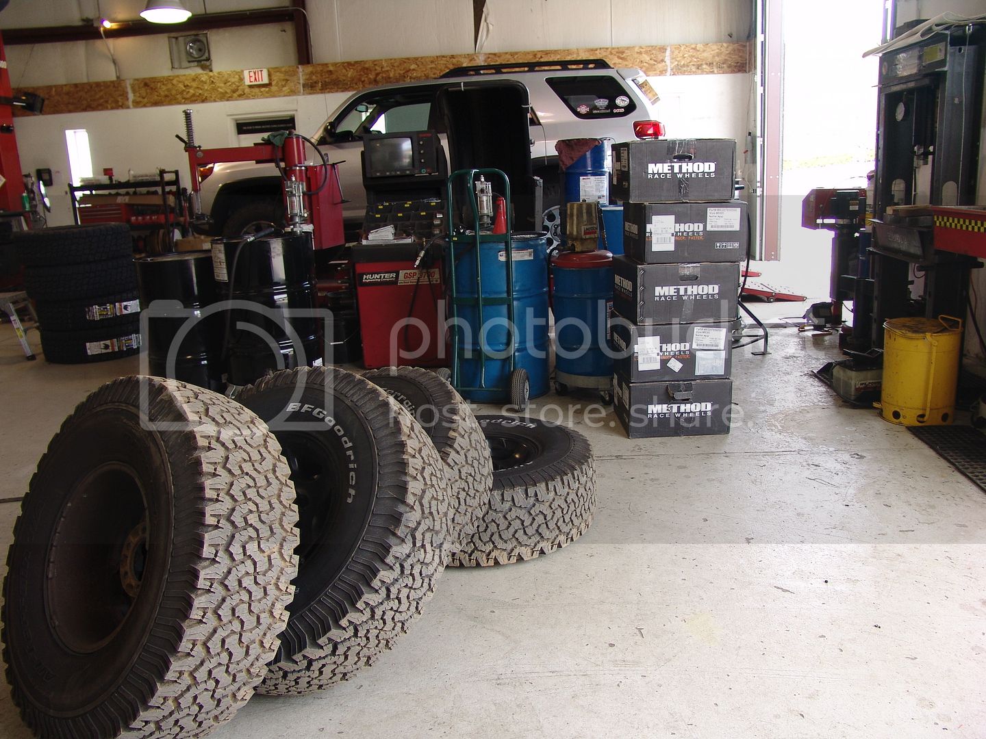

We also put some of these on, 17" x 8.5 to aid the driving/handling with 35's by slightly reducing the sidewall height, and prevent rubbing, with the right offset. This rim has a thicker inside bead, strong centre design, and will fit over aftermarket calipers with bigger rotors.
We went with this tyre, as it is an intermediate type tread, with good feel, and aggressive enough for the work this truck will do, when needed, square shoulder, for gravel handling, and turn in as well.

We use the Slee Offroad product in Aus, as well as the Nitro products from www.justdifferentials.com, and we also bring in the Method Race wheels to Aus, so it made sense to use what we were familiar with where we could, because we like the product, and in some things, like the tyres, and shocks, be able to test some stuff we dont have, at the same time.

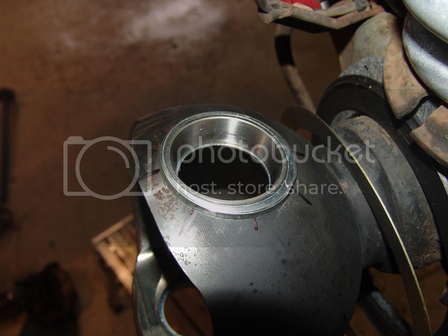

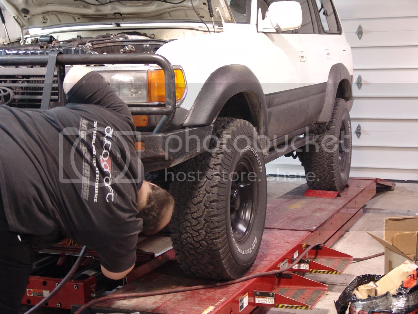

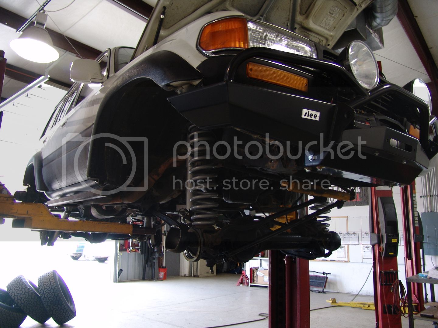

Will detail the slinky long travel suspension a bit later, but first we cut the front holes for more caster, some 79 rear bump stops to add length for the longer shocks, etc, and we ordered some parts from Nitro Gear to be delivered direct to www.sleeoffroad.com to be installed, rather then send them back from here.

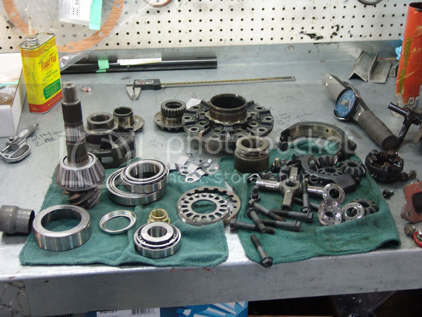

We fitted Nitro cro mo cv's, 4.88 diff gears front and rear, to make the drivetrain strong, with the factory locked diffs, and we sent over some 2 degree caster bearings over to dial in some negative camber, and add caster.

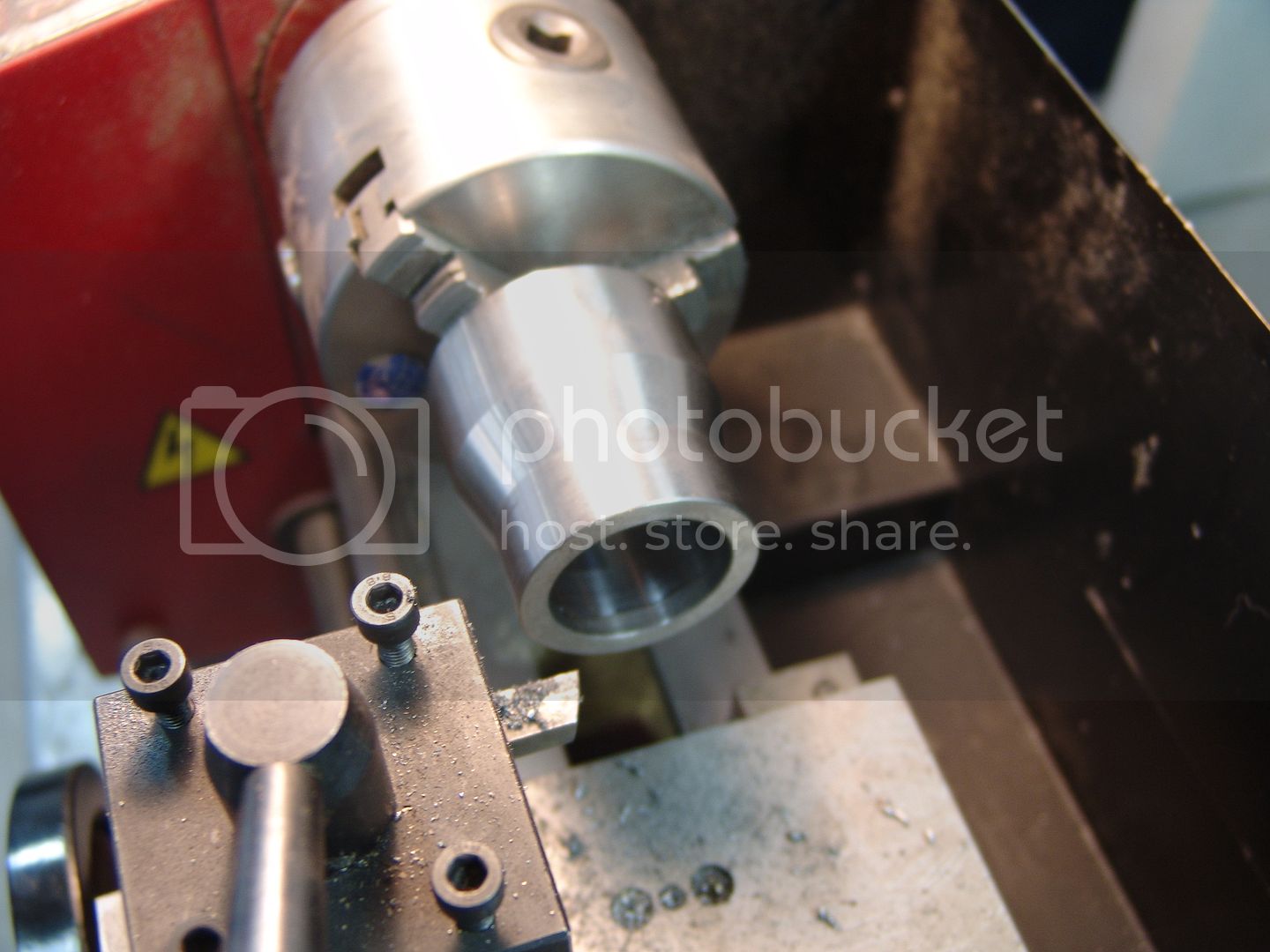

Slee Offroad then installed our solid pinion spacers for us,
These are a solid cnc machined part we do in Aus, to make the diff as strong as it can be, by supporting the bearing face fully each end, and without shims, being a solid lump, it cant spit the shims out, like most spacer kits people claim is a "solid spacer". . .
We sent over our solid pinion spacers to Slee be fitted with the Nitro gears, and rebuilt the swivels with the cv's, as well as repacked all the bearings for me.

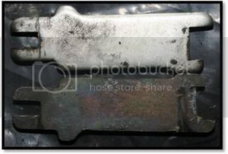

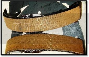

The guys also fitted our super duty hand brake shoes I carried over im my carry on, so the hand brake will work in an 80, rather than be a token handle. This can be a good tool to use on steep down hill pinches, in an auto, to maintain slow speed, and better control.

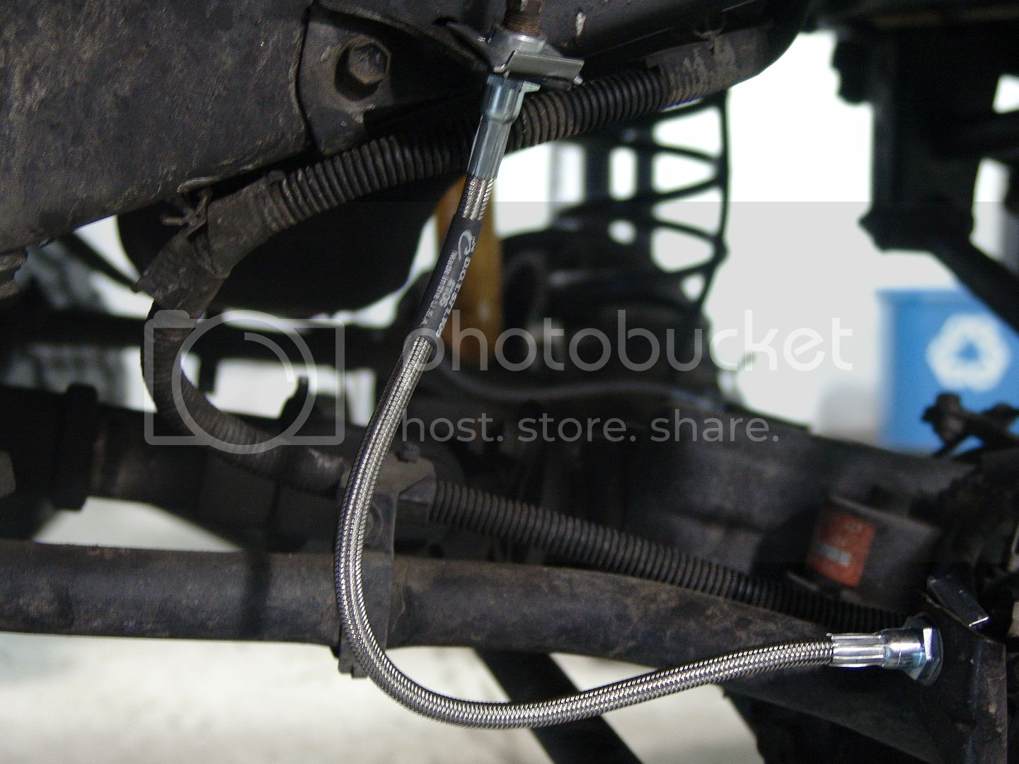

Some new Slee brake rotors slotted and drilled all round, got thrown on out of stock at Slee, with some brake pads I also carried over, and some Slee Braided brake lines to aid pedal effort by reducing brake line swelling.

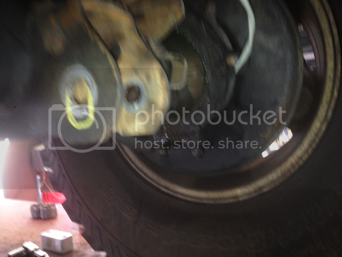

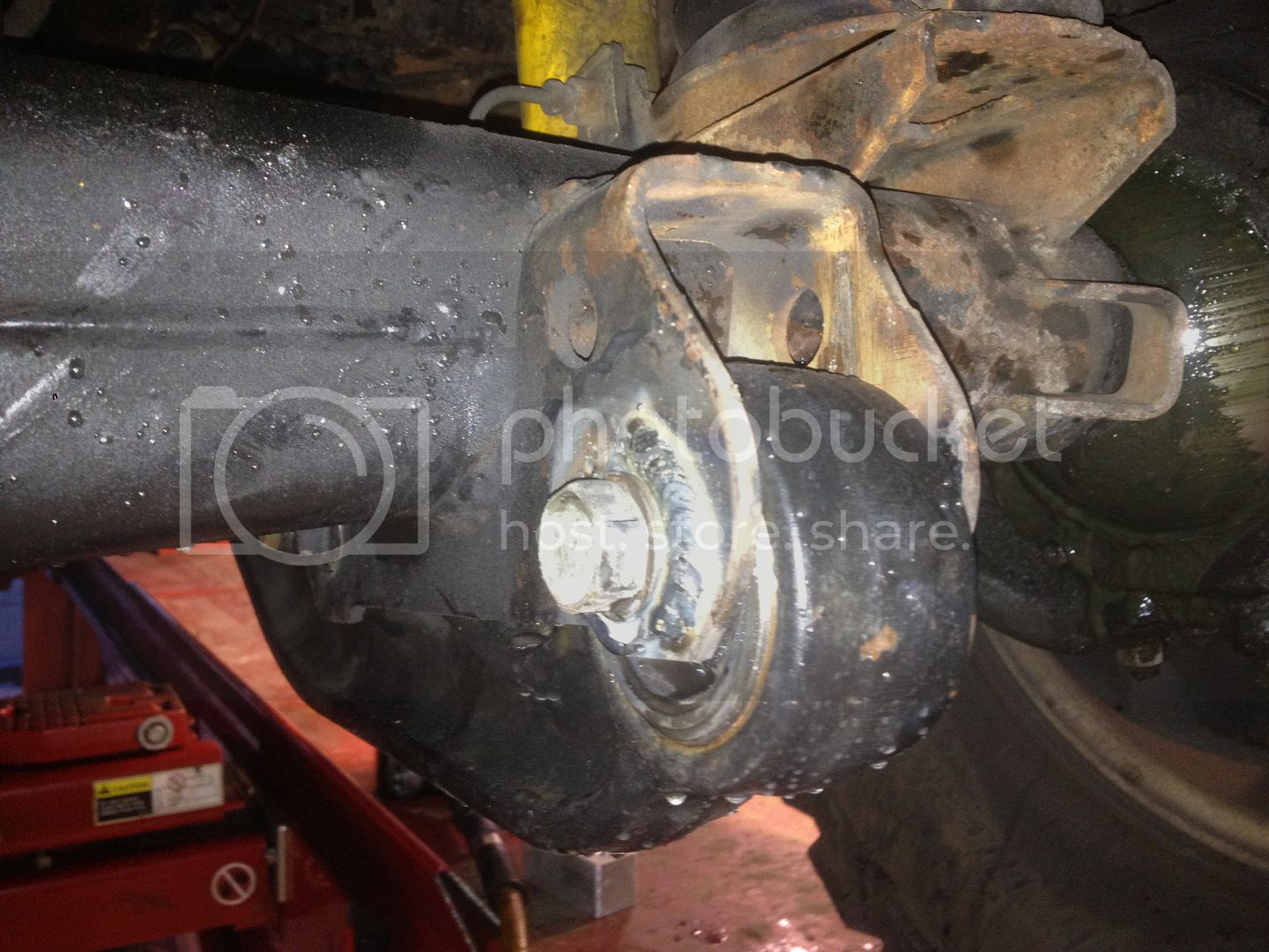

Installed some bushes and slotted the front caster bush holes known as the "washer mod" and something we have been doing for years at home too.
And welded up the panhard rod mount, even LHD ones crack, it seems, just like our RHD ones at home.

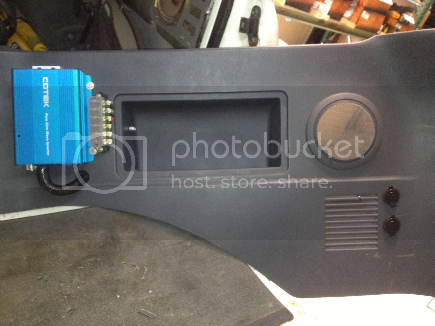

Wired up a 240v invertor, for our Aus accessories, when we need them charged, and some acc plugs too in the rear, using some 80 plastic tabs to save on cable ties.

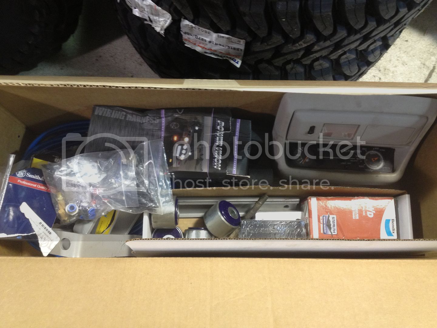

The next box of bits.

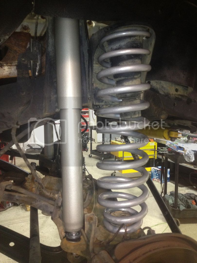

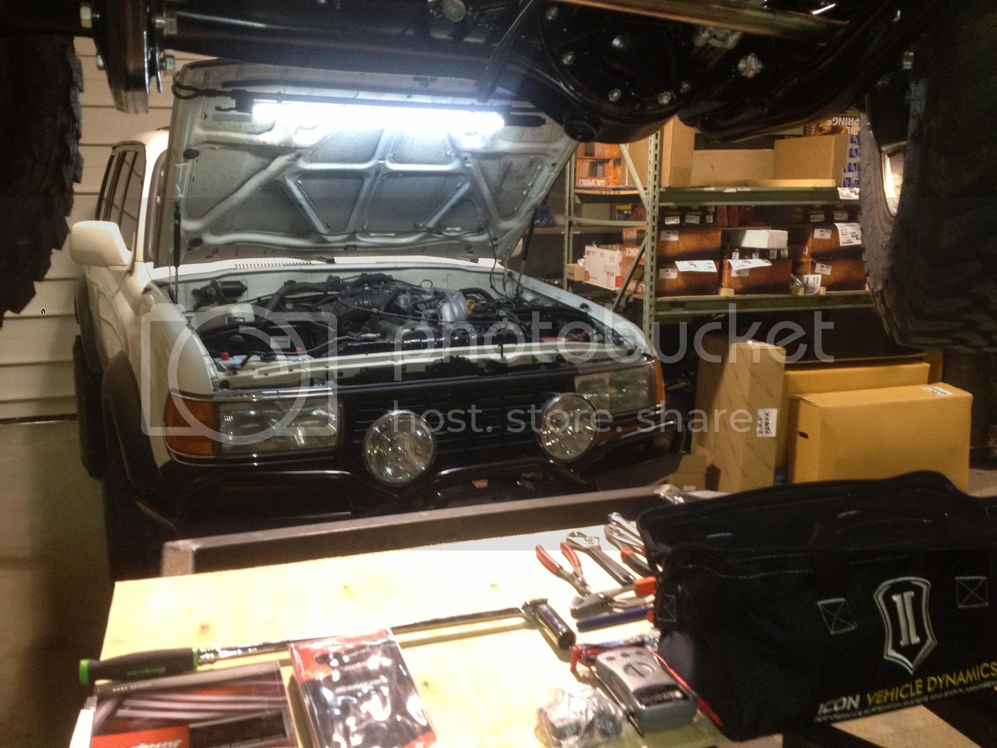

Managed to bolt our Slinky long travel kit under SNOWY before our ICON kit arrived, which as most probably know includes some bits to allow the articulation the extra long shocks give, but I thought I would detail it quickly here, as something we have done to SNOWY.

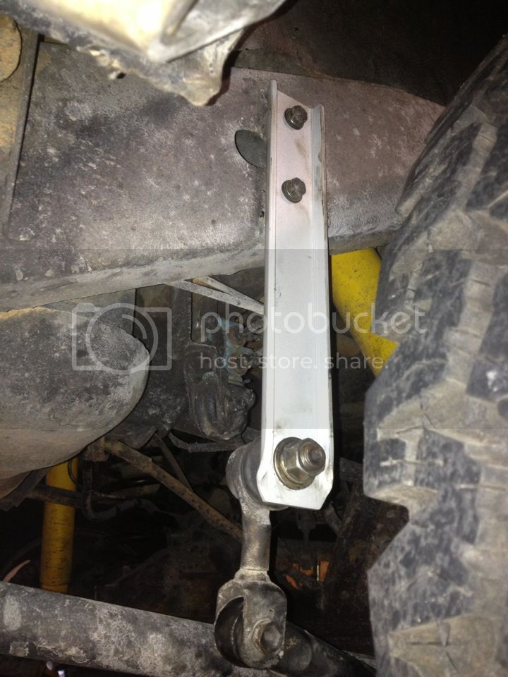

Like rear sway bar extensions, replaced the cotton reel bushes at the same time.
79 rear bump stops on this one, because I had them, long enough to mean no bump spacer required.

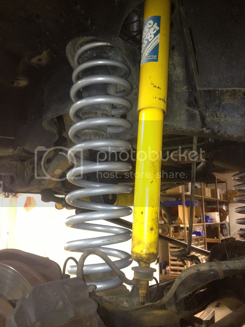

Slinky long travel coils, running with our Ridepro shocks to begin with.
This coil offers much more travel than your OME L shock will give in the front, same in the rear.
Front sway bar spacers, so the tailshaft wont hit the sway bar on droop.

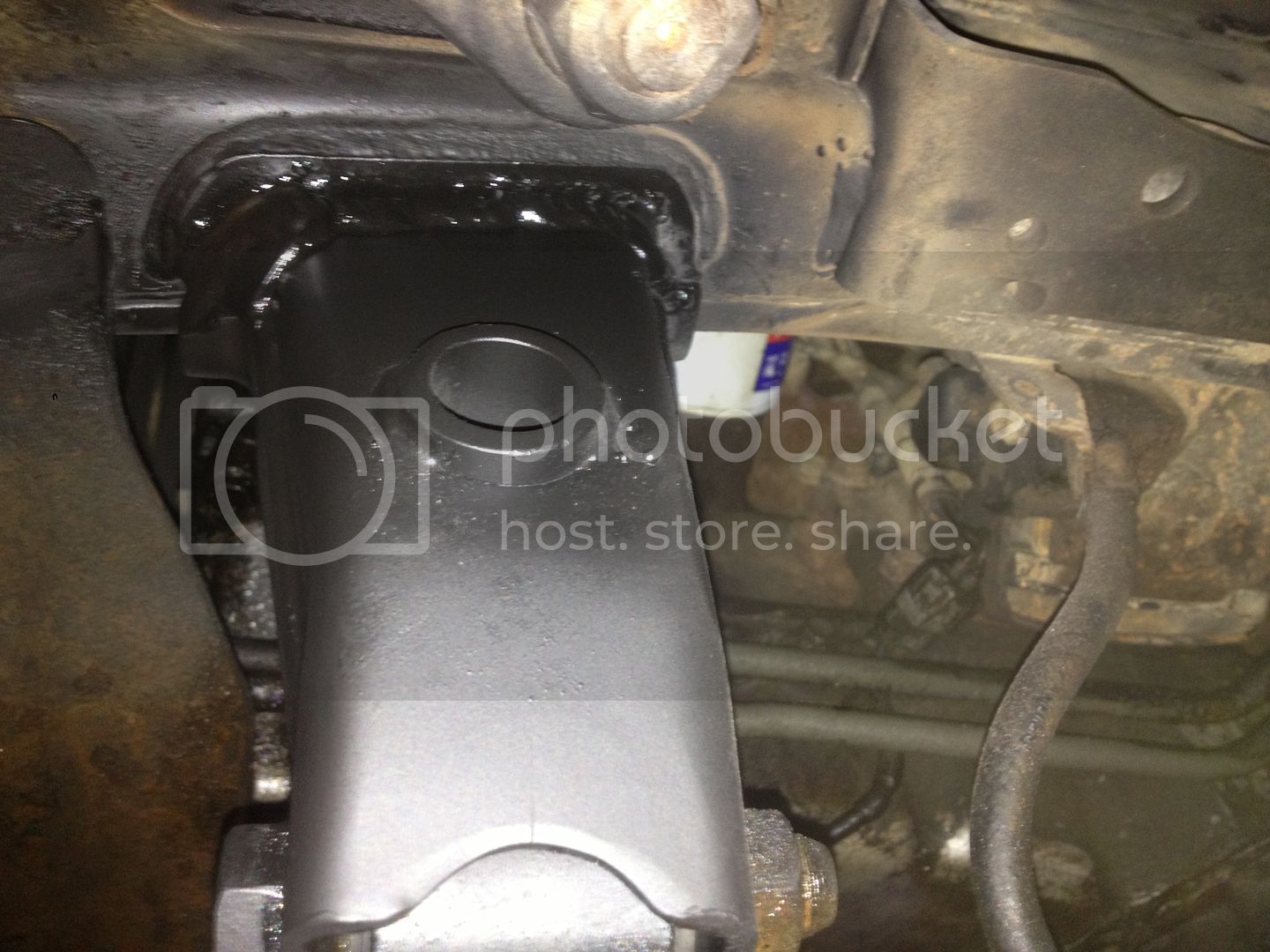

Washer mod marked out [pic above in this thread welded] for an extra 2 deg of caster.

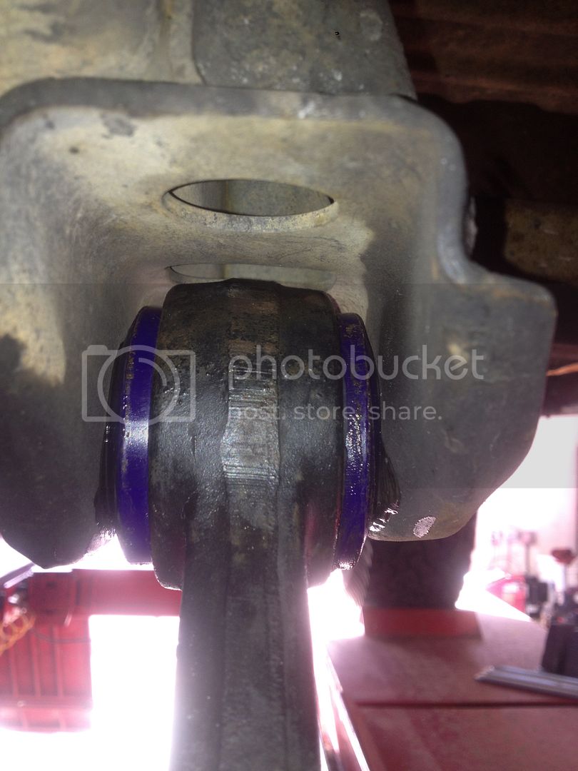

New lower rears,
But I am going to fit something that has less torque movement, to reduce torque steer, I think, than bushes, on a heavy truck, on 35's with 4.88 diffs.

Do you have more information on the hand brake shoes you brought over and installed. Plans to sell them here in US? I'd like to have a more effective e-brake on the 80.
We have been using a different type of lining with a better friction co efficient, so it has more grip on the drum.
It improves the hand brake by about 50% over the standard shoes.
We also extend the dog bone about 3mm, if its worn, which also helps.
