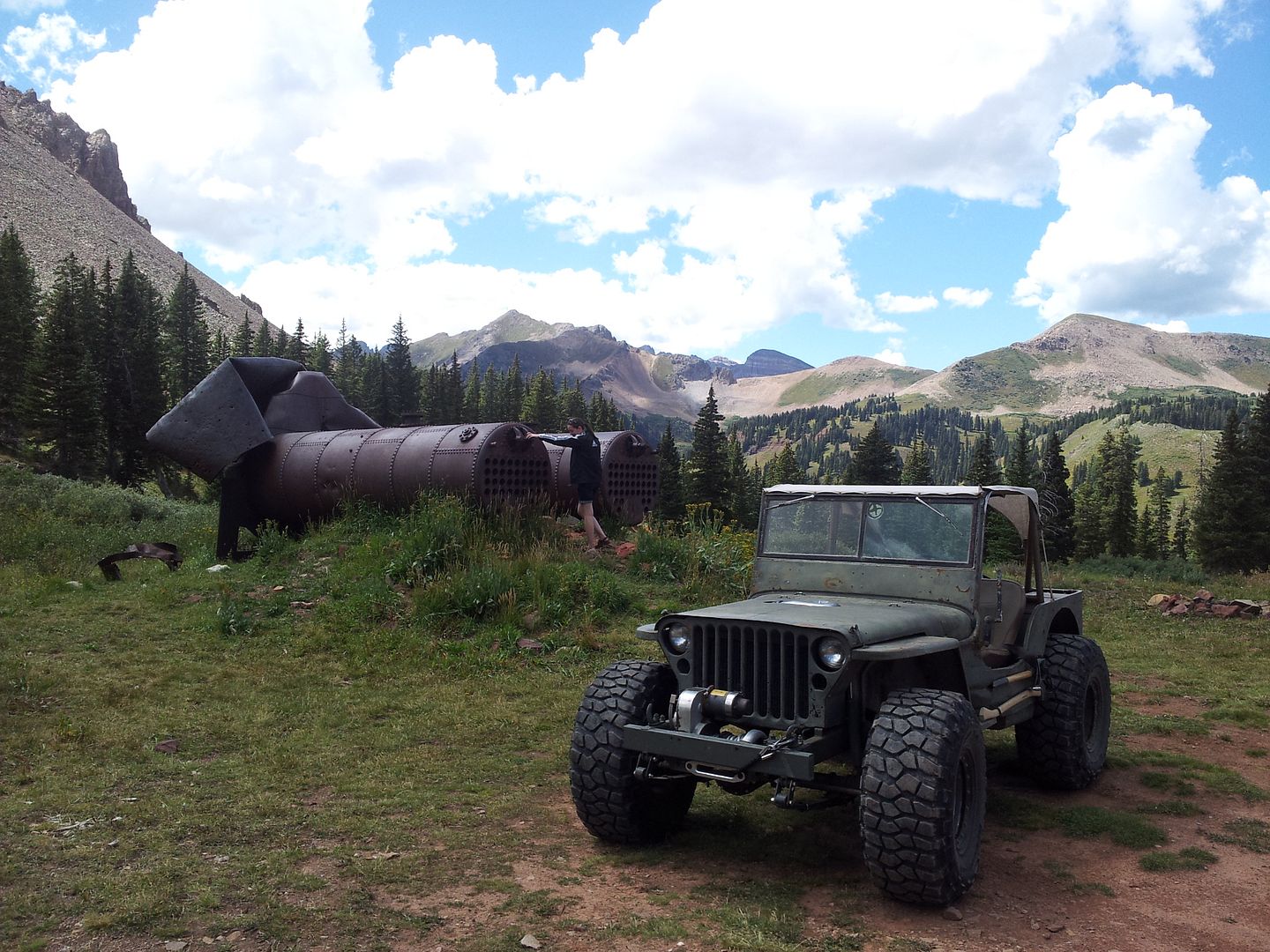

The short version is, it is amazing how well a 'stock' based vehicle can work with only a small, if any, increase in lift, larger tires, and great quality springs/shocks/bumps. I am not talking about double custom long arm coilover ultra 4 type buildups.
My hope, is that theory should carry over to a J80 chassis also. How good can the J80 be with high quality shocks. Perhaps some modern bumpstop upgrades. Etc.

To be fair, I think that issue is blown WAY out of proportion. I have seen people have issues, but frankly it comes from gross abuse more often than not. To see where I am coming from, this was my last project....
It is running an early Dana 30 open knuckle front axle and a Dana 44 rear axle that I converted to full float. I am running HEAVY 35x13.5x15 Krawlers on HEAVY steel beadlock wheels. It has a nice little peppy V6 engine, granny 4spd, deep axle gearing, lockers, blah, blah, blah. I've done all the book trails in Moab multiple times, thousands of miles on the highway, and Ultimate Adventure in 2014 and 2015. It gets used....
Axles....no problems in 4+ years now since I rebuilt the vehicle from the ground up.
I do like the J80 chassis as far as axles go. They have nice fabricated axle housings that seem to hold up well in vehicles that are pushing 6000+lbs. The drop out 3rds are WAY easier to work on. The full float rear axle with disc brakes from the factory is nice. Serviceable wheel bearings in front is a bonus. If I was being critical, you are pretty much limited to a 30 spline shaft and it would be nice if the front axle had a bit larger gear set.
I will be testing the J80 axles for sure. I am running a 40" tire on this new car. My hope if that the final weight of the vehicle is similar to the BASE stock weight of the original vehicle. It will have more power, gearing, and more un-sprung weight bias. It will be interesting to see how it all works out. I do like the packaging and proportions of the J80 chassis. It was VERY neat to figure out that if you totally tool the body out of the equation, a 40" tire on a 3.75" BS 17x9" wheel will clear the radius arm at full lock ( 35 degrees or so ). I will be upgrading the axles with alloy shafts front and back to help things live. I will also be keeping the stock 4.10 gearing since I will have a 1.22 underdrive high range in the transfer case.
Again. I am not brand loyal. I love them all. They all have pluses and minuses. I look at what I can learn from just about every vehicle platform.
Nice Jeep. I have a TJ and XJ. On the TJ Rubicon I've gone through several front axle shafts before switching to chromo shafts, as well as replacing nearly every flimsy factory control arm/trackbar mount. Rear is trussed. This is all on 33's. Will sleeve and gusset everything up front before pushing 35's or 37's... Likely just 35's because I can upgrade gearing and goto ARBs on the 80 from saving $2000+ on 37" rubber and new 17" wheels.
