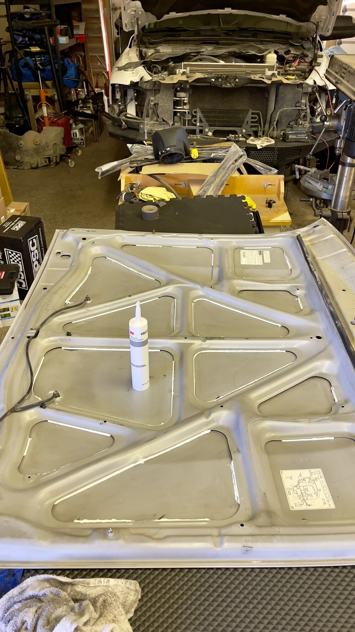

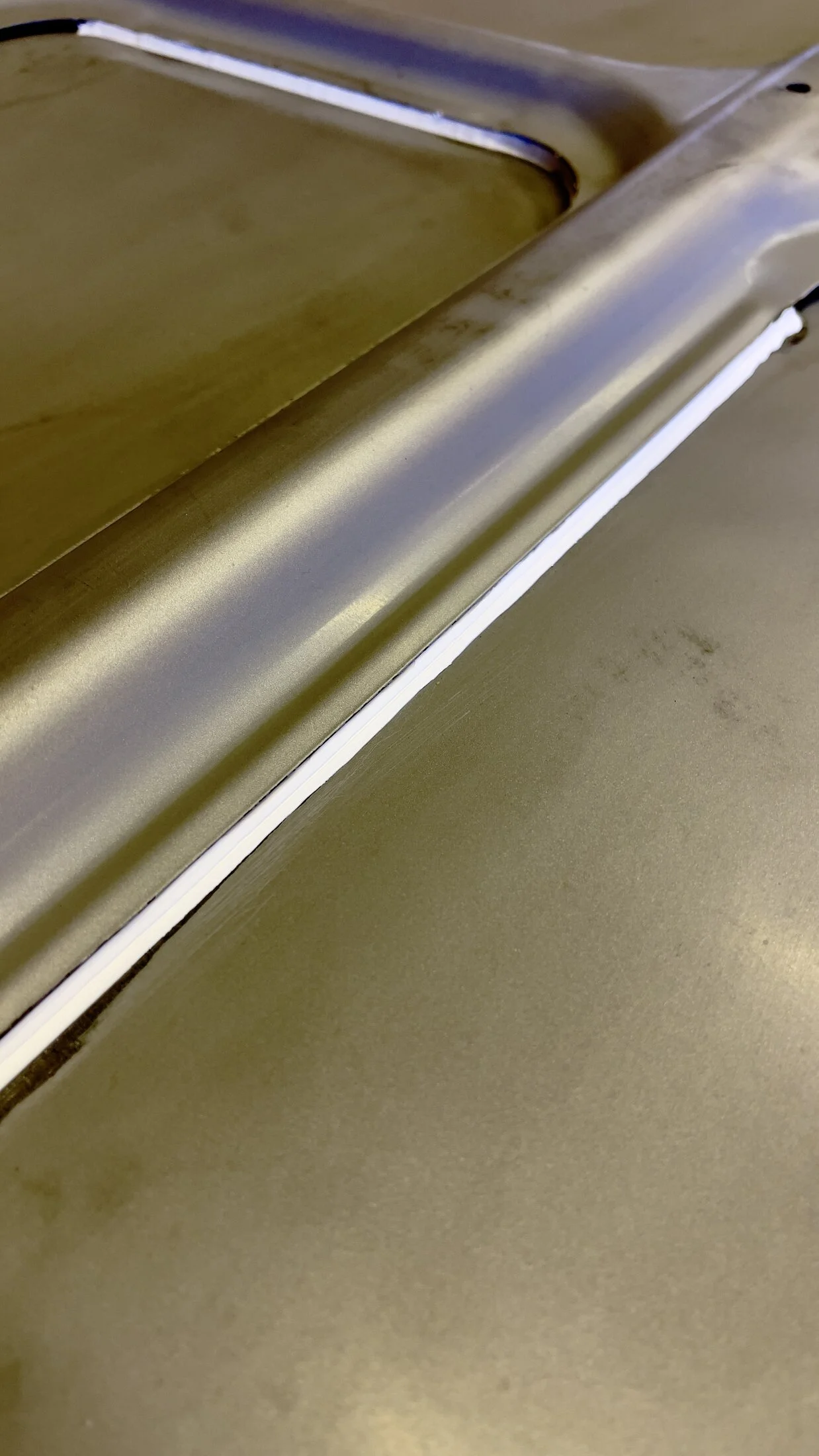

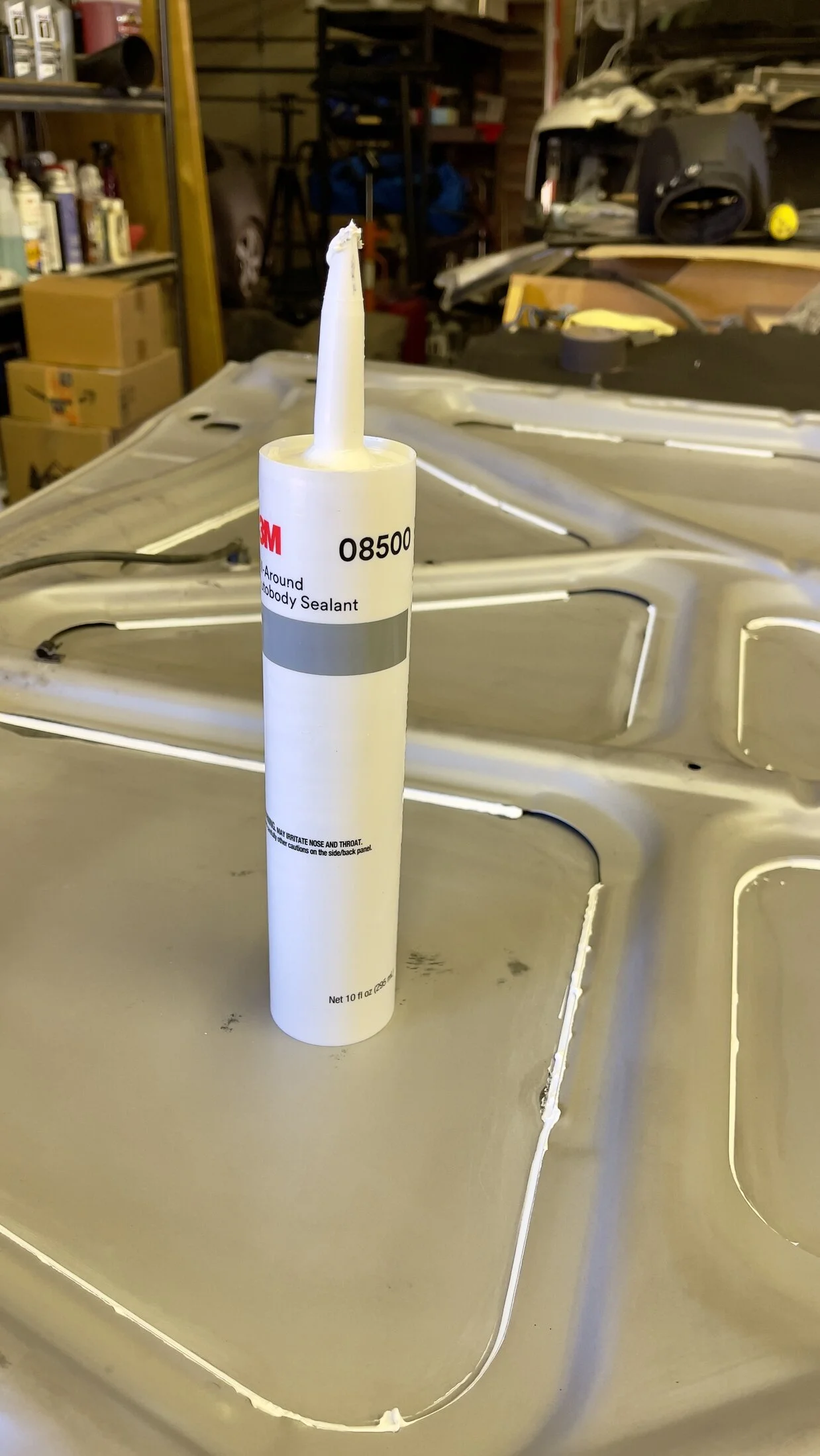

FWIW I finally got around to seam sealing my bonnet. I was in a bit of a time constraint, so I didn't spend endless hours prep'ing, just a good cleaning with spray glass cleaner, ran some folded over sanding belt between the ribs and the skin for some adhesion teeth, and then used one full tube of the 3M seam sealant. It must be latex based as it is cleaned up with soap and water.

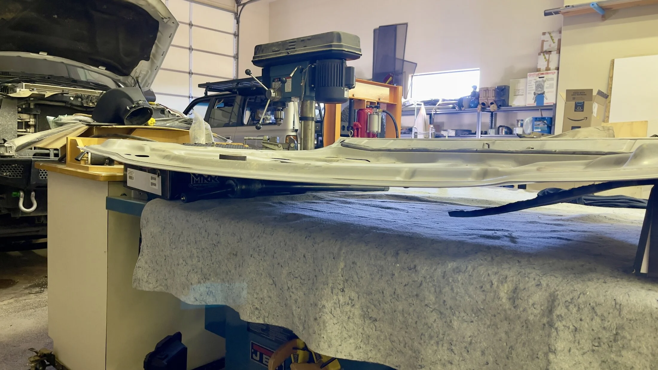

I supported the hood by the edges with some boxes and rubber foam mats to keep if from sliding.
According to the product spec sheet when we looked it up at the automotive paint supply place I went to in Tempe, it should hold up. There were better products in the 3M product line, but they were two-part tubes that required one of their guns to apply the product. I wasn't going that far. Time will tell how this holds up.
I will say things seem a tad quieter going down the 2.5 miles of dirt to the house. Not from the insulation, but from the skin being bonded somewhat again perhaps.
