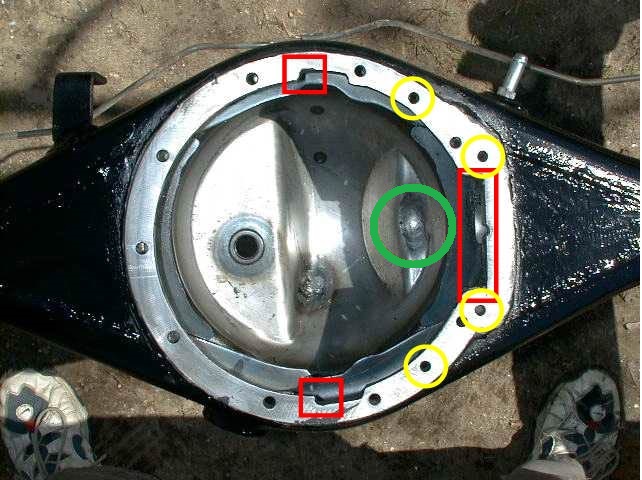

As most of you probably know, Toyota supplied factory Tacomas and 4Runners with an OEM rear e-locker, beginning with the 1st gen Tacoma and 3rd gen 4Runner. The Toyota e-locker axle housing is based on essentially the same design as the more-common non-locked Toyota 8.0" rear end, with some slight design changes. It is common for guys to retrofit Toyota e-locker 3rds into non-e-locker axle housings with some small modifications to the 8.0" axle housing. These changes are well documented, and there are several excellent write-ups on the topic:
The basics of the swap require modification to the axle housing mounting flange including grinding/clearancing for the e-locker 3rd, and drilling and tapping for additional studs.
On some write-ups, the installer also had to clearance the back of the housing with a brass drift or air hammer to clear the bolt(s) on the e-locker 3rd member cap. But on some write-ups the clearancing is not required.
The clearancing can be seen in the large green circle in this photo.
My question is, instead of a hex bolt, could you install metric button bolt on the cap? Is anyone familiar with this option? Would this add enough space to avoid the additional clearancing on the back of the housing? I seem to recall someone suggested this option, but can not put my hands on the thread.

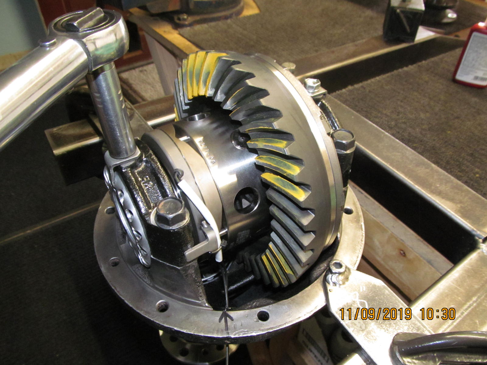

Here is a different angle for the bolt in question on an open diff.
I would understand if it were the cap bolts. Those are like 70 ft-lbs.

I shaved mine down a little with a belt sander and then put some yellow paint on the back side of said bolt. I then dropped the 3rd (gently placed) into the housing until that bolt made contact. Pulled it out and used a ball pien hammed to ever so delicately smack that spot until it just fit. Can’t even notice I smacked the housing when you look at from the rear.
You shaved down the hex bolt head?
I may just clearance the axle housing like everyone else. It’s probably not worth the risk to start monkeying around with a brand new $2,500 e-locker diff.
Yea, no big deal. Shaved the head down a bit on the bolt. Still tons of meat on that puppy to remove and install it needs be. Not sure if I will ever need to touch it though.
Great intel.
And this is the bolt you had to shave down?
LOL... I got a kick out of that first photo, I remember taking that in my driveway a looong time ago, those are my feet. It's funny that it's still circulating around.
I've done several installs, and even at the worst, the clearancing is just not a big deal. A few whacks with a 2-pounder and it's done. Don't over think it. You've already spent too much time on it.
Awesome, I’m so glad I’m speaking to the OG! I pulled the photo from the 4x4wire write up.
