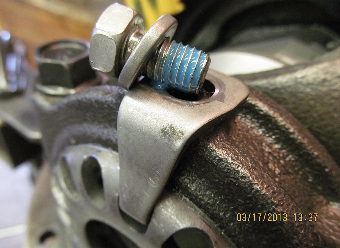

Does anyone know the specs (M8x1.25? 20mm length?) or Toyota PN for this 8” carrier bearing adjuster tab bolt?
I'm showing:
91611-60814 supers to 90119-A0310 $1.21
Reviving this thread because I'm in the middle of this. From the marks my bolt makes on the inside of the housing, it looks like you pound on the flat part of the inner housing? I tried hitting it with a brass drift. Not budging so far. Is there any point in grinding the area? Or that will make the housing too thin? Seems like I need to gain about 1/4 inch of clearance for the bolt? I will probably start hitting it with something heavier tomorrow, but knowing me, I will punch a hole in the housing.
