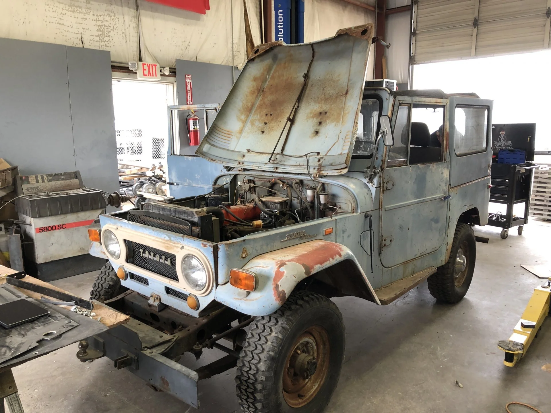

Good call on that SlapSmak/3_puppies. A lot of what I've read says ball/claw axles were 68 and ealier, so I felt like I was in the clear. Talked to a couple of cruiser places as well (George @ Cruiser Bros, Advanced Adapters etc.) and they seemed to think the same if I remember correctly. However, I really need to fully disassemble and verify. I took off the locking hub and saw these splines and thought that meant I was in the clear and had birfields. I've realized thats probably just the spindle splines though now that I've studied the knuckle exploded view for so long! I attached a picture of my 40 for reference as well in case that helps with identification.
Regarding the Chevy brake route: I'm doing the poser kit on the rear, but I'd like to stick with toyota up front and upgrade to the later model larger stud knuckles (79+ FJ40 or maybe even FJ60 knuckles) so I have the freedom to upgrade steering arms, TREs, tie rod and drag link. I have a Saginaw steering setup already installed.
With those turn signals and marker lights, you are in the clear unless you have a foreign market rig.

Looks like the end of a 6-spline ball&claw stub shaft.
Unless there's a 6-spline birfield out there.
