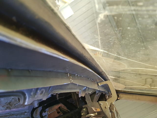

ya, i was going to say turn up the heat or turn down the feed. But your last beads look nice. Good work.

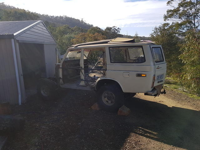

Welded the front body mounts in on the weekend and pushed the pig out of the shed so i could clean up in there a bit..

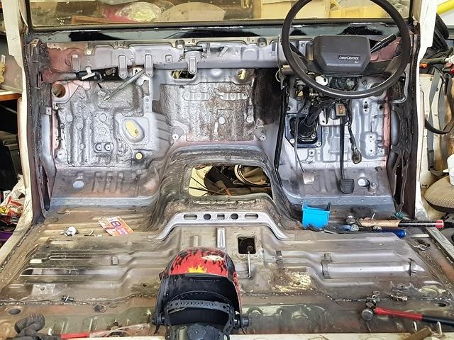

Front body mounts welded and a full shot of the BJ73 firewall welded in:
while it was outside i stripped the paint from the rear lower quarters to see what was hiding under there
Found a few other bits that need attention too but nothing as big as that patch..
7x firewall and floor

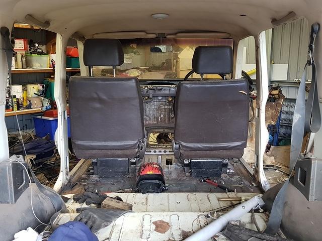

Been either looking after a sick wife or being sick myself for the last 5weeks.. but today i got some time in the shed..
still lots of welding to do on the floor but at least its now more accessible..

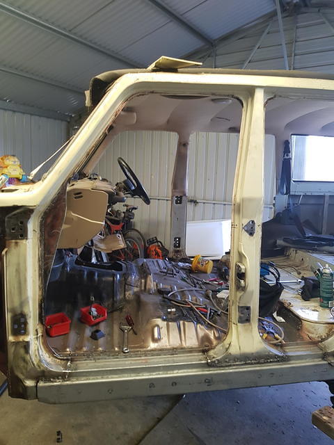

bit more done yesterday.. trimmed the a-pillars along the profile the interior trim panels will take. this bolts up to the firewall in the factory spot hidng the fuse panel behind. still more to grind off though..
so today i worked on the cap above the new cowl to where the old 55 dash met under the windscreen..
also trimmed up the a pillars

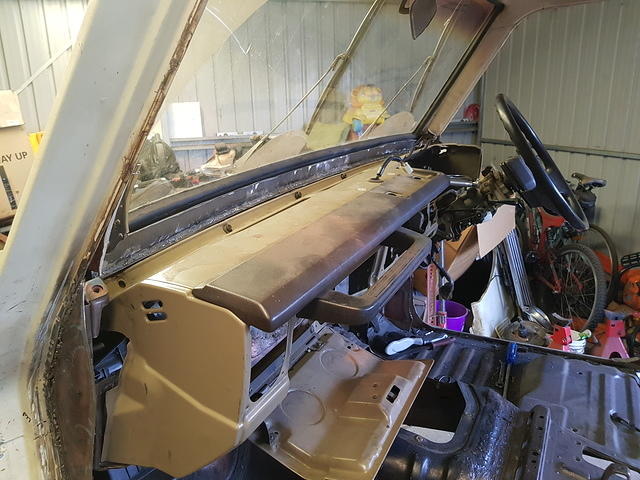

and mocked up the dash shell to see how it would sit..
wow that dash is DEEP...much deeper than the 55s dash...you're gunna need to bump the front seats back a bit???
Gunna be sweet. Still say it should have flip down glass and pop off top...
Ive still got the frp top and roll bar.. was considering the rear seats from the bj73 as a 3rd row in the pig.. depending on the state of the roof you never know that might happen! No flip down windscreen.though that was sold long ago and had a fair bit of rust down the bottom.. it would of made the wiper situation more straight forward though..
