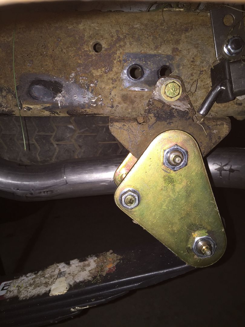

Thanks for sharing the pics. Maybe someone could show some detail pics of where the rear shackle hanger was moved, possibly with dimensions? (Or is that little detail included with the kit instructions?) Can't wait to do this.
I will measure tomorrow.
5" back on mine.
The kit does come with a part diagram showing which parts go where and recommending to move the rear perch back 5"

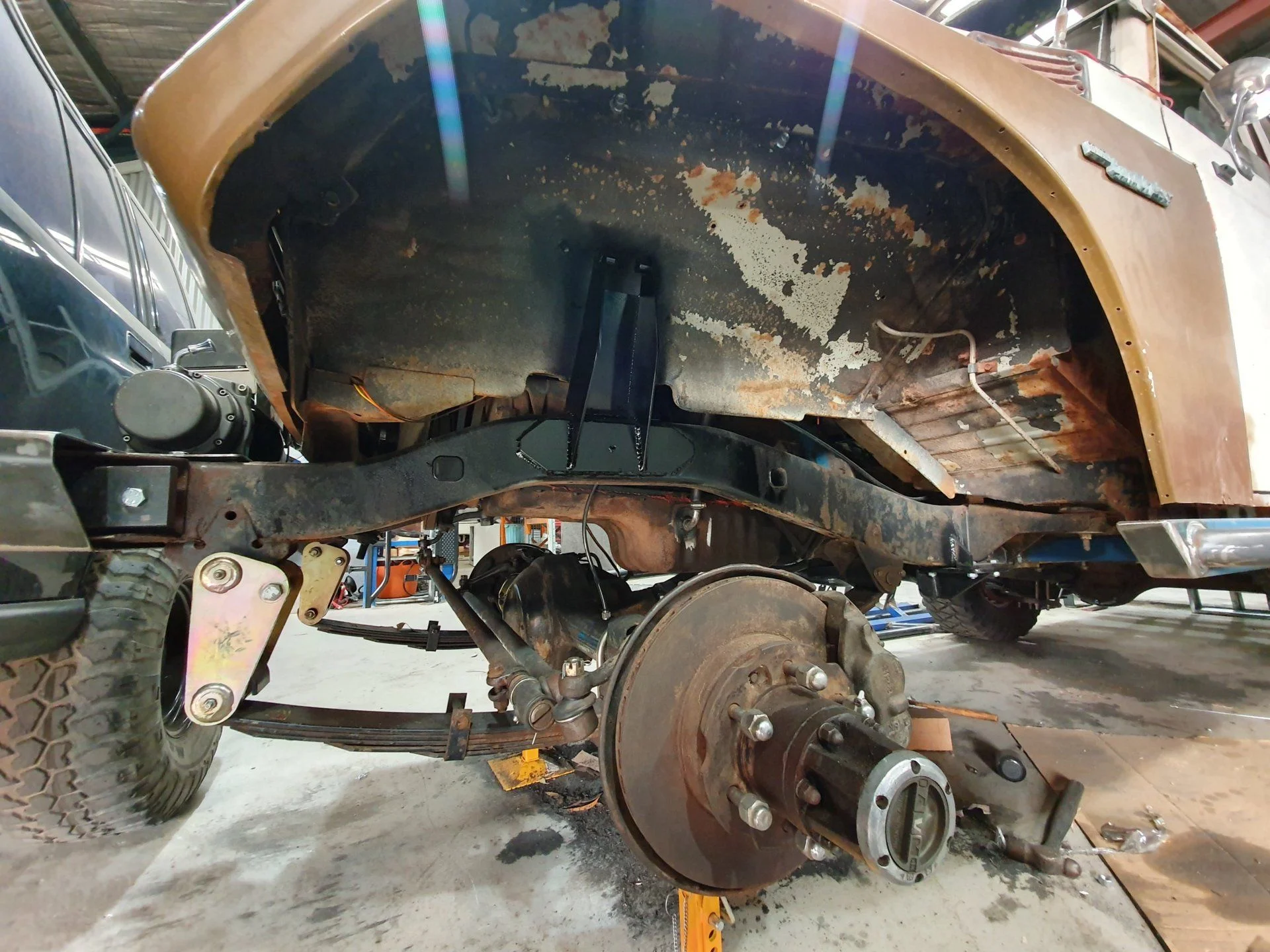

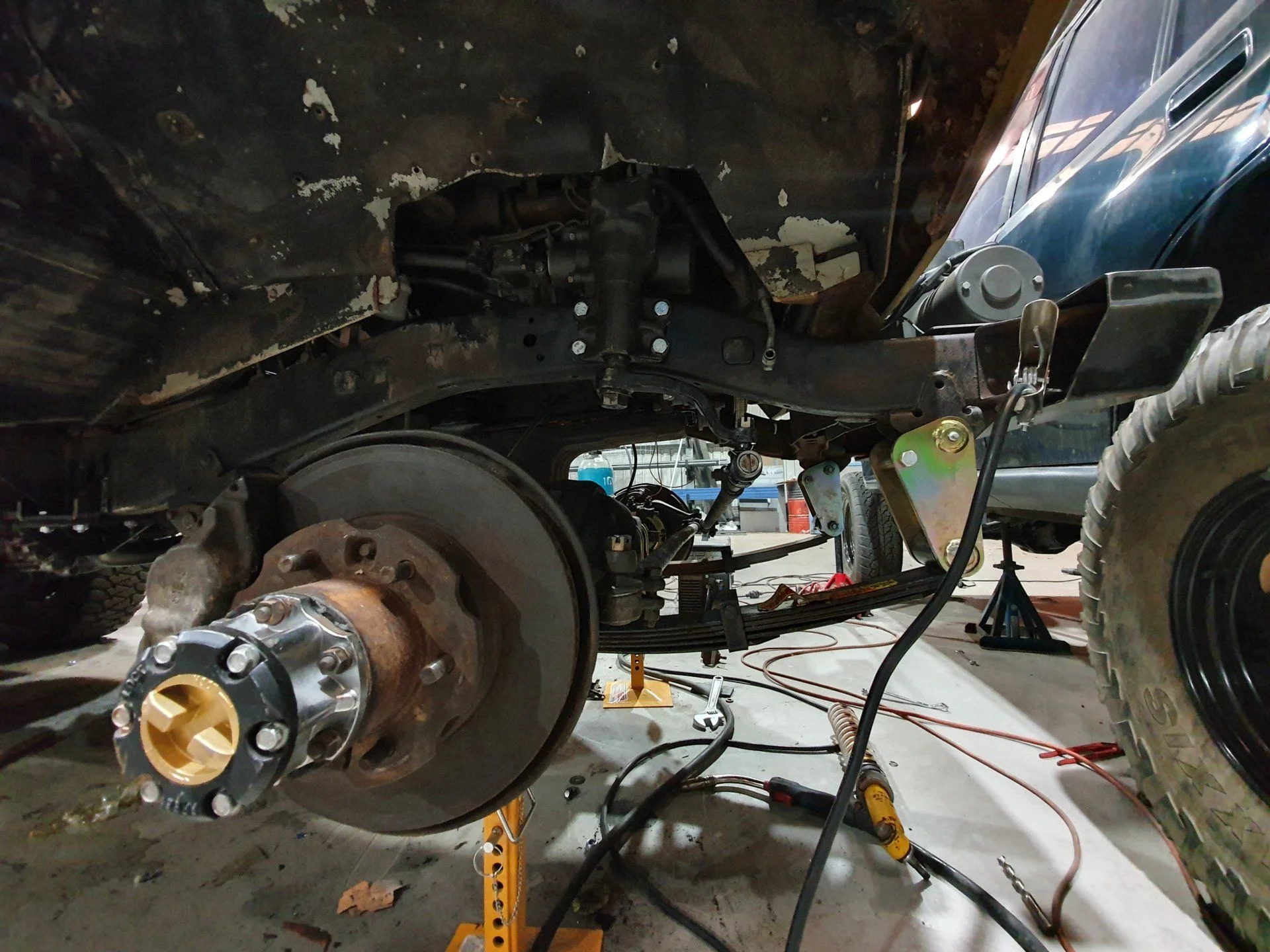

This is my 1977 FJ55V.
HZJ75R Leaf Springs.
2" Superior Engineering Shackles.
Rear Shackles relocated 120mm *no photo yet.
Shackles will be reduced in height to show the difference and work with better suspension articulation.
