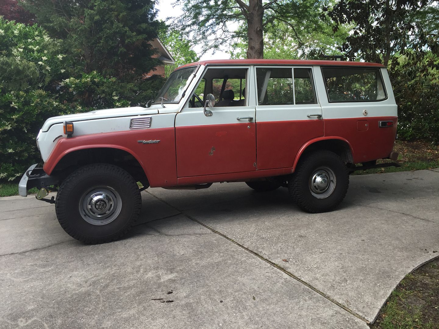

Side view,
Bolt it on? You didn't have to re-locate your rear hangers? Your truck looks a lot taller than a lot of Pigs I have seen that SUPPOSEDLY have a 2.5" lift kit installed.
Yes bolt on, you do need to relocate the rear hangers and IMHO you don’t need to weld them, bolts will work fine. If you can weld or have a buddy that can weld a couple of small tack welds on the hangers after you relocate is a good insurance but not mandatory.
That picture is the lift as delivered from Cruiser Outfitters with 33”-12.5” tires.

Side view,
Rear shackles look almost vertical, eh?
The springs are new when this photo was taken, they have sagged a bit and the rear shackle angle looks better now. The front sagged too much but no fault of the springs, I added a heavy engine, winch and a bunch of other crap on top of a spring that was already a little light.
This kit lifts the rear a little higher than the front giving it the stink bug look when using the light front springs, if I had it do it again I would have ordered the heavy front springs but I don’t care for the stink bug look.

Side view,

J Mack, in the picture with the red 55 it looks like the rear axle sits forward in the wheel well. I think that I have read about this previously with this kit. Wondering if this is the case or does it move back a little after break in?

At static height it is forward of centered however that absolutely plays in it's favor. The springs have a fair bit of arc and during up travel the axle moves backwards. We test flexed our initial install with 33's and they just about kissed the rear fender just as they touched the upper wheel well, perfect!

At static height it is forward of centered however that absolutely plays in it's favor. The springs have a fair bit of arc and during up travel the axle moves backwards. We test flexed our initial install with 33's and they just about kissed the rear b
Like Kurt said the tire sits a bit forward but at full compression it moves back to about as close to perfect as you could ask.
