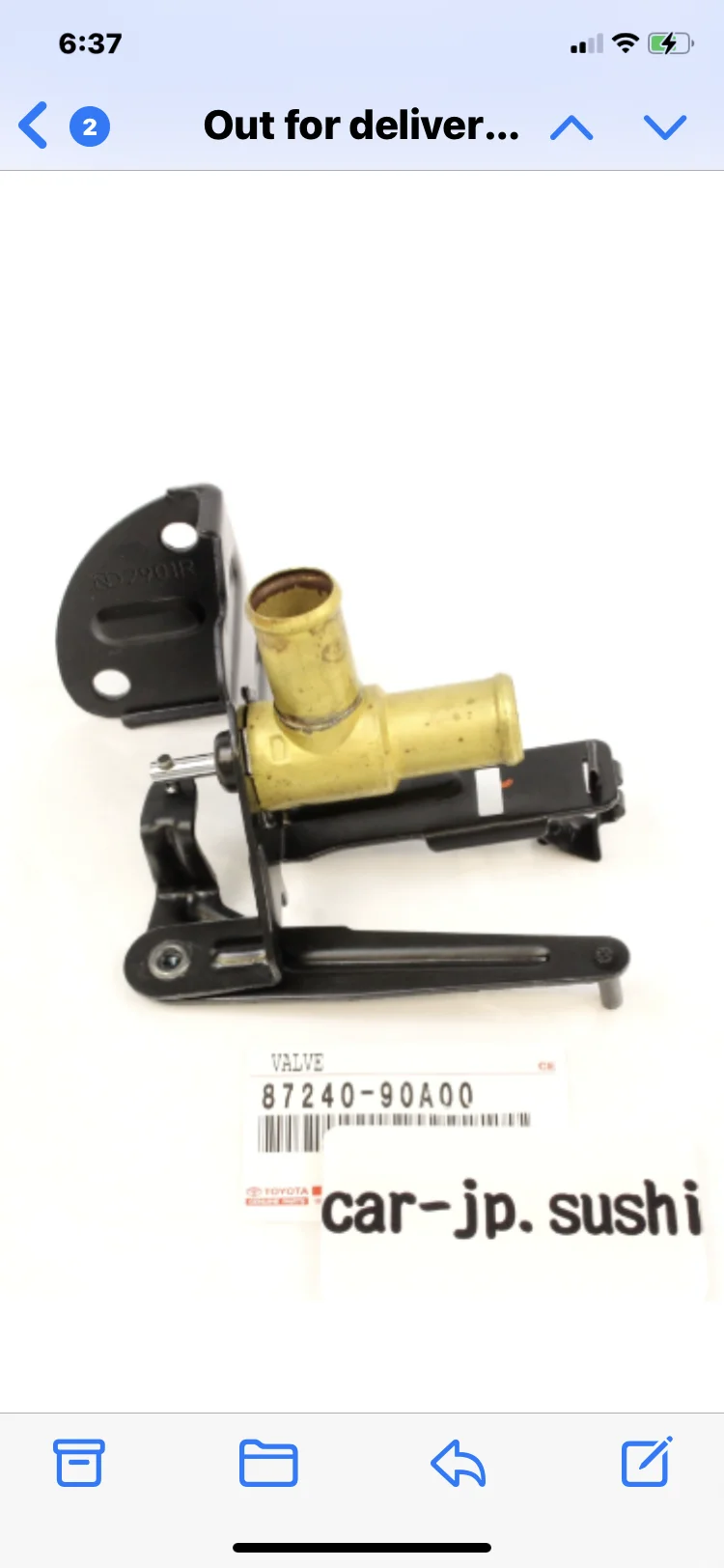

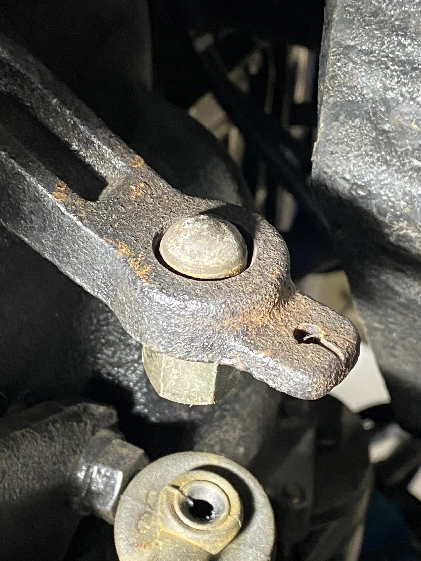

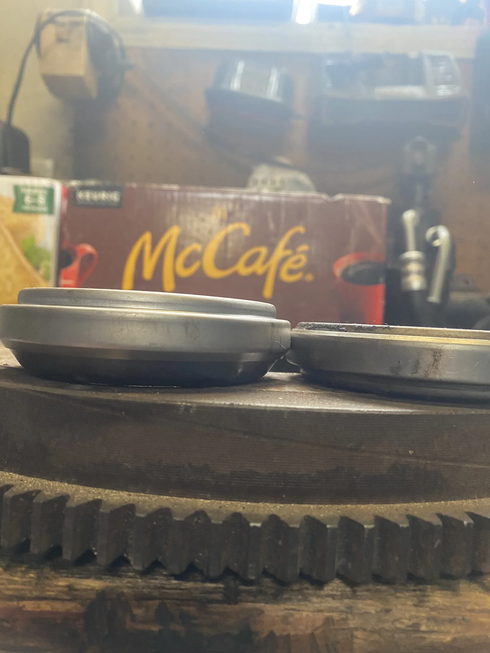

Well the heater valve works great, Moving on my clutch has never worked right always had to push the clutch all the way in before it would release, with the throwout bearing up against the pressure plate no adjustment left, and me grinding the gears when shifting. Well now I know why my clutch arm broke it was pushing in at the wrong (angle) but not in enough to disengage the clutch. I never checked the throwout bearing I got from Napa. I bought a new clutch kit from Valley Hybrids in Stockton. And this was the problem. The bearing was to short from Napa. I now can shift without grinding the gears thanks to Valley Hybrids

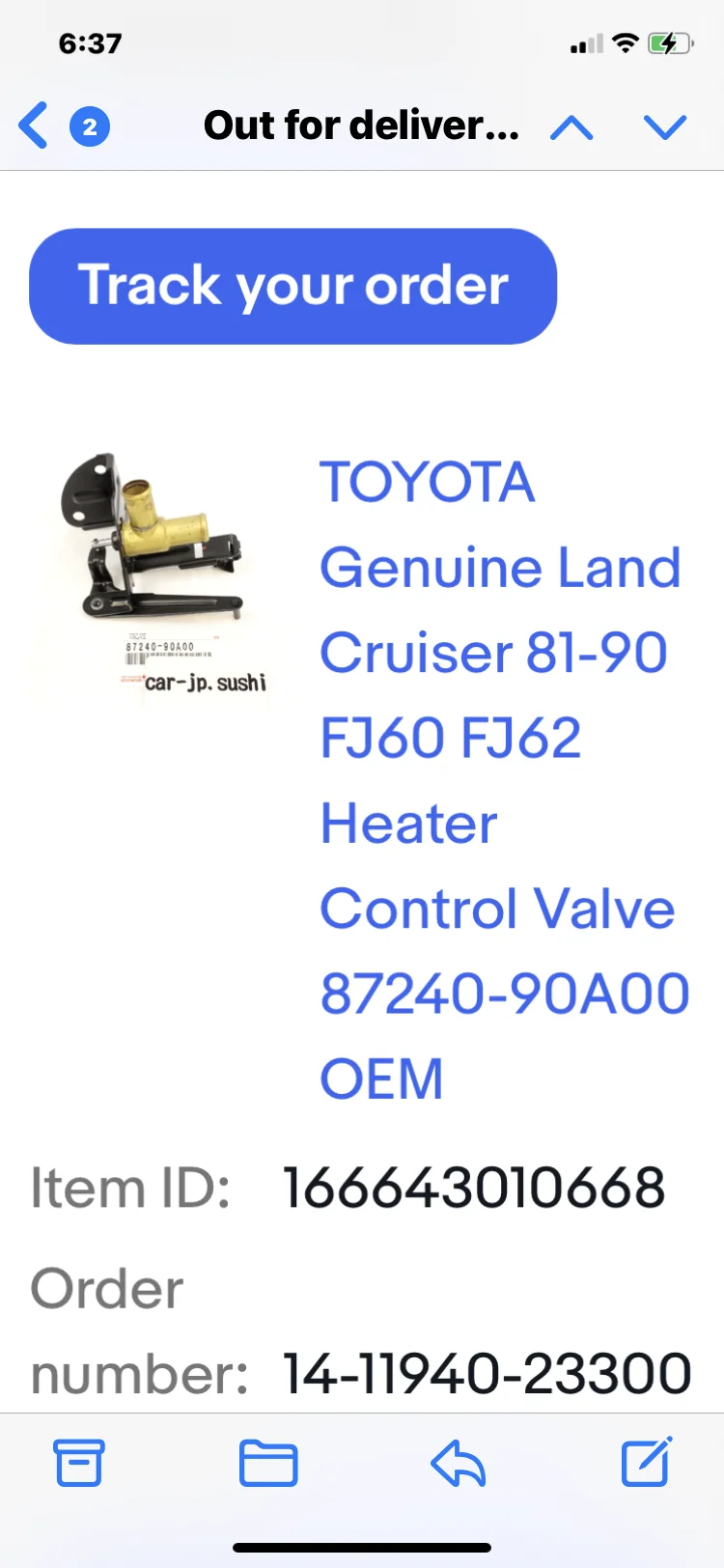

What heater valve is that?
FJ 60

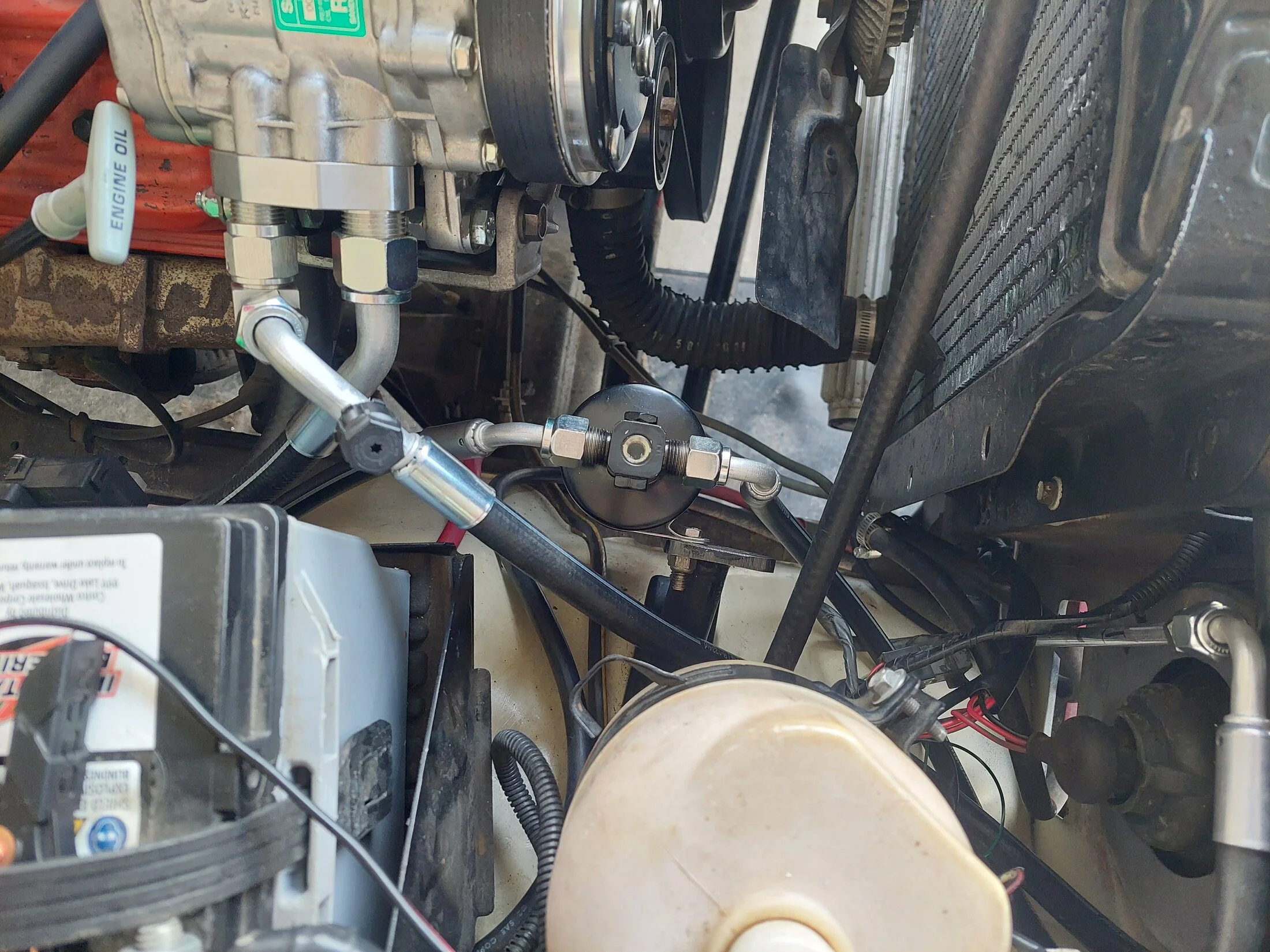

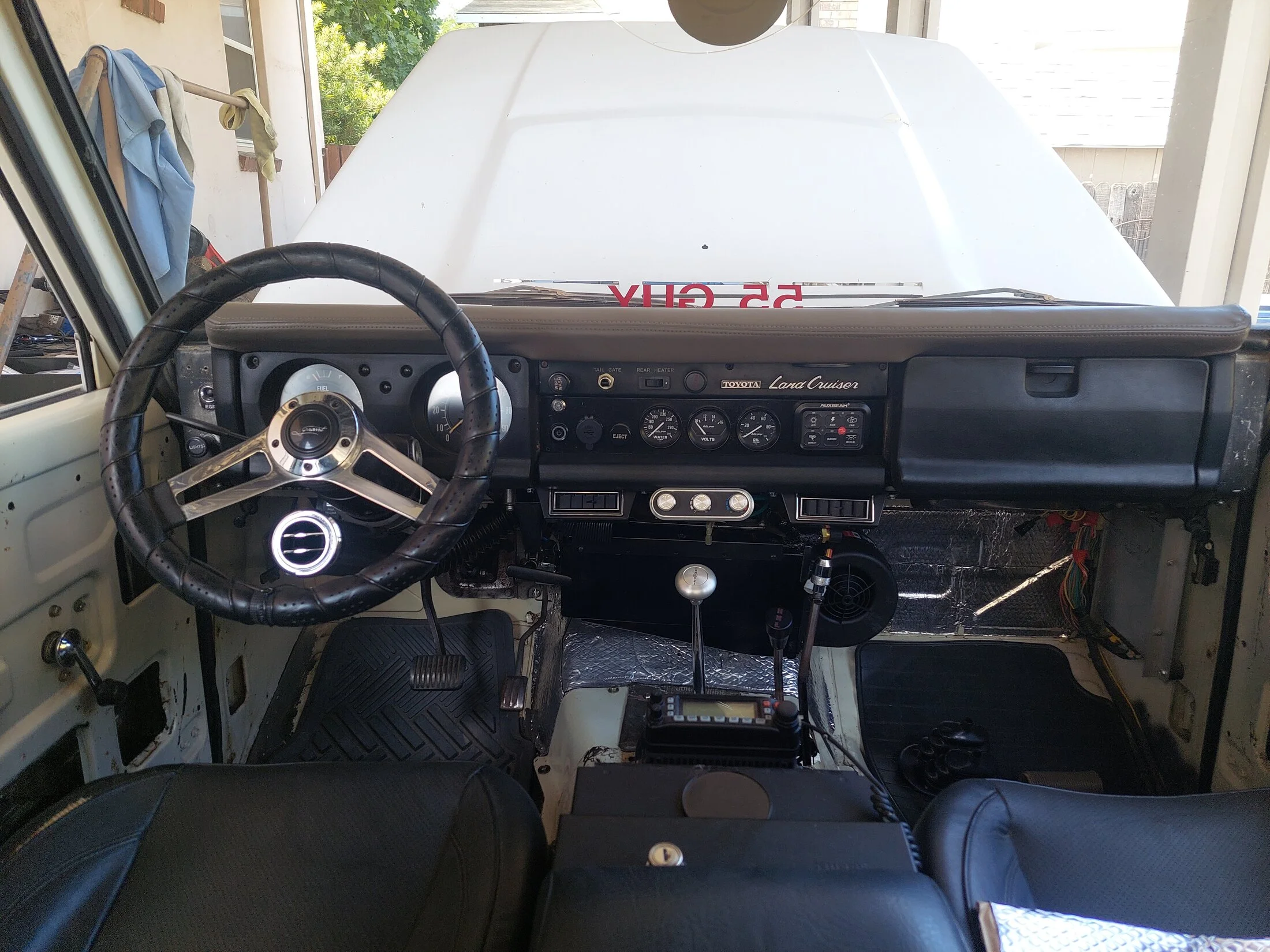

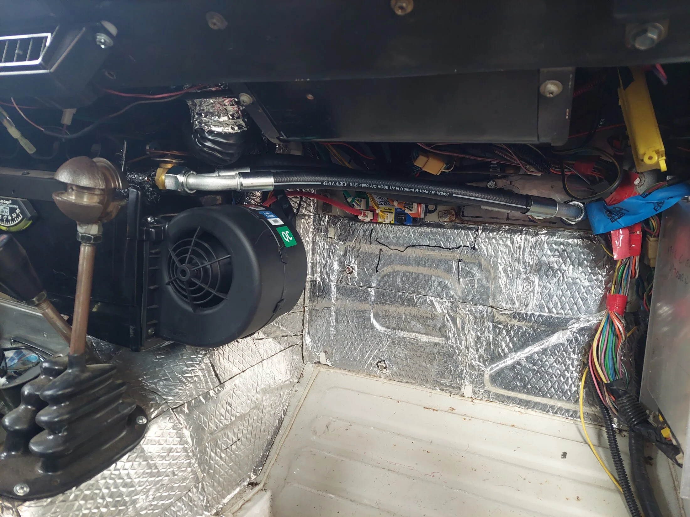

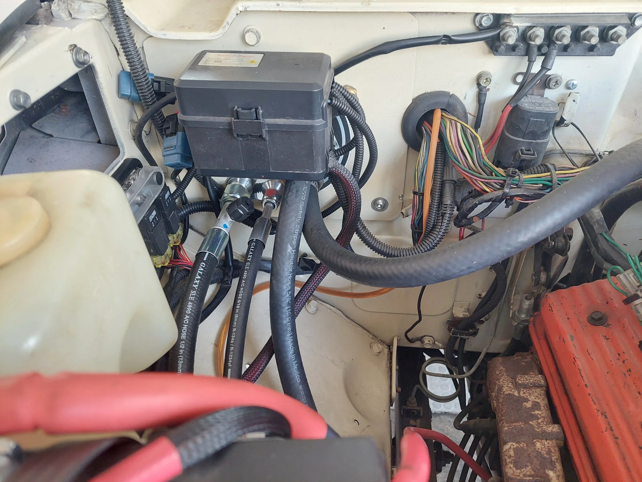

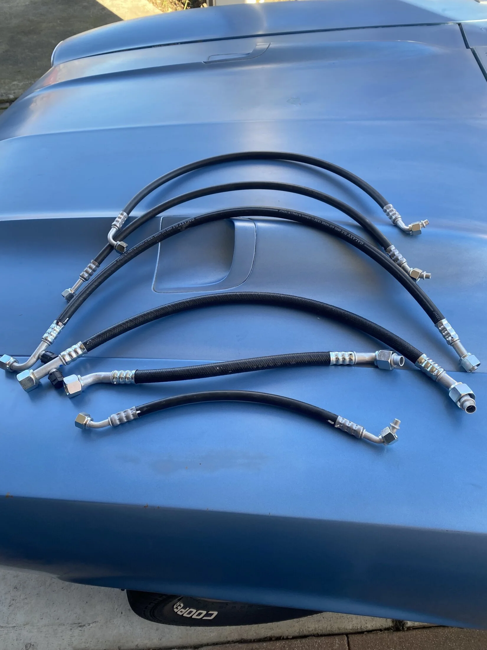

Hello 55er, I started back on my AC project , Made my AC lines ,First time for me to build a Heater, AC system. There is no blueprint only the 55 mud board , Thanks guys .
So far so good , But having to buy the right fitting gets to be costly $$$$ Next phase is Vacuum and R134a Cost for this set up is close to $1800 ????

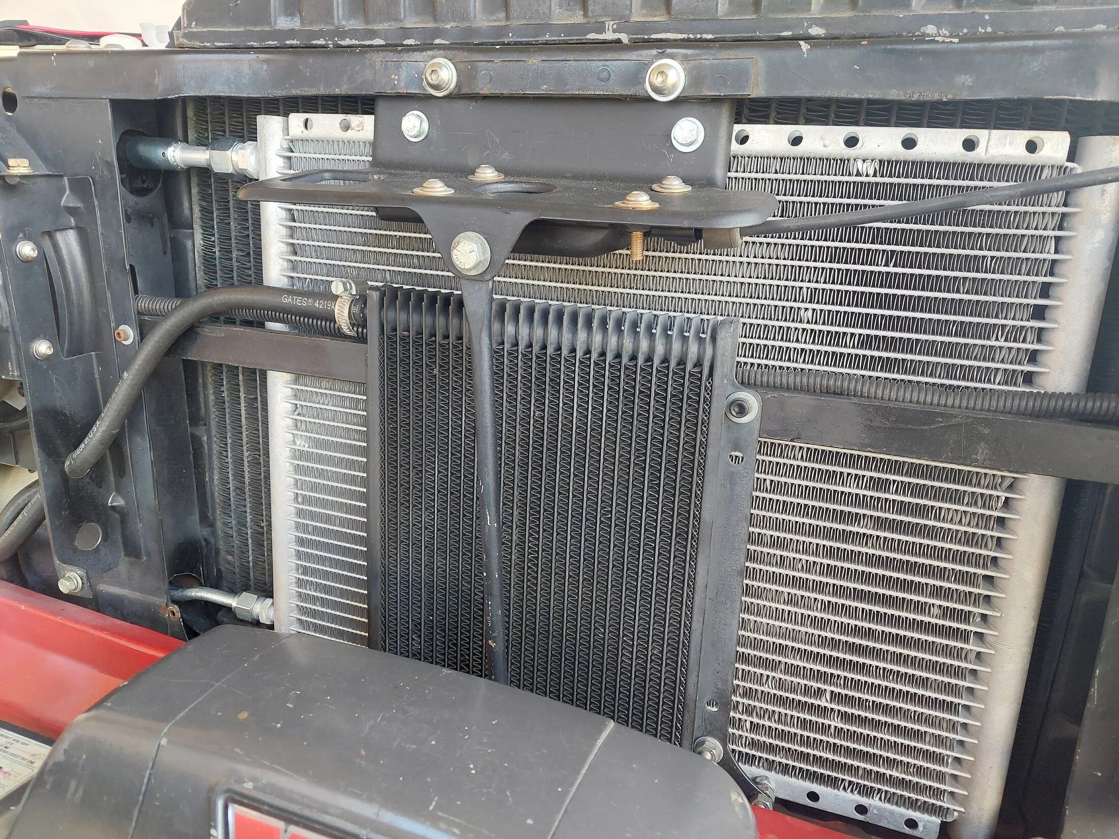

Unless you can clean the evaporator fins, I would make some kind of filter for that fan inlet.
Once the evaporator starts getting clogged it will just become less and less efficient.
What condensor are you running?
Classic auto Air ( Street Rod Cooler III ) with Vintage Air hardware , Will keep eye on the fan , I just might get to use my Rubiee (Rubicon ) Tube
