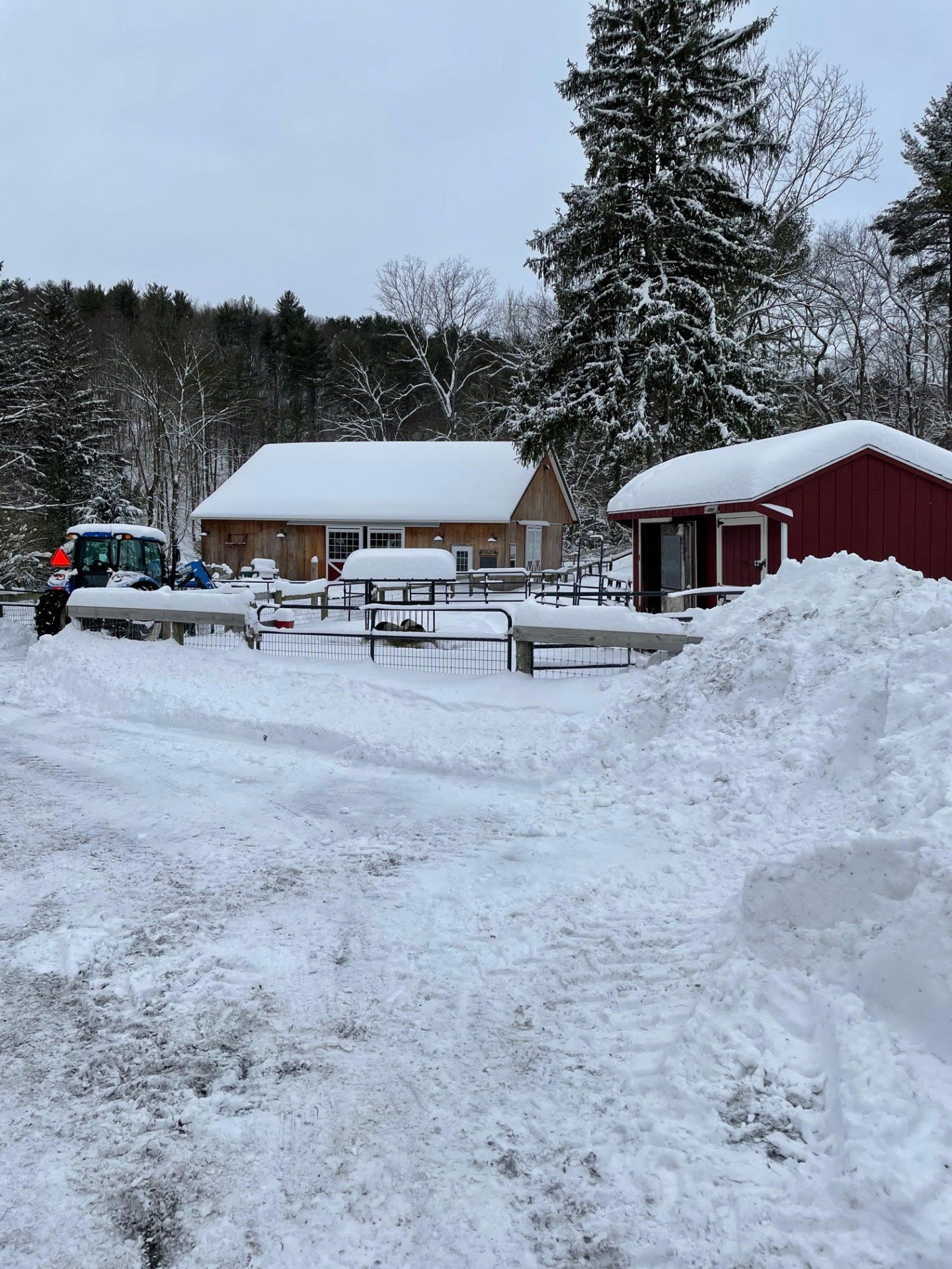

Snow in the northeast is beautiful but does hamper PIG progress at some level. A few pics to highlight.
Somewhere in the middle are two goats!

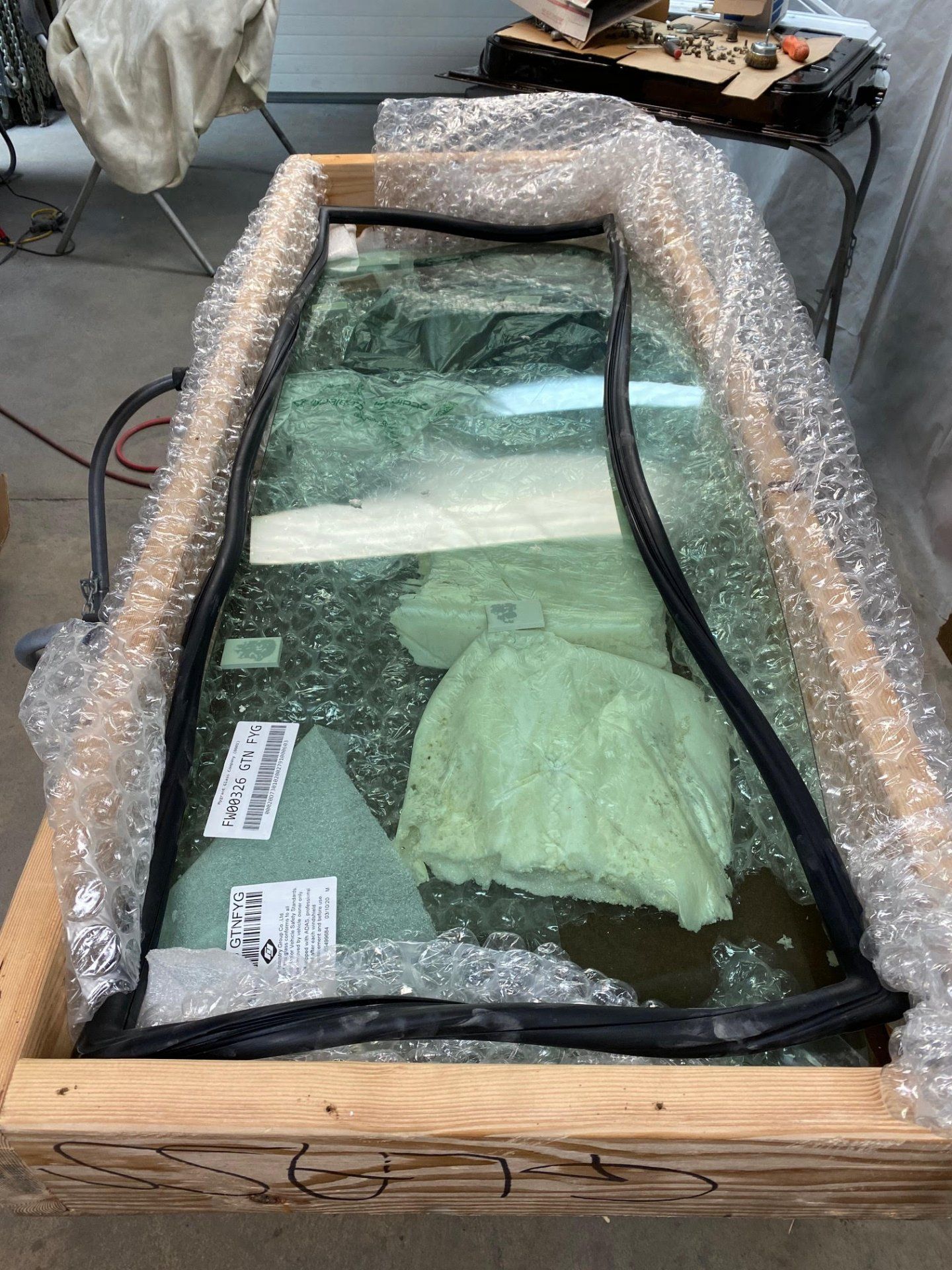

Broke out the inventory to see what we have in rubber? Missed the SLOCRUISER combo packs. Another case of if you see it, get it. Waited too long. Did pick some of his individual pieces along with parts from other suppliers. I think we have everything other than the rear fixed window gaskets. As I mentioned earlier I did buy some fixed window gaskets from Steele Rubber and hope they'll work with some modifications. It's expensive but we do have a plan. Update on that to follow later.
Although it sounds like seam sealer may have been used originally, an option for body panels bolted together is to use fender welting.
It acts as a gasket between the two panels - preventing penetration of water as well as allowing the panels to move somewhat without wearing away the paint.
Here's a picture of the fender welting on a VW Beetle fender for reference (the black "bead"). From the above link, the flat part goes down between the body panels and all you see the the "bead" at the end.
