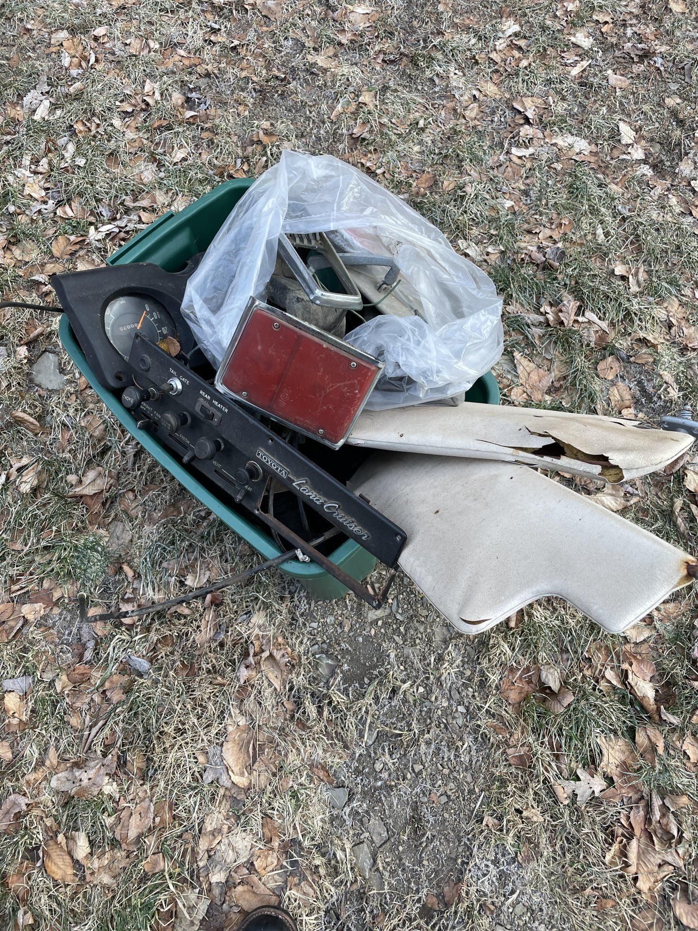

My good friend Gary @shmukster was parting out this 76 PIG. He wanted the drivetrain. Of course the body is totally gone. I tried to take everything and anything that was left. Thanks Gary.

Back to my place. Placed in storage for future inventory.
Nice salvage, tip on storing doors...roll the windies down, my dad just popped one on his spare :frown:
