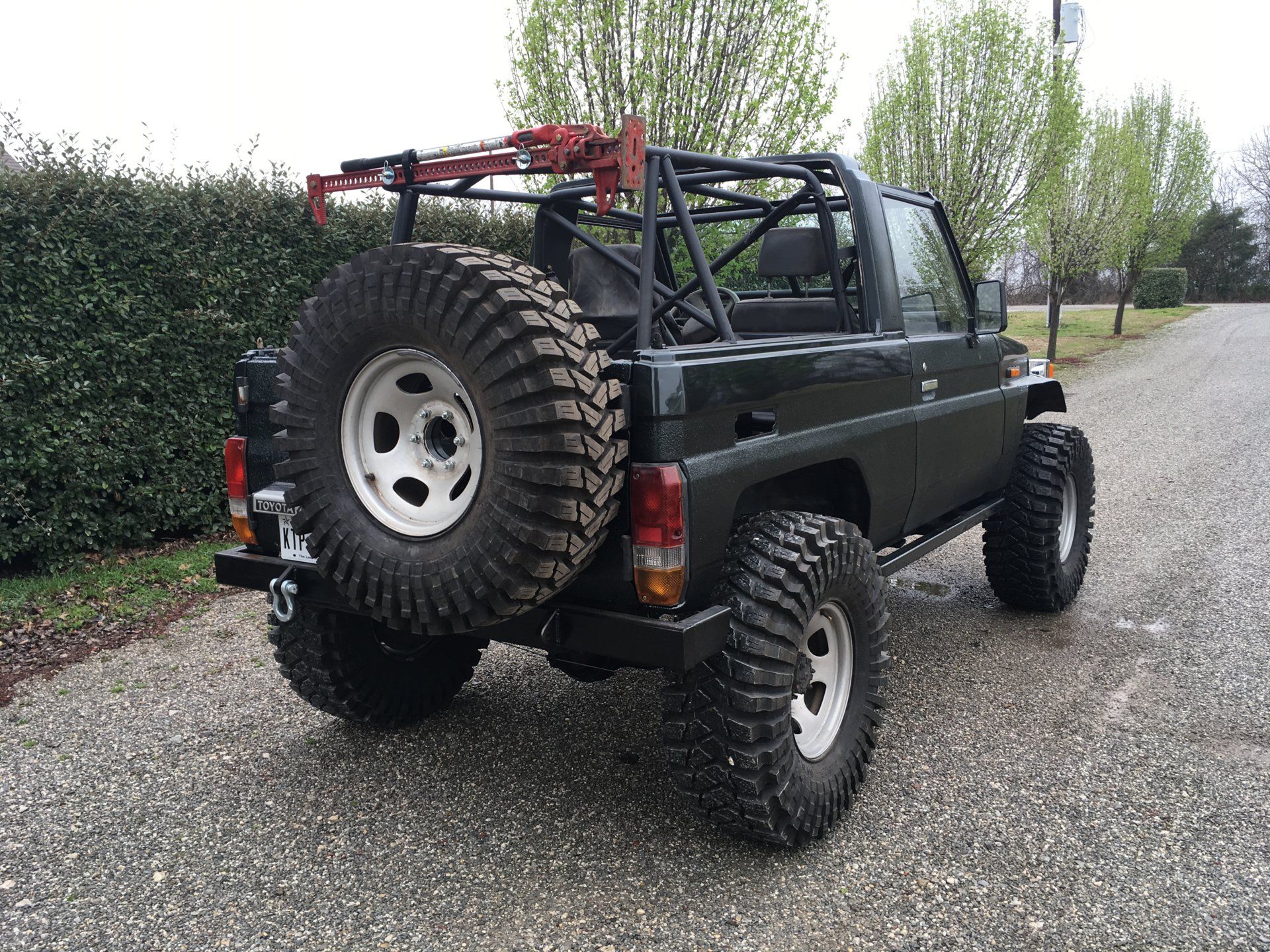

Getting closer ☺️
1925881
1925882

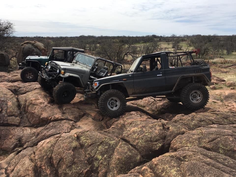

Update after a weekend of wheeling at Roundup.The stock ps pump on a 1HZ is sufficient to move the redneck ram, I had to tighten the link with the Ram on it twice untill it finally stayed in place, I might tackweld those adjuster nuts to the link. It exceeded expectations and we had a blast wheeling all weekend , the front cable locker conversion works flawless with the T handlesfrom Chilkat but I had to disconnect the rear and jack the axle up and engage the locker manually, I might need to go to their old system with the big lever as it seems this one needs more persuading then the small T handle can provide.
Plenty of small thinghs I want to change or add but right now it’s back to bussiness and I probably start on it again the week before the next event wich will be the Toyota Jamboree in May ;-)

View attachment 1931945View attachment 1931946View attachment 1931947

Looks like you had a good time, and I like that you not afraid to use it. I see the dent in the upper rear drivers quarter. I was hoping for some feedback on the link suspension, was also curious about the hydro asst. Any stalling at idle if you turn the wheel fast ?

The 1HDT idles a but higher then a 1HZ and I had no issues stalling it untill I tried to drop the rpms when idling to low at one point. Suspension did great but in blasting in 2 wd high on some very bumpy sandy road flat out gave me a bit of a scare , when the cruiser brakes out in the rear the suspension make it drop bad at that side and countersteering with the slower hydro assist will take some time to get used to that. Axles has 5.29 gears in them and transfer case has the 4:1 reduction gears.
