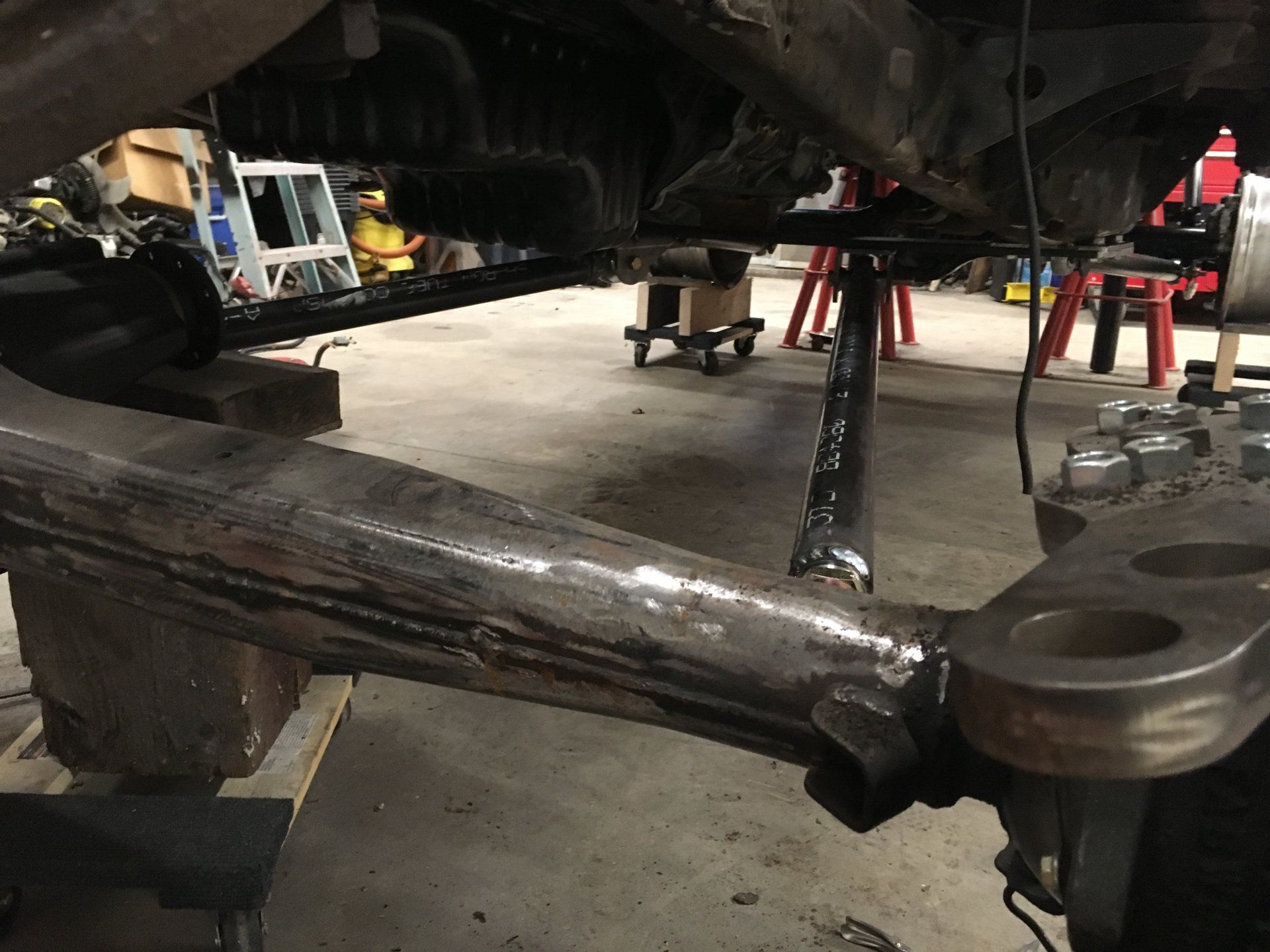

After a month or so with no possibility to work on this I finally had the chance to get a full days work on it done. The front suspension seems way more challenging then the rear. I moved the axle about 4.5” forward and am thinking of using an 80 series steering box with the forward facing pitman arm vs the oem reverse 7x box.

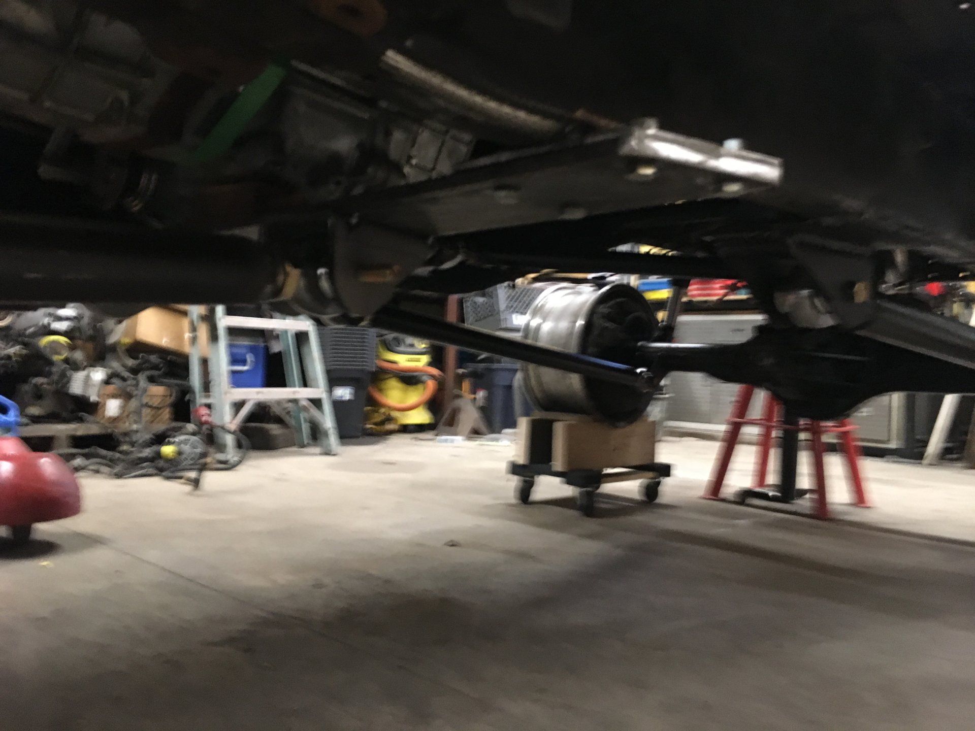

I also figured it might be a good idea to make a new crossmember for the transmission that also holds the brackets for the lower and upper link.
I know that is a thick bracket but it will bend and warp if you wheel it hard. There is a lot of force on those lower links.
Yeah I know but once all the links are on I will try to brace it as good as possible.

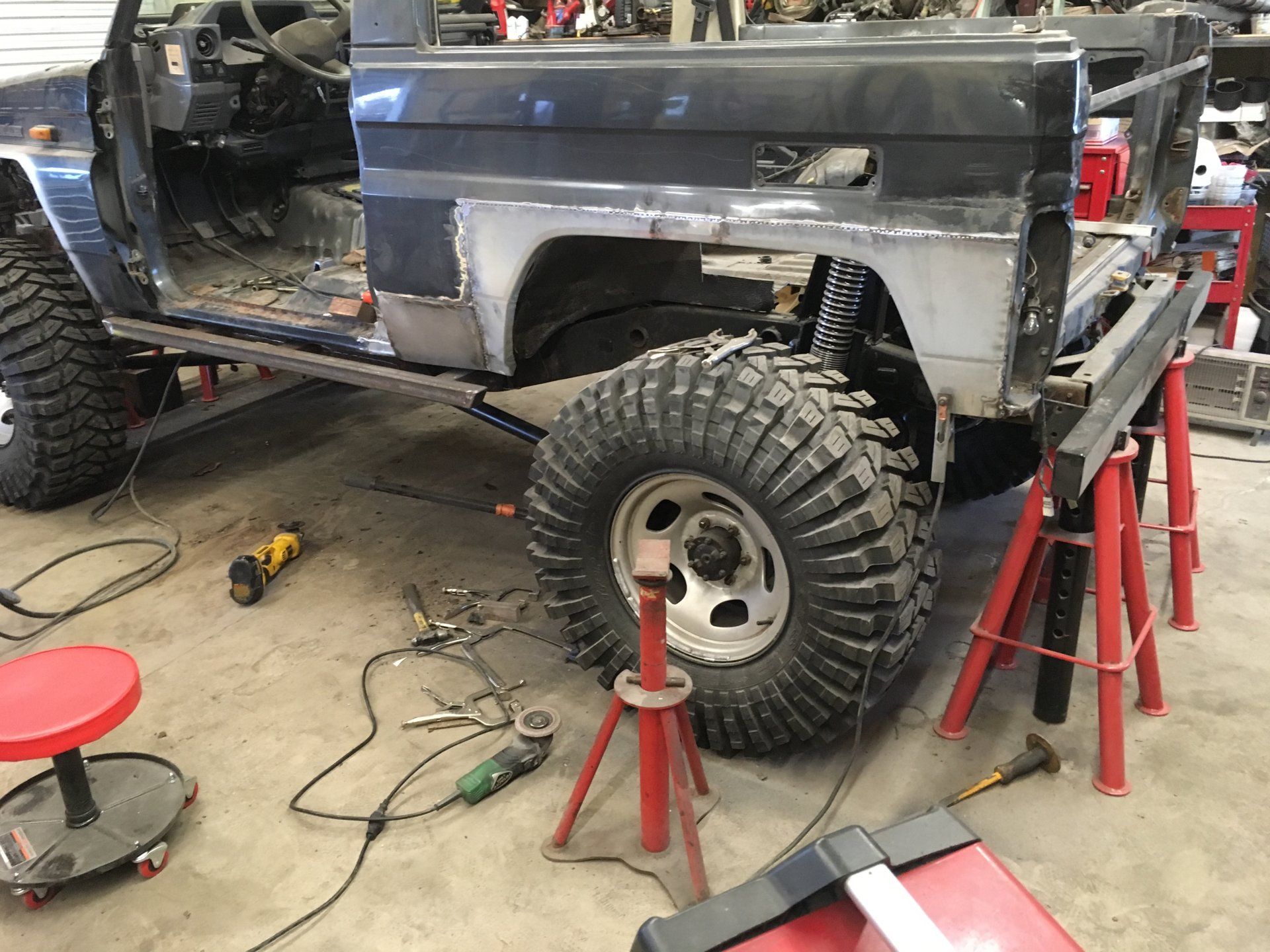

Front and rear suspension are done , I decided on using a HDJ80 steering gearbox that after fitting I sent off to West Texas Offroad for rebuild and tap for one of their Redneck rams. I started on the sliders also and will connect the center hoop of the future roll cage in to them. Also started to put back some sheetmetal on the rear wheel well , not gonna be pretty but better then just have everything cut out off it.
Put the rear quarter panels in it , I made the opening for the wheelwell about 4 inches wider and around 2 inches higher up in the body. Also got some work done on the inner fenders and picked up the tubing for the rollcage.

So with the Cruiser Roundup event being less then 10 days away I figured it was high time I got back to this one. The last 3 weeks have been crazy here with the arrival of a container paired with the usual hassle and small problems there has nothing been done to this since last time I posted. I had some new doors placed at the shop and the 73 was in the way so I needed to move it and it got finally on the lift .
The West Texas rebuild steering box came in with the Ram so I decided to tackle that today , I hope it all lears everything as I had no way to flex the suspension on the lift .
